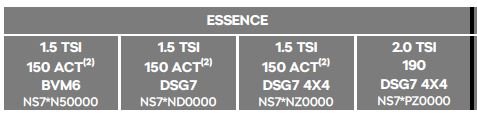

Perhaps not identical, but there are plenty of 1.5 TSI owners with the DSG gearbox that have what they claim to be very similar symptoms...
