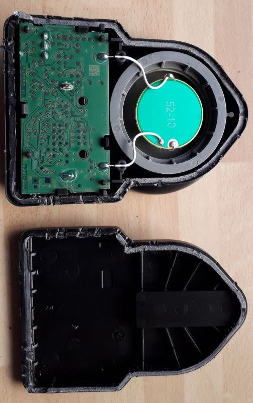

Once out the siren is a simple plastic block in 2 parts glued/ sealed together. With some effort you can prise the two halves apart. That done, you’ll see the PCB at the bottom, rear facing. Very carefully, prise this out by pulling back the clips around its edge. It will be stiff – because the battery is tightly held in plastic splines beneath that you don’t see until it comes free.

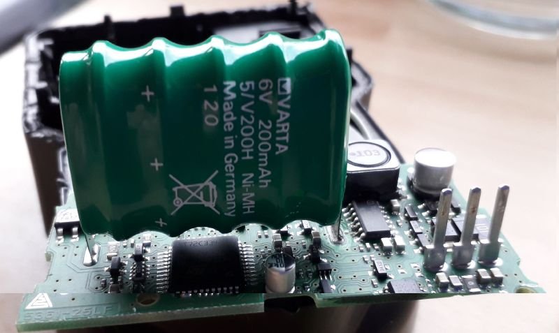

The battery is a multi-cell purpose made PCB one with a solder tag at either end. They are no longer made. The nearest virtual equivalent I found was this:
https://cpc.farnell.com/varta/55615305060/battery-nimh-5cell-6v-150mah/dp/BT05127#
Slightly different but  good enough for the fix, unsolder the old and solder in the new and reassemble (with a little modification as the battery compartment is designed for the original battery; so cut the splines to get a fit... Use clear silicone around your glued seal to weatherproof it. Refit and all’s well again.

Once you have opened up the alarm siren unit, you will be able to see which battery you can use, I think, that without checking that CPC link, that you can buy a couple of batteries and repackage them together to be the same as what is fitted, just by using glue and/or insulating tape and maybe adding a short wire link or links - that was the way things seemed to be the last time I out of curiosity, looked into this.
