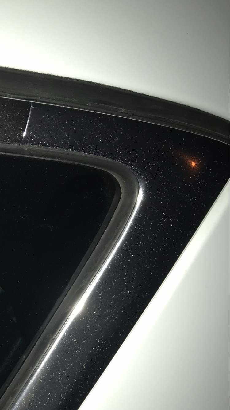

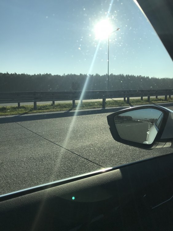

Picked up my new Superb and during first ride in sunny weather noticed glitter on the windshield.
it occured its pitted. Same with headlights, side windows, sunroof and chromes. Quite devastating experience. Notified dealer as soon as I noticed that (3 days after pickup). They state its manufacturers fault and that when car waited for WLTP they must have damaged it or during mfg process.
wondering if anyone who picked up his Skoda lately noticed similar damage on car?
I’m heavily disappointed as I did not expect something like that in a new car. Pictures dont show it fully but when driving towards sunlight it’s really disturbing.
At first they thought it’s some debris from trees but after that checked it thoroughly and realized these are microdamages. Wondering if it’s even possible to polish pits or they will need to replace everything?

Looks like fallout of some kind.   I can't see how a manufacturing defect would exist on plastic trim, sunroof and glass as they will be made in different factories.  It looks like the car, once manufactured was exposed to whatever it is.
A good detail and and application or iron fallout remover, a citrus based cleaner and then claying the car should sort it. (I would hope!)

Personally I’d take the car to the dealer and demand they sort it. It obviously hasn’t been prepared.  Cars can sit around for a while, once they’ve left the factory, and are exposed to all kind of organic/metallic fallout.  Cars are often transported by train too so lots of airborne metallic filings.
It looks more like tree sap on your car though. Which easily ‘bakes on’. A strong citrus based bug/tar remover will remove the majority of it.

they checked it under microscope and these are holes in glass, not dirt
Edited by JamesEnfield
Reject the car. It requires a factory rebuild imo. You cannot clay out holes in glass, lacquer etc. The danger is they could make paintwork, plastic etc look better by claying, this would be only temporary if the surface is damaged and pitted.

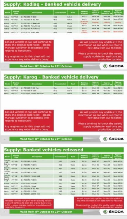

'Banked' cars might well have these type of issue.   A problem for the VW Group, VW, Skoda, SEAT and Audi.
  Do not accept damaged cars.
Cars parked at the same locations are going to have the same issues and VW Group will know that,
know what was where and for how long.
