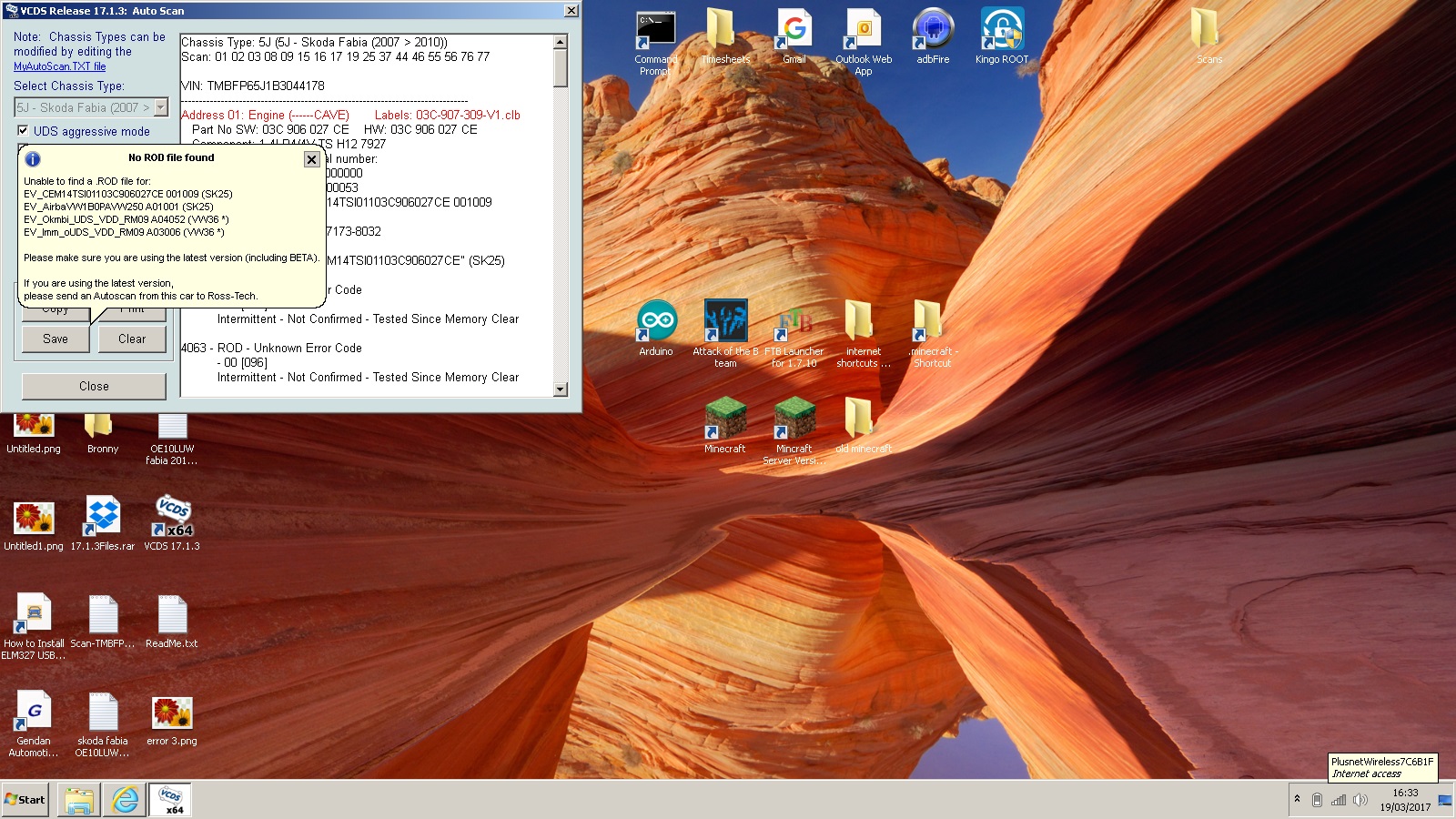

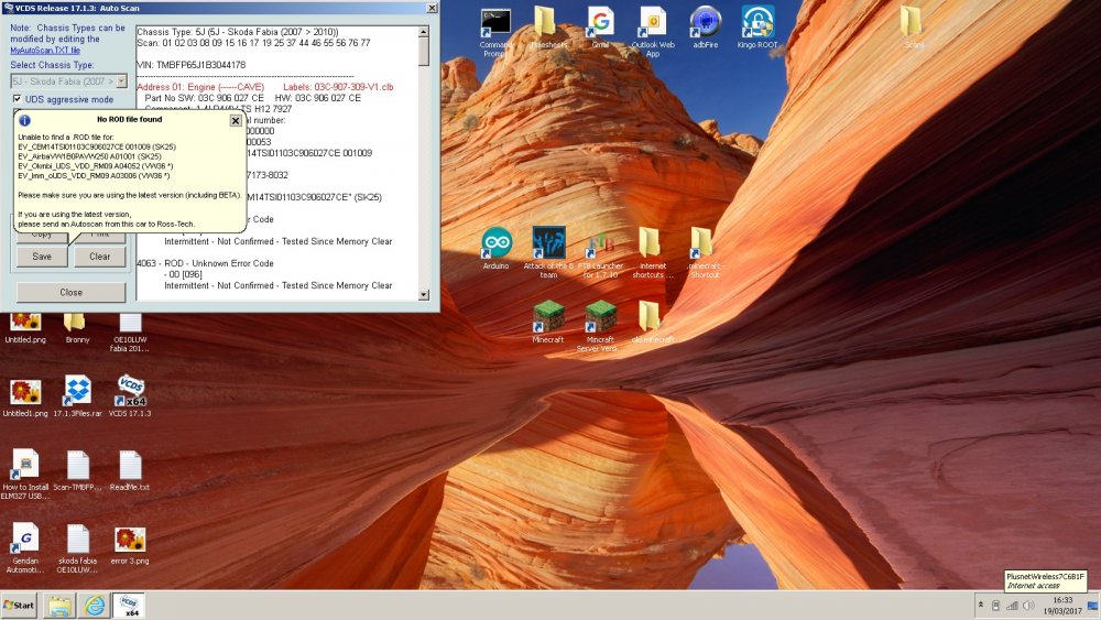

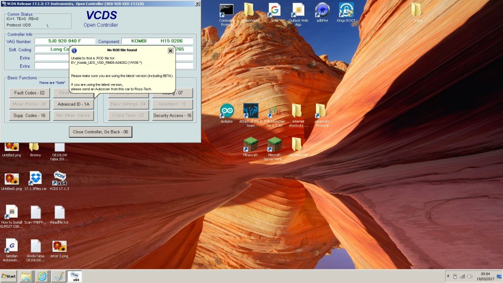

Hi Guys,
I'm having an issue with version 17.1.3, I want to change the country from GB to AUS so I can get the large MPH displayed in main window instead of KPH, when I go into the control module 17 - instruments, then 07 - coding , then long code helper - change it to AUS, exit and go to "DO IT", it states that it has coding accepted but when I look at the maxidot it still is at GB settings. if I go back into the modules again, sure enough it has stayed on GB... any ideas??? very frustrating... autoscan (manual) below. When I open module 17 it shows this pop up bubble with this file missing EV_KombiU_DS_VDD_RM09" (VW36 *). the >ROD file for my Skoda is there but it asks for a VW one??? is this possibly a version issue?
any help would be appreciated.
Thanks.
The Train Driver.
Sunday,19,March,2017,16:41:11:27677
VCDS -- Windows Based VAG/VAS Emulator Running on Windows 7 x64
VCDS Version: 17.1.3.0 (x64)
Data version: 20170203 DS267.2
VIN:    License Plate:
Mileage: 2   Repair Order: 2
Chassis Type: 5J (5J - Skoda Fabia (2007 > 2010))
Scan: 01 02 03 08 09 15 16 17 19 25 37 44 46 55 56 76 77
VIN:
Address 01: Engine (------CAVE)       Labels: 03C-907-309-V1.clb
   Part No SW: 03C 906 027 CE    HW: 03C 906 027 CE
   Component: 1.4l R4/4V TS H12 7927
   Revision: L2H12---    Serial number:
   Coding: 00250012000400000000
   Shop #: WSC 13765 031 00053
   ASAM Dataset: EV_ECM14STI01103C906027CE 001009
   ROD: N/A
   VCID: 66C47ABA990BD07173-8032
No ASAM data for: "EV_ECM14STI01103C906027CE" (SK25)
4 Faults Found
4054 - ROD - Unknown Error Code
          - 00 [096]
          Intermittent - Not Confirmed - Tested Since Memory Clear
4063 - ROD - Unknown Error Code
          - 00 [096]
7960 - ROD - Unknown Error Code
          - 00 [032]
4051 - ROD - Unknown Error Code
          - 00 [096]
Readiness: 0000 0000

No fault code found.
Address 17: Instruments (J285)       Labels: 5K0-920-xxx-17.clb
   Part No SW: 5J0 920 940 F    HW: 5J0 920 940 F
   Component: KOMBI         H15 0206
   Serial number: 00000000000000
   Coding: 410A00
   Shop #: WSC 13765 031 00043
   ASAM Dataset: EV_KombiU_DS_VDD_RM09 A04052
   ROD: N/A
   VCID: 2D56C5967C7D232972-8078
No ASAM data for: "EV_KombiU_DS_VDD_RM09" (VW36 *)
Have you also done the maxidot changes? (post 1)
Just noticed yours is a 2010, does this have the white maxidot? if not then it will not work.
Edited by Gizmo68
Also, is it a genuine unit?
Hi Gizmo,
yes, that's how I know it hasn't written to the module... when I check the settings, its still on GB, and in the MFD the Digit.speed tick box is not there :-(
yes, white maxidot fitted :-)
Edited by thetraindriver01
more content added
Hi Badger,
Yes, all cables and software registered and licensed... control module is the original module with the car.
Sounds silly, turned it off and then back on? Also do you have multiple menus?
