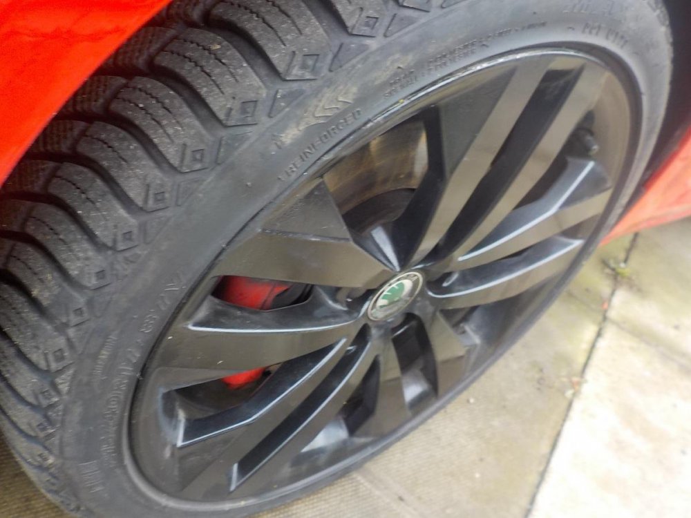

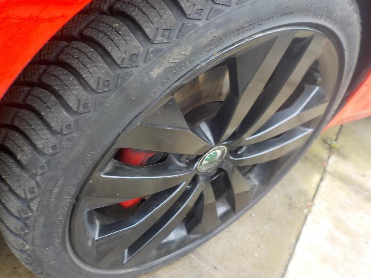

eg,
'Reinforced' winter tyres.
But that does not mean a pothole might not wreck them.
That is a bulge just beside 'reinforced'.
