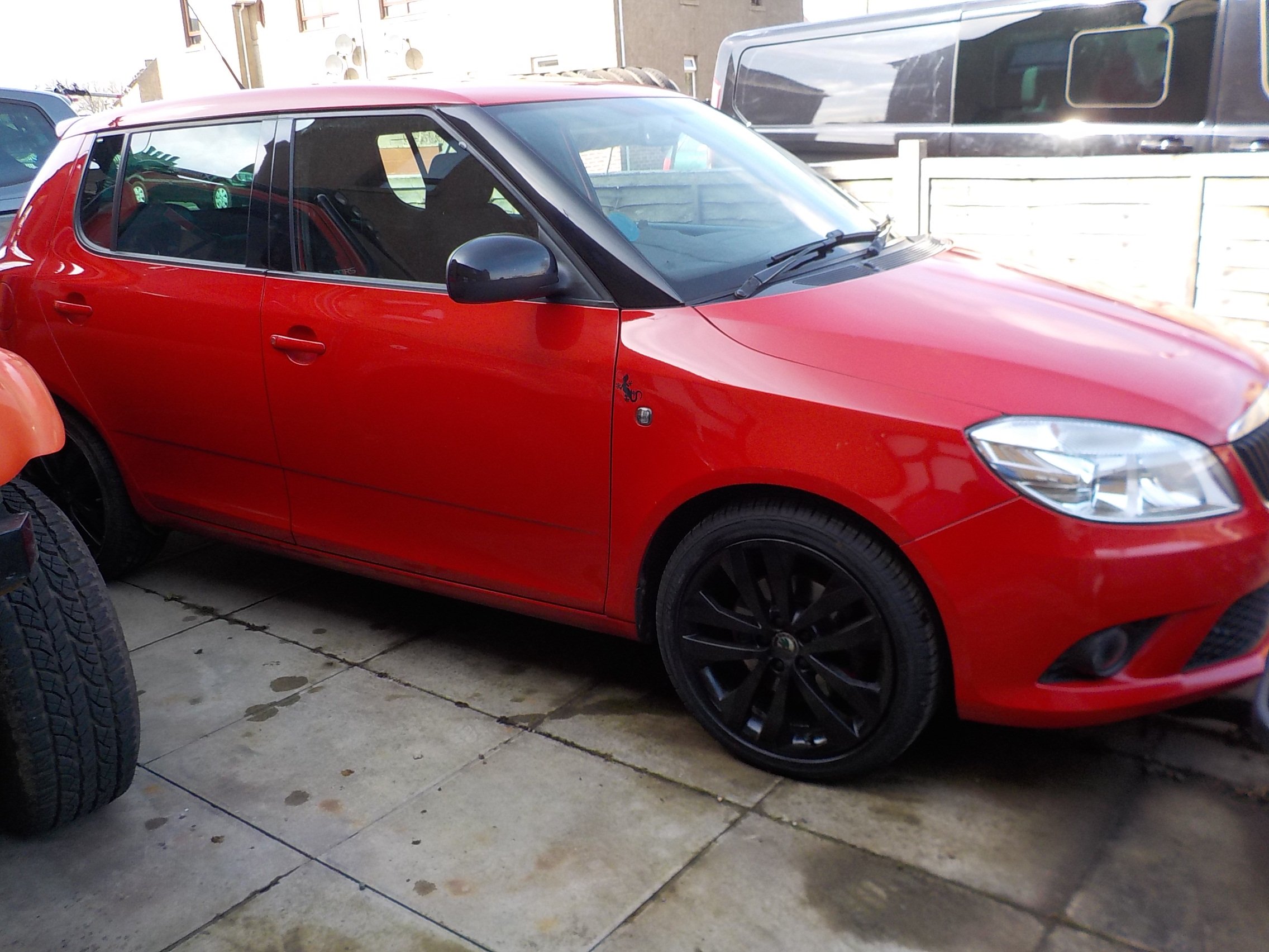

I'd imagine 215's will fit as long you ain't lowered a serious amount, I run 205/45's for the extra comfort (not that it makes much difference)
215 /40 is fine better grip, run them all the time car is lowered as well

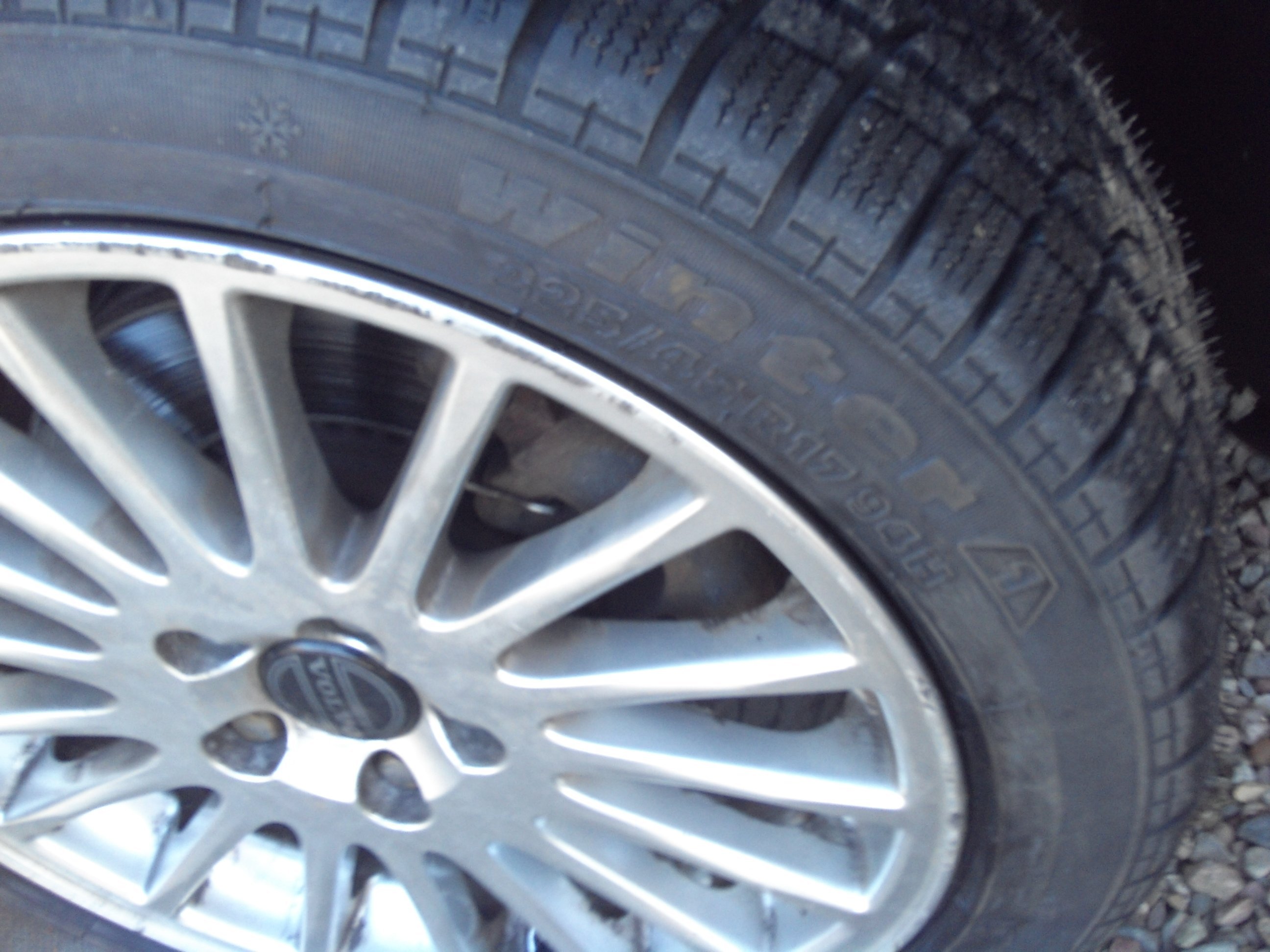

These are 215/40 R 17 Winters on standard height suspension.
DSCN1996.JPG.a27fed23698026d394432f6add44e7ed.JPG.481627c96978eb7f58c0f13196efcee9.JPG
On the Gigaro's these Tigar & Goodride tyres are 215/40 R 17, & on the Volvo wheels are 215/45 R 17's.  Big difference in size.  But Pirelli Zero Nero 205/40 R 17 can measure bigger side by side than some 215/40 R 17 or 205/45 R 17's of different brands.
