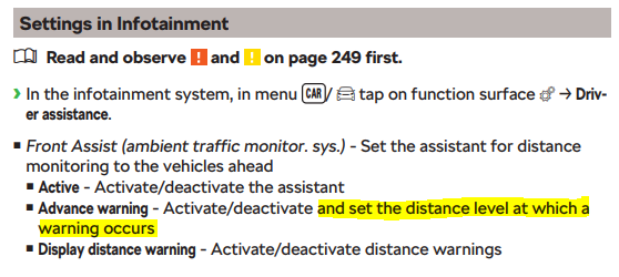

The sensitivity of Front Assist can be reduced via the infotainment system if you're getting repeated false alerts.

Update on the 'Little red devil' popping up too frequently problem, on the Skoda Kodiaq's Front Assist Infotainment function. I just changed the 'Advance Warning' function from close to medium and drove past a frequent trigger point: it didn't trigger the red devil or auto braking.

Yes, I think so @Mnisjohn, by adjusting the Front Assist setting in 'Advance Warning' from 'close' to 'medium', as others suggested on here. I know what you mean by "like driving with a nervous passenger" when the Little Red Devil suddenly appears on the screen!

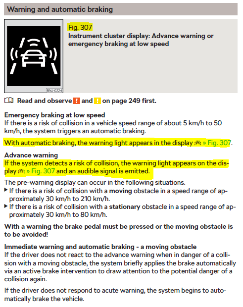

Are you sure you didn't get the red image above, before 'BRAKE' appeared on the screen and the car automatically applied the brakes?
The manual isn't great, but as I read it the car will only brake automatically if the driver either ignores the red symbol above, or ignores a red symbol followed by an audible warning...
It might be that the car didn’t give very long before it decided the driver was “ignoring” the symbol.
Certainly with ACC if it decides you need to take action it will brake automatically without giving very much warning at all if it thinks it needs to. A classic is when using it on an A road and the car in front  pulls off to turn right in a protected lane in the middle of the road. You’re not going to hit it because it’s pulled into a lane to the right of you, but unless you cancel ACC when you see them begin the manoeuvre, or override by pressing the throttle, the auto brake will kick in and try and stop you.
When that happens, in my experience the dashboard warnings and brake are very close together
I can't be sure as I was looking at the empty road ahead!
I had a 2018 Skoda Fabia courtesy car that applied the brakes automatically, but I'm pretty sure there was no advanced warning.
There should have been an audible 'bong' too, but again this is my attempt at trying to understand the manual, which Skoda UK don't make easy.

By adjusting the ACC, Front Assist setting in 'Advance Warning' distance, from 'close' to 'medium', has significantly decreased the frequency of this ghost signal (although a few weird ghost occurrences still occasionally occur), but I think (although not empirically measured),  the time gap between visual and sound warning has decreased since I reduced the ACC distance setting from 'close' to 'medium', i.e. giving the driver less time to respond (brake), before the audio signal sounded.

On the couple of times it’s happened to me the ‘bong’ came at the same time as the brakes being slammed on. Since I moved the settings to medium it seems to be more well behaved, though I haven’t been around the Heathrow perimeter road to test yet.
