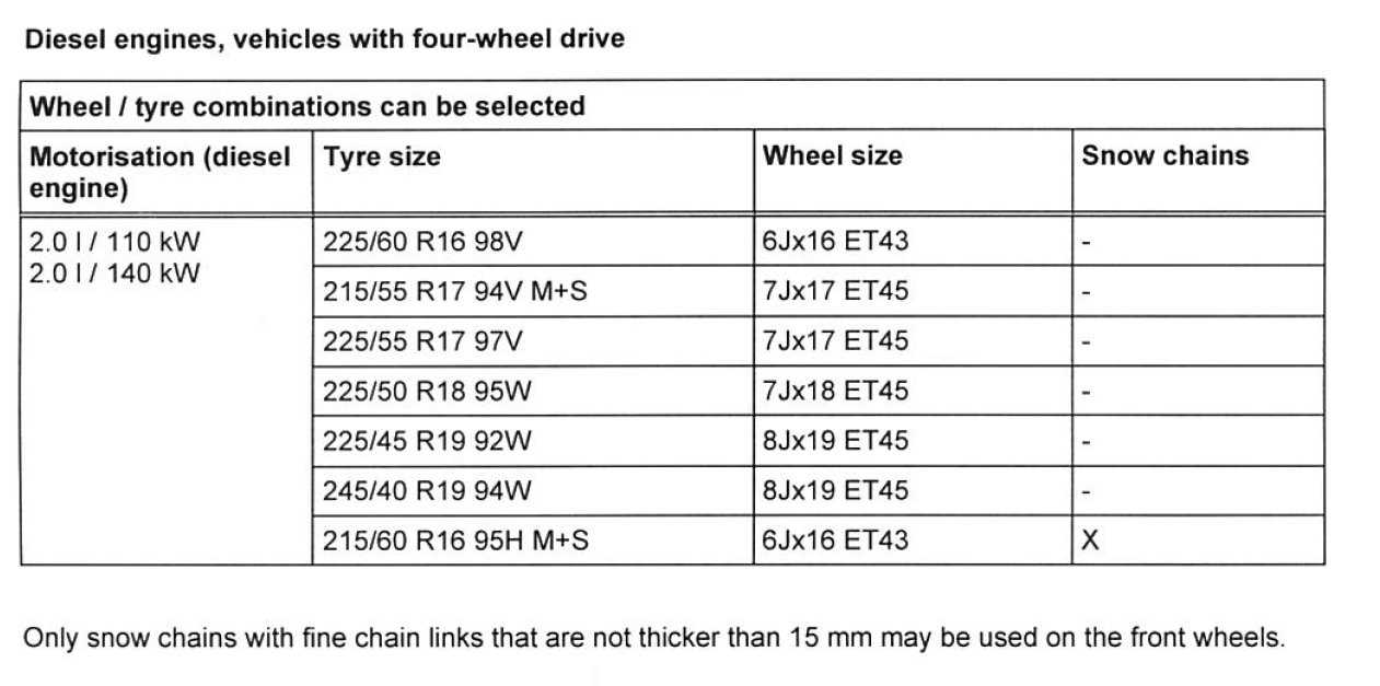

Goodyear or Bridgestone All Seasons are available in 225/50x18 which would fit and comply.
@Arkaig - not strictly true.
Whilst 225/50 R18 would fit, they are not an approved option for the 1.5TSi (DADA engine).
They are an approved option for the 2.0 TDi (DFFA engine).
Unless I’ve read the charts incorrectly!

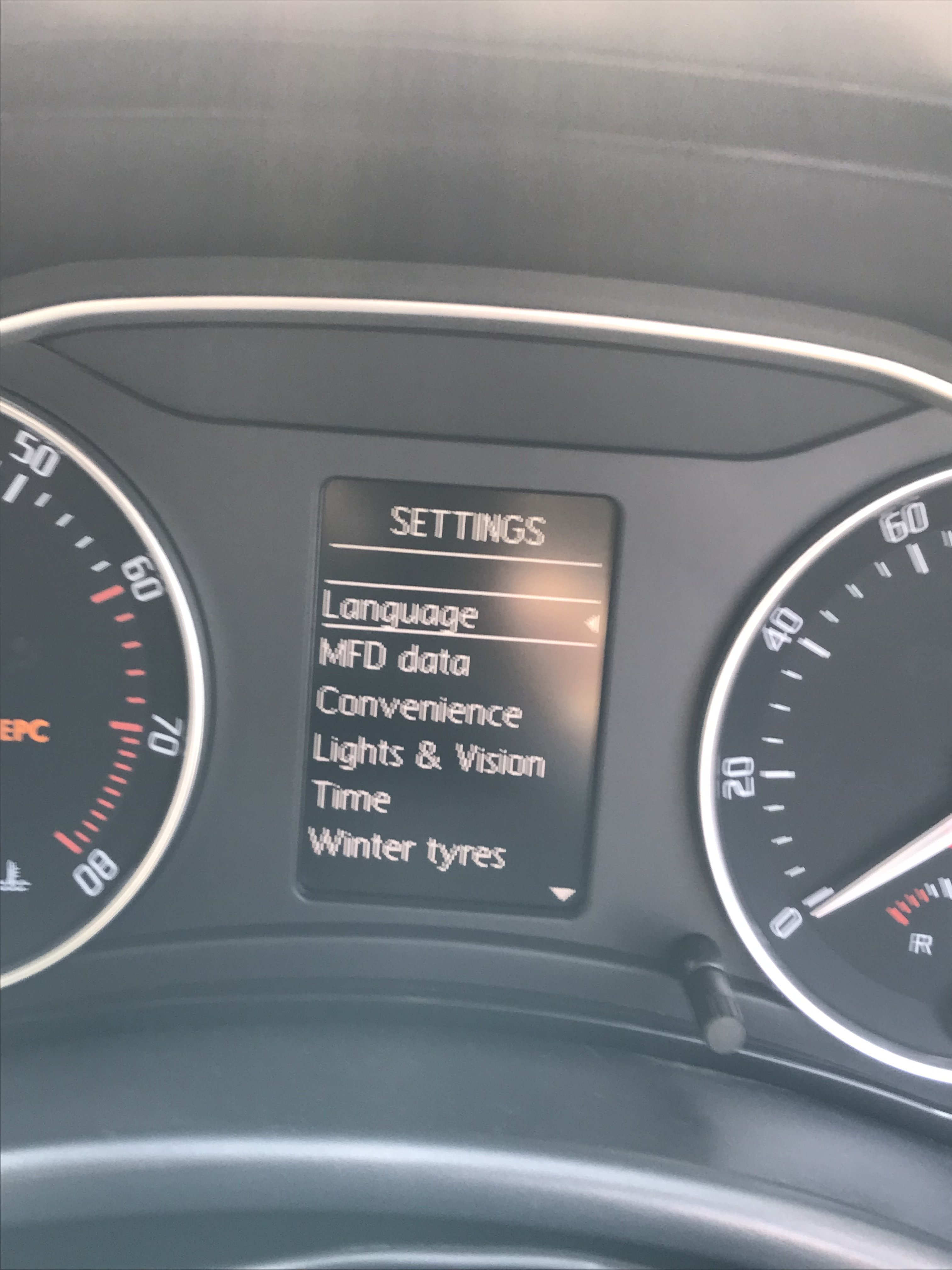

Isn't there a winter tyre speedo adjustment available on the Karoq? Even my last Mk2 Octavia had that.
Just been checking out 225/50 R18 All Season tyres as I was considering a 1.5TSi SEL 4x4.  Amazed Cross Climate+ are not available.
On my Yeti it was just a maximum speed warning (for certain winter tyres) it didn’t adjust the speedo.
Unless you had to input the wheel and tyre size the car would not know how much adjustment to make.

I'm sure I've seen a %age change facility. Maybe its on my current Mk3.
There is a 'change' to chose the 'Winter Tyre fitted speed warning speed you want',
 A legal requirement for some countries when Winter Tyres are Fitted, or a Warning Sticker needs displayed.

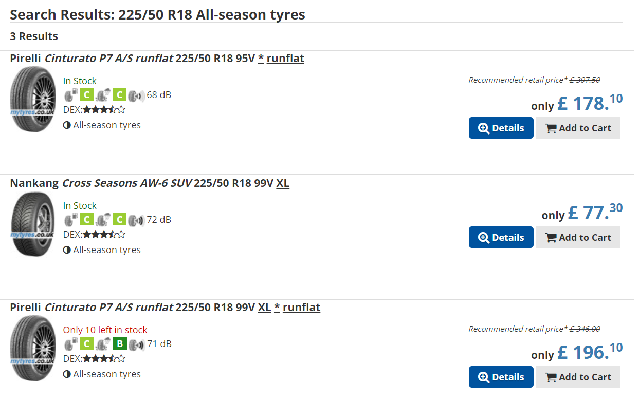

Not a great choice - but there is 2 run flat - and 1 normal All Season.. - This is My Tyres
image.thumb.png.c07ba7c1b33e369088bedd362f8751ff.pngN

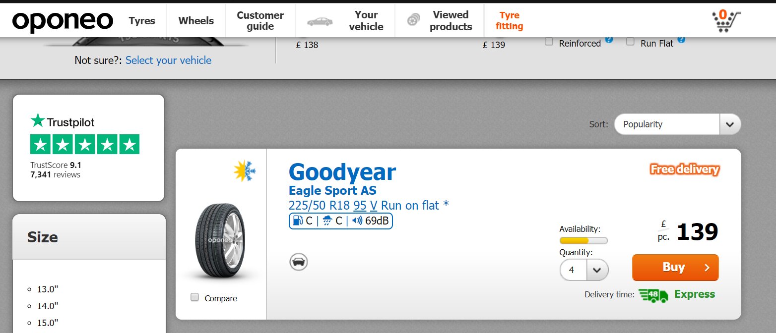

Just 1 Run Flat All Season with Oponeo..
But I do not see a problem changing to one width smaller as you suggest... but it  is not listed on the approved list for your car from manufacturer.... so i suggest you check with your insurance..
I bought the 215/55 R17 for my 2.0 TDI 4x4  for the winter wheel/tyre
image2019-04-09-160220.pdf
Hi Simon,
I do not need run-flats and would rather avoid the stiff sidewall these come with.... our lane is rough enough without hard tyres sending every jolt into the cabin.
The Nankangs may as well be called "ditchfinders", never will I put cheapo tyres on.
The Goodyear is also a run flat, but also is a BMW specific fit only.
thanks for your help, I've been searching for sometime and not come up with anything else either :-(
Can you post a link to the official tyre sizes from Skoda? Is that where you got the information?
Edited by Luckypants
The PDF attached came from Skoda - bottom of page shows the source..
