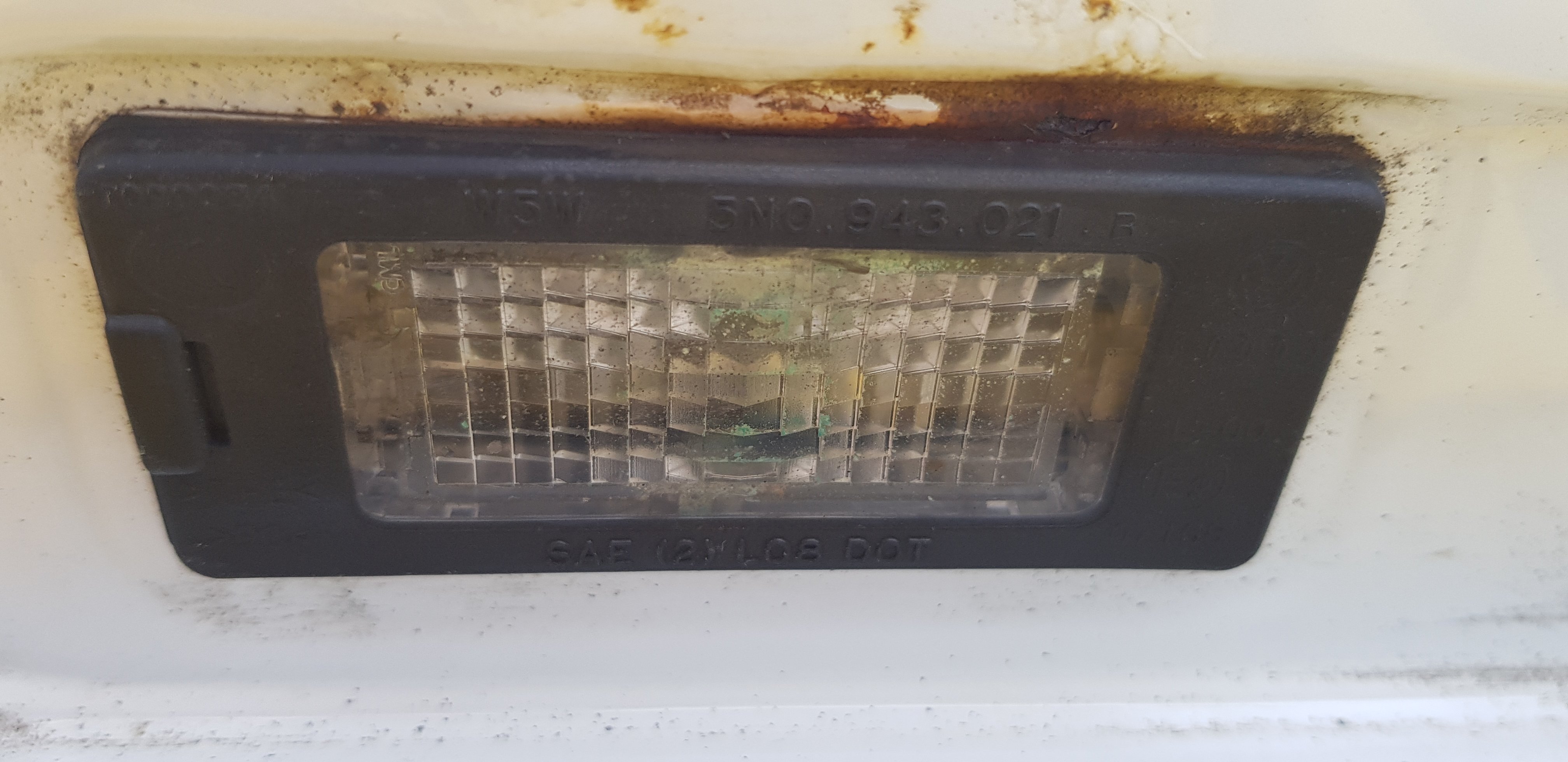

2015 superb tailgate rust
2015 superb elegance estate, high miles 116k miles but well looked after with full main dealer service history.
The car is dropping to bits! And skoda doesn't want to know .
I won't go Into the other faults as I can sort myself, however,  the are around one of the rear number plate lights is rusty beyond belief. I contacted skoda,  told to take to dealership for diagnosis.  They have advised skoda that  new tailgate is required.
Skoda have told the dealer that they cannot find evidence that the car has had any paint inspections so have refused the Claim! I'm livid , surely the inspections would have been done when car went in for service?? I've also been told that skoda are aware of this problem.

Looks exactly like my car did! My car was delivered to me December 2013 and I found the corrosion last winter when it was 5 years old.
If you remove the lamp you will find that the light fixture is extremely corroded. I even had to replace the end of the cable as the contact had corroded internally.
I'm no corrosion expert, but i believe that what we see here is galvanic corrosion - the light fixture got corroded and developed a high resistance to ground through the cable so the current took another way to ground - into the metal surrounding the light fixture.
On my car one side looked like the picture above - the other side was fine. Lamp fixture was in good shape and no corrosion around it.
I went to my local Skoda dealer and they sent photos to Skoda Sweden for evaluation. A couple of weeks later i got a message that Skoda Sweden would replace the tailgate without cost.
When I got my car back with the new tailgate, I changed the new light fixtures (with open backsides) that the garage had installed, to Skoda original LED lights, which are sealed. Hopefully this will prevent corrosion of the new tailgate.
As this seems to be a design flaw, I hope you can convince Skoda UK to replace the tailgate.

LHD Superb MK2 from year 2010. My tailgate had rust behind the license plate (rubbed through the paint in the middle) and the left bottom corner where the tailgate touched the rear bumper.
I had my tailgate repainted (payed for by myself). Between my tailgate and the light fixture my Skoda had a piece of protective plastic (thick, clear self adhesive plastic). Replaced it when putting all parts back again, ordered these plastic parts from the dealer.
Conclusion: Skoda knows about the rust problem / potential, as they have taken this up in their design. I don't understand why our 2015 model did not have this extra protection. It does have an other design tailgate, so maybe they forgot the extra protection.
I did not find any rust at the light fixture openings.

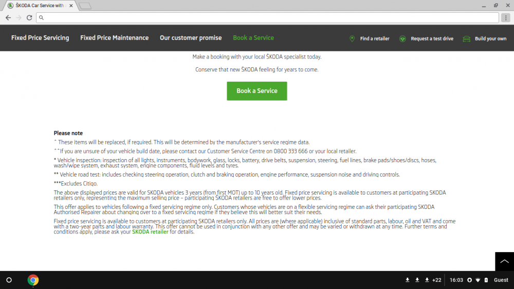

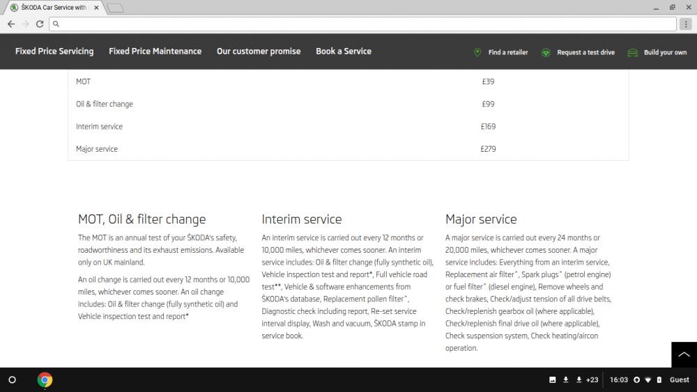

Bottom of page. 'vehicle inspection'.
http://skoda.co.uk/owners/servicing-maintenance-fixed-price
*When there was 'Fixed Servicing' and a Service Book, there were Minor & Major Servicing, or Inspection & Major Services.
the Body Inspection was done every 2 years supposedly, the page with the 'Inspection report' was after every Service', you marked any damage etc, repairs on these pages'.*
Then they went to a Palm Held device.
This nonsense has been going on for years now and SKODA UK are taking the Pith.  The Dealerships are approved by them, Skoda did away with the Service Books with the pages after the service pages for the Body Condition reports.
It all went 'On the system',
