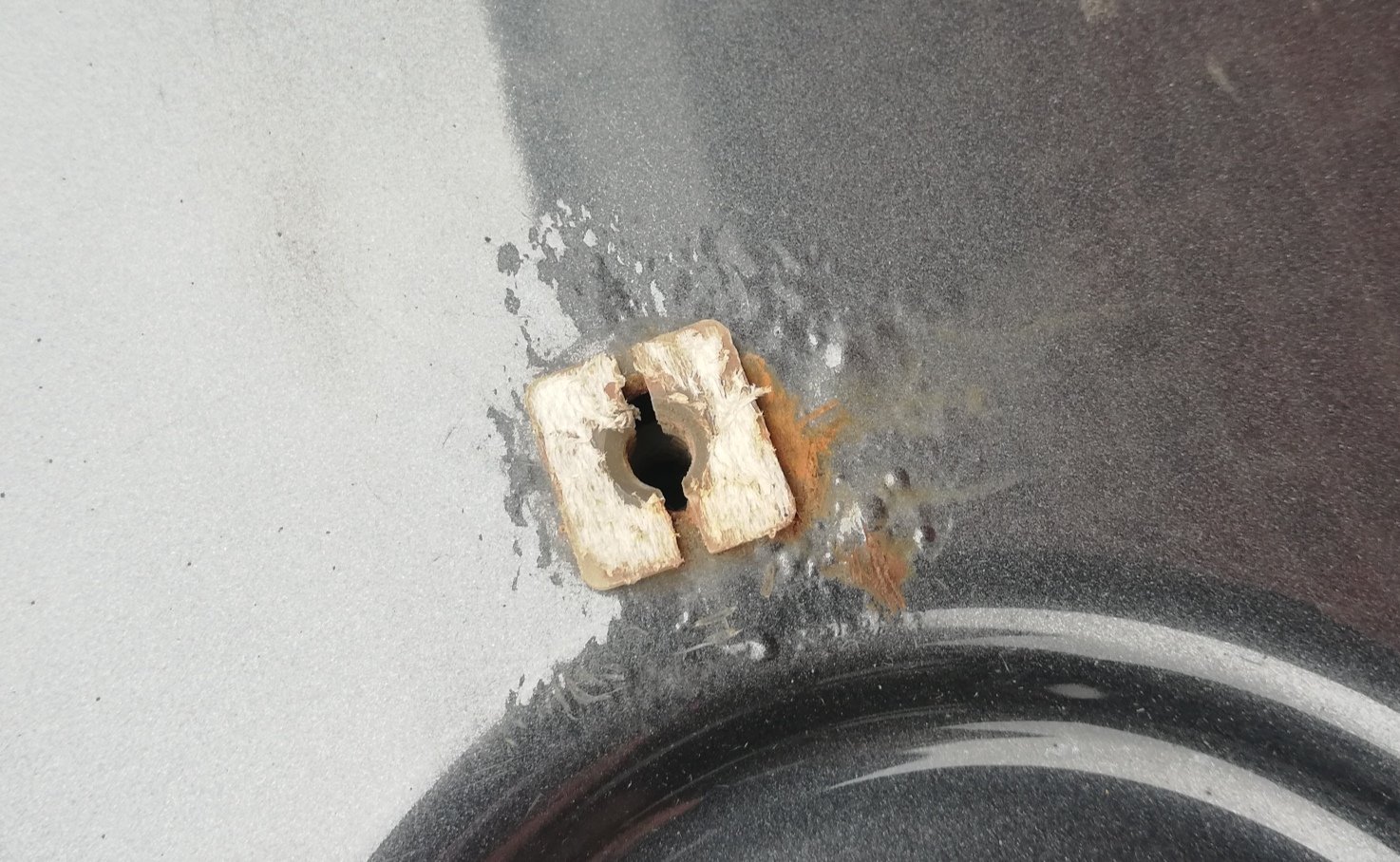

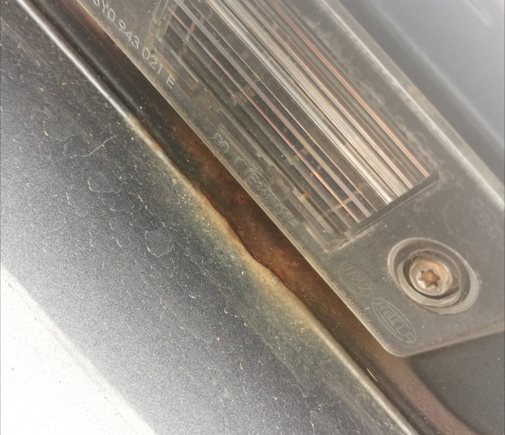

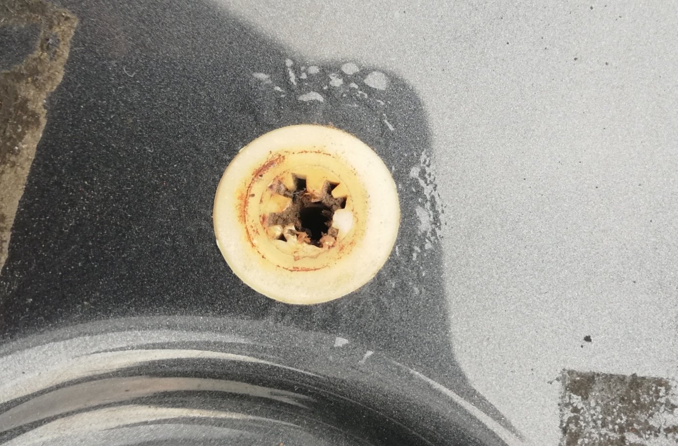

Hello. I have just found rust around the rear number plate lights on my recently aquired 2010 fabia estate. I thought this was shocking on a relatively new car, but see from the forum I am not the only one with this problem. Do Skoda acknowledge this and put it right?

Known issue, especially around rear numberplate lights as Skoda used foam gaskets instead of rubber. Read this:

The difference between the mk1 & mk2 metal thickness is considerable. looking at my mk2 estate tailgate today whilst sorting the wiper motor I saw rust in the usual places (around the number-plate lights & lock handle). Note this is with the tailgate card removed. Not really much I can do except get the blow-torch out, warm & dry the area & cover the area with grease plus the WD 40 can to spray into the cracks from the inside. Too cold for waxoil but that's planned for summertime.
I had the same problem of corrosion around the number plate lights on my 2008 Fabia 1.9Tdi estsate last year.After being inspected at D.M.Keith, Hull a new tailgate was fitted under the 10 year paint/corrosion warranty.

When I first found the rust around the number plate lights on my estate I was very alarmed and it being the middle of winter I wanted to try to stop it getting worse.This was before I realised there was a ten year warranty against corrosion. So I scraped of the loose rust andbrushed on some smooth black Hammerite. (Car is also black). Briefly, after this I then found out about the warranty and went to my dealership. They weren't aware of any such corrosion problem, hahaha. Was eventually referred to their body shop 30 miles away. They were very helpful and checked the car all over to ensure it hadn't been resprayed in the past. Told them about the Hammerite and said I was quite happy to scrape it all off. They said not to bother and reported back to the dealership. These miserable ******s were determined to follow the company line and said the paint I put on invalidated the warranty. Thats the end of the story. I have since made a more permanent job with the hammerite and it remains fine. The issue in my case is the foam rubber gaskets they fit under the number plate lights that soak up water and never dry out. Desighn error.

Im told they replaced the screwed in type lights for plastic ones to stop this
