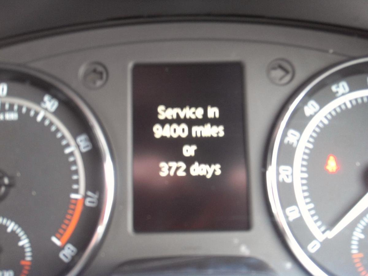

Luckily the likes of a Mk2 Fabia vRS is easy to reset when on Fixed Servicing.  just do the reset to another 372 days / 9,400 miles as Oil Changes are done etc.
