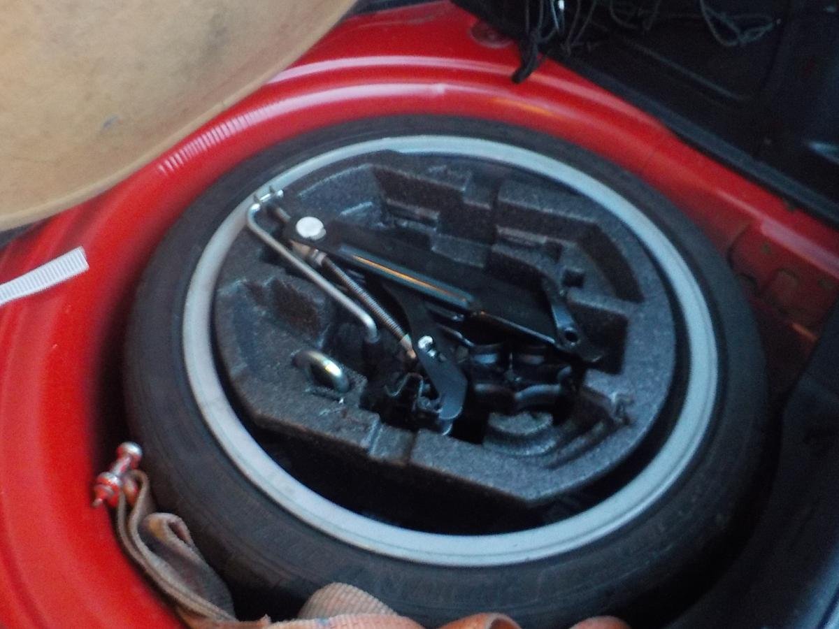

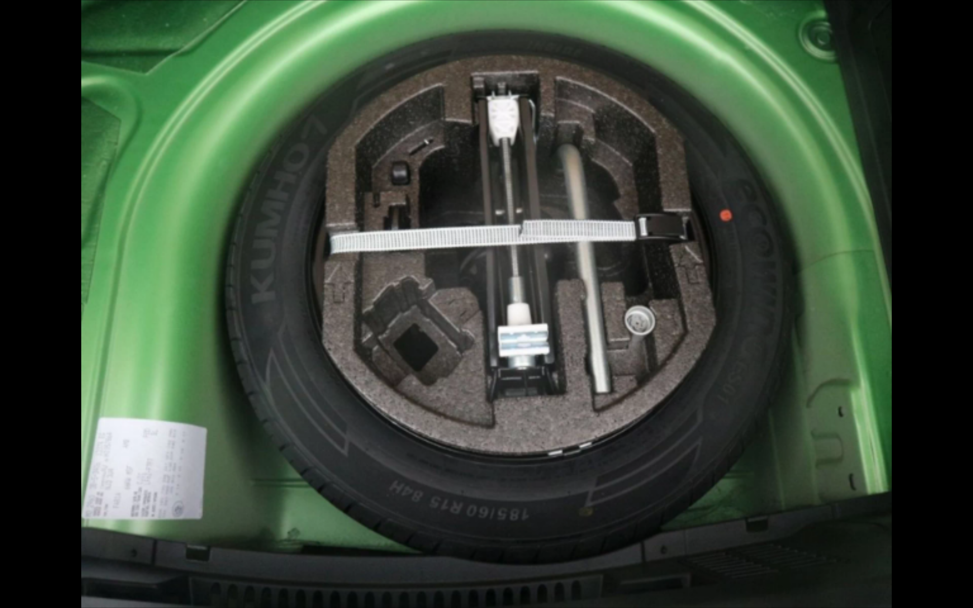

does the mark 2 fit a full size wheel in or do you need a space saver?
A full size Steel or Alloy up to 205/40 R 17 or even 215/40 R 17 fits in the Spare Tyre Well.
A wheel / tyre that matches the 4 on the car will go in the spare tyre well.
The Spare wheel that Skoda use as OEM sometimes & offer as an option is fitted with a 195/55 R 15 tyre.  or 185/60 R 15.
 So saves space but is not a 'Space Saver.'
