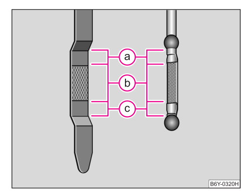

When I check the oil level when cold, it's in the "c" range, which would indicate that I should add some oil. After running the engine some time, due to thermal expansion, the oil gets into range "b", but I'd say lower half of "b". I always thought that oil you check on a level surface when cold. However, the manual says that on vehicles with the 1.2l/47kW engines oil should be checked when warm. I do have a 1.2l engine, but it is 51kW.

This is another with the 'cold' 1.2 44kw  & the 'warm'.  This was posted years back when Mk2 vRS were using oil and Techs were underfilling and over filling engines at Servicing.
Skoda UK told me they would update Owners Manuals and correct the instructions to the same as the Polo & Ibiza Manuals.
