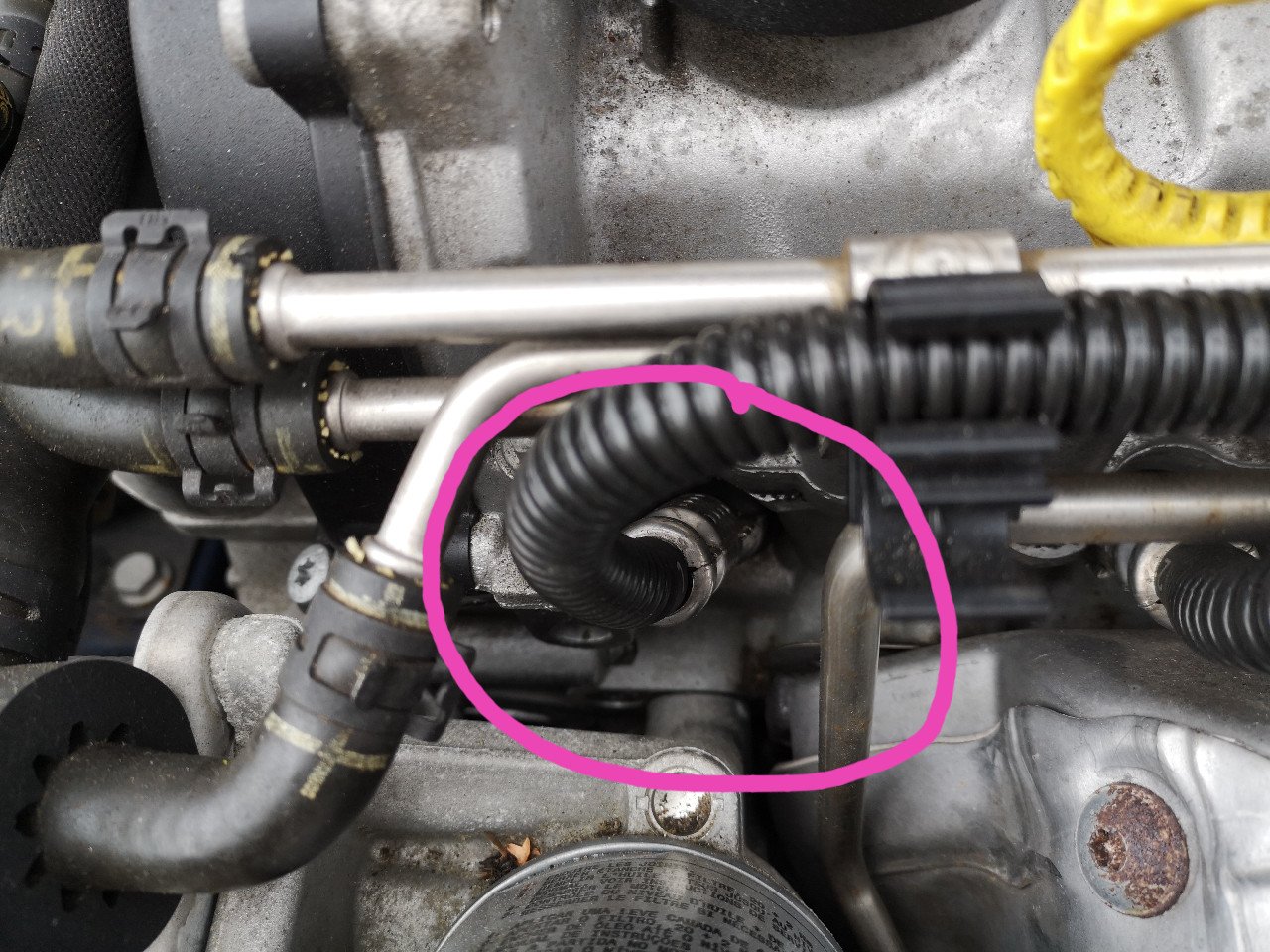

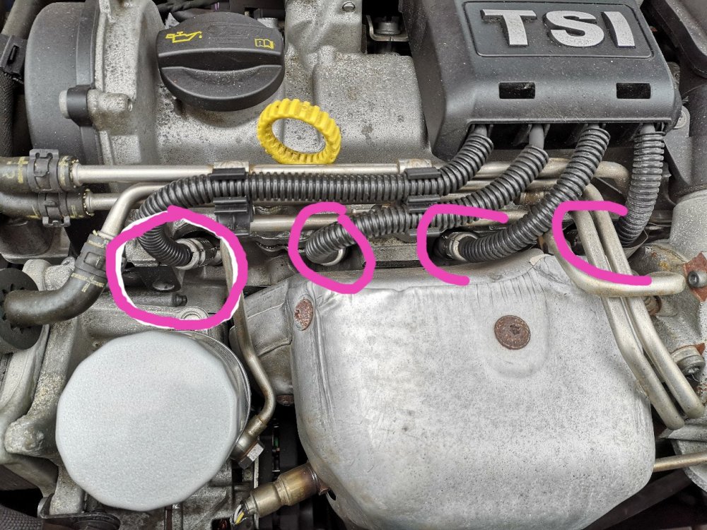

Is no3 plug easy to withdraw? space looks tight: the metal cowling is kept in place. I have the same layout.
