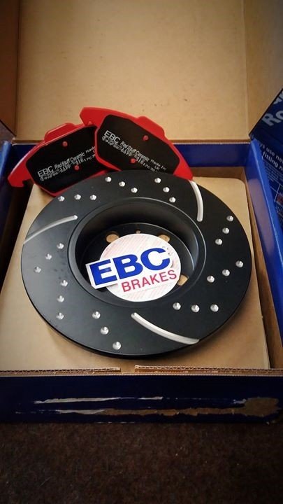

Brake upgrade was my favourite mod - though i kept standard discs size for use with EBC's + Redstuff pads. All a bit overkill for road use but the brakes are a lot better.
ATE / Brembo's DISCS / NEW PADS + NEW DOT 4 would probably do the same job (unless you were tracking the car regular)
EBC's below:
http://www.eurocarparts.com/ecp/c/Skoda_Fabia_1.4_2011/p/performance-cars-styling/performance-styling-parts/performance-brake/performance-brake-disc/?926445321&1&&000711
http://www.eurocarparts.com/ecp/c/Skoda_Fabia_1.4_2011/p/performance-cars-styling/performance-brake/performance-styling-parts/performance-brake-pad/?93044025R&1&0fa032a5ade8091502fb2e65445e8b21636da8f9&000712
Goodridge Braided hoses + the DOT 4 Fluid :
https://www.goodridge.co.uk/products/car-brake-kit-for-skoda-fabia-vrs-1-4-turbo-2011-front-and-mids-2011-on?variant=31695441223
