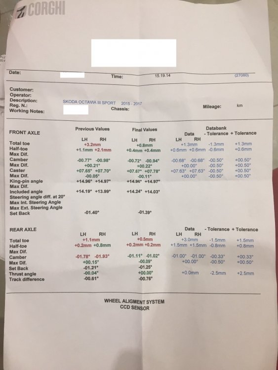

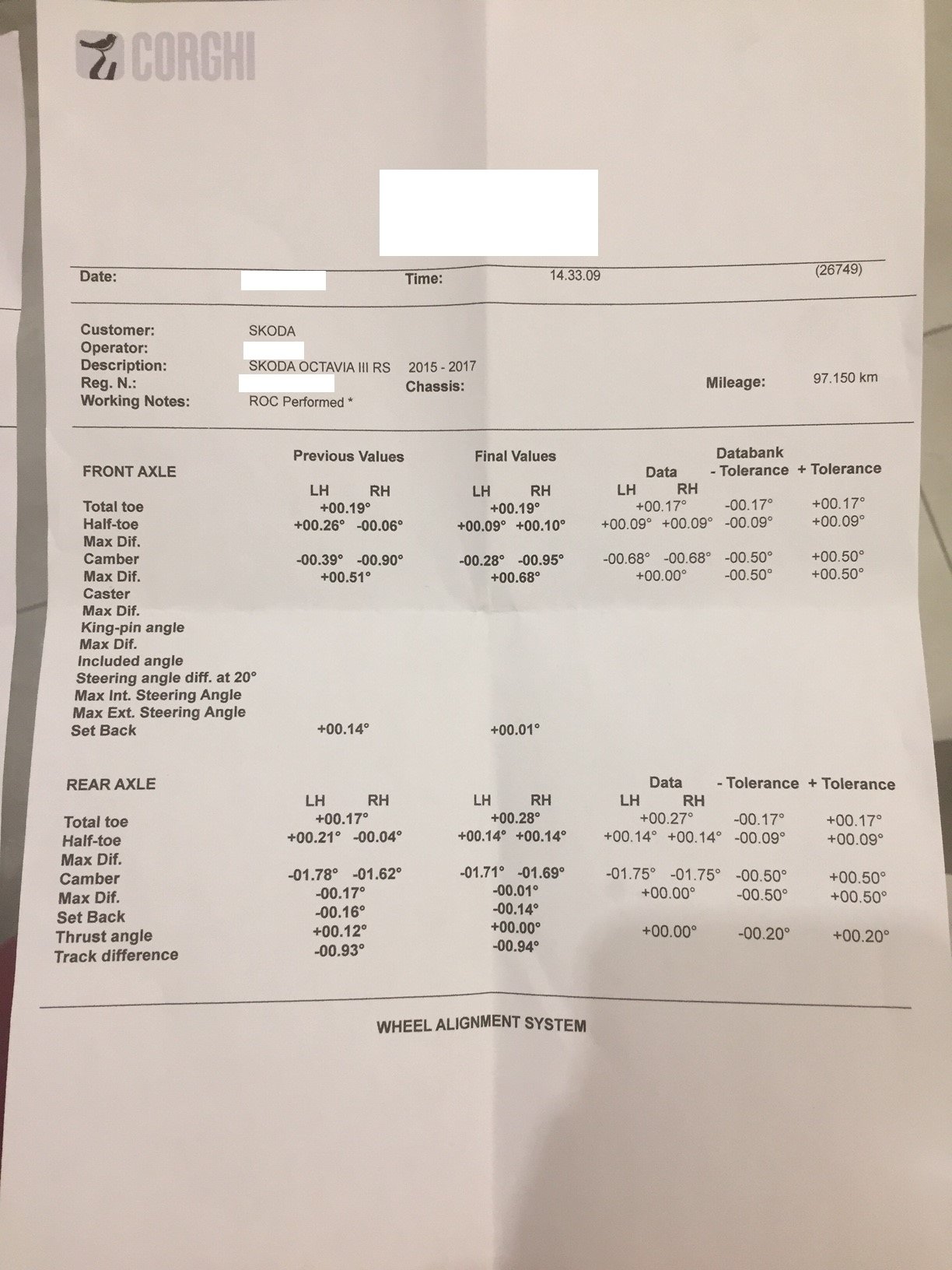

Hoping you can help. I own a 2015 VRS TDI. Just after getting an alignment done and I think they've used the wrong settings. The first is an alignment I got last year with Description SKODA OCTAVIA III RS and the one I got today is the one with description SKODA OCTAVIA III SPORT.
Although I see the toe on the recent one is on MM as opposed to Degrees - the other standard specs are different from one another - leading me to think that my car as been incorrectly adjusted.
Are either of these correct? Also - could someone post the geometry specs for the VRS as I'm going back to the place tomorrow to make sure it's all correct.

Thank you for the reply. I suppose what stands out to me - aside from the mm/degree difference is the rear axle where both camber and total toe degree readings are very different between settings.
this is two diff providers with two different machines.

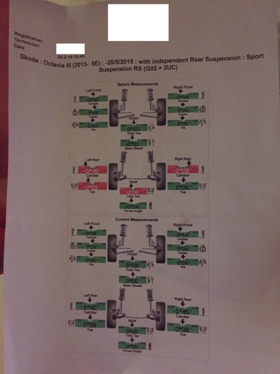

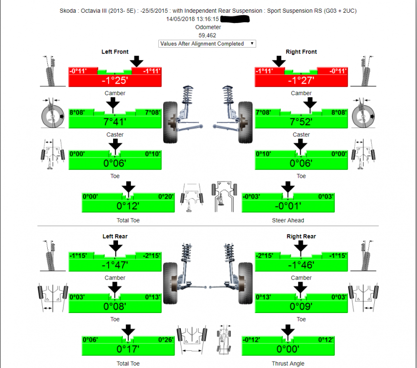

the correct settings....
you cant adjust front camber
Edited by JohnnyType2
Thank you for that!
How on earth is the corghi machine used in my alignment recommending -1.75 camber for the rear wheels when yours is a far more reasonable -1.45.
Is there a diff between Irish and uk specs ? I’d love to have the same amount of green on my alignment as yourself.

Ivan Kerr is the best in the business, he has a garage in carrick and a new one in bangor. Might be a bit far for you though. Theres no difference between any MK3 vRS specs. My steering wheels was aligned as part of the package as it should be in any hunter alignment, you have to to do the wheel alignment.
Thank you Johnny for the printout. I was able to track down an actual garage that uses Hunter equipment. An actual trained mechanic used it and got everything within spec. The exact same specs as on your sheet. The car now drives as it should.

Also - why are Corghi's databank optimum settings for the car so different from Hunter? Are Hunter machines kept up to date more often?
I can't get over how Corghi was insisting on -01.75 rear camber whilst Hunter was -01.45. Quite a difference.
It's still within the 'acceptable' range given on the Hunter machine by the look of it though.
