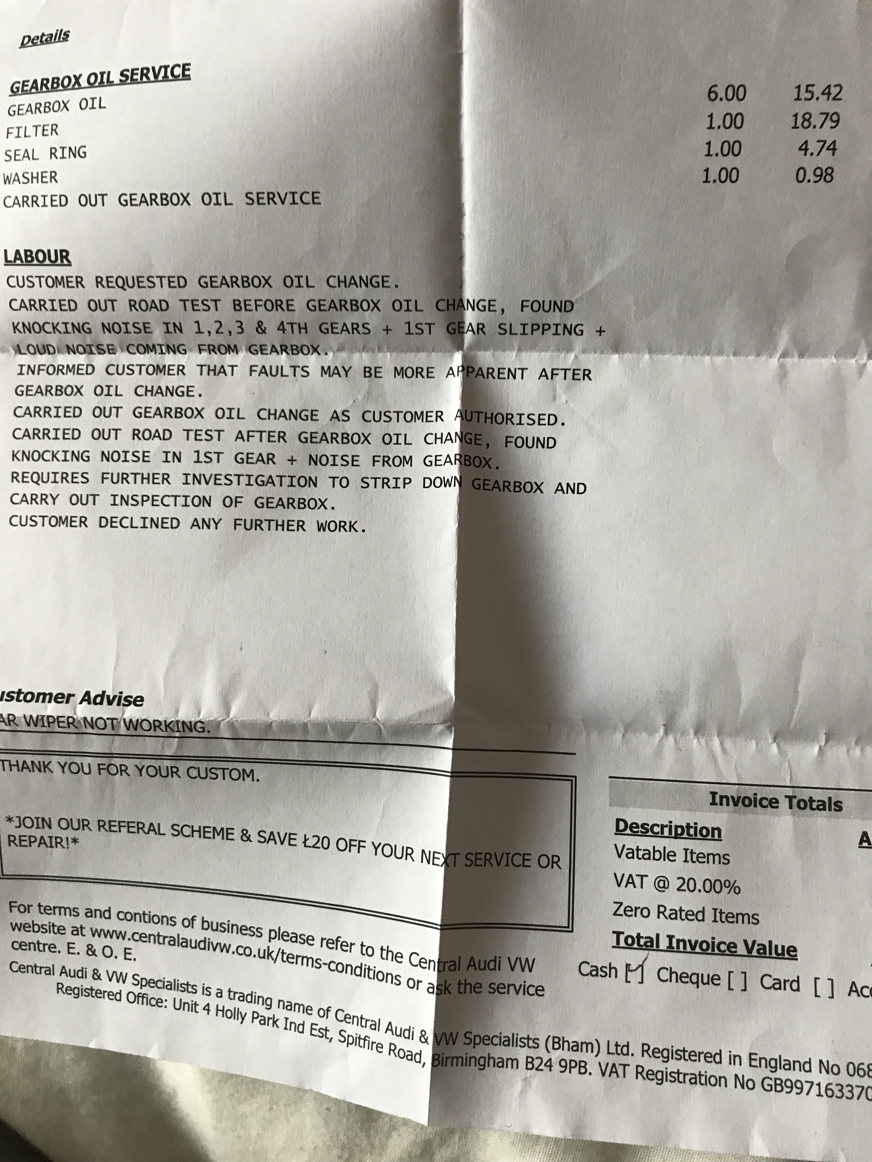

I will dig out the receipt and confirm
Receipt attached. It is 6L.
OK, it is reassuring to see 6 litres of oil, and the associated filter, seal and washer.  That is the good part!
Here is the bad part(s).
  1. They failed to add the part numbers to the invoice.  That is an official requirement - part numbers are needed to verify continuity of whether official genuine parts have been used or not.  The lack of part numbers will invalidate any warranty (official VW or independent), and even if there is no active warranty, it is still 'good and accepted practice' to always include them.  Part numbers are also required to ensure compliance with 'Trusted Trader' type schemes, and also stipulated under Codes of Conduct from both the Retail Motor Industry (RMI) and the Motor Ombudsman scheme.
  2. I am truly shocked to see their comment that "faults may be more apparent after a gearbox oil change".  That smacks of a total lack of professional competence on their behalf.  A routine gearbox oil change (when using genuine fluid) should never make faults worse!  If you pre-advised them of specific problems, they should drain the old oil into a clear container and then visually inspect it for debris (bits of clutch linings, broken or chipped gear teeth and/or selector forks, and excessive brass/copper type particles from worn synchro rings), and also inspect the old filter for similar debris - and report any findings to the vehicle owner.
  3. Shocked at the total lack of suggestion of official VAS or VCDS adapted drive procedure.
  4. Again gobsmacked they then suggested the next action to be a total gearbox strip-down!  This also shows a total lack of competency and basic knowledge of DSG dual clutch gearboxes.  Total strip down of DSGs are incredibly rare - indeed, the most common reasons to open them are to upgrade the differential to a full limited-slip diff from the likes of Quaife, or to replace shaft bearings.  Depending upon reported faults, the first option for 'major surgery' (and then only AFTER fluid and filter change, AND after a DSG adaption drive) will be either clutch pack replacement or mechatronics module replacement.
I would respectfully suggest searching for a specialist who has regular experience of DSG boxes, as it would seem that Central are out of their depth with DSG.  Apologies to be the bearer of bad news.
