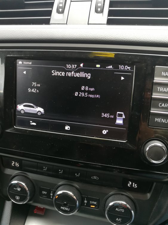

I bought this car few days ago..car had it's service which was just the Oil, Oil filter and also Air filter change by the company who acquired it. they didnt change Diesel filter and cabin filter. So I have decided to change them myself which i did. I bought UFI 2603800 Fuel Filte from eurocarparts and today when i was driving i realise that it was consuming 3time highrer than normal. did i do anything wrong. I have just seen the video and found it easy to do it myself. did i miss anything!

UFI is the brand for my car..i checked the hose, but no leaking..i opened cover of the fuel filter this morning. It stuck tightly with the lid..i couldnt find any problem..but as i am driving i can see the infoteinment and my fuel gaudge that,it is taking numerous amount of fuel..now the mileage is 69.2 and almost 4 bar of the gauge is gone.

If you have no leaks then the only other place for the fuel to go is through the engine.  Diesels run with a lot of excess air so adding extra fuel should give lots more power.  The amount of fuel you are describing would give a noticeable increase in power/torque.  I would suggest the OBC is reading things wrong and the calculations are based on false figures.
Skoffski has a good point in brimming and doing your own measurement.
Is that saying you've driven 75 miles at 8 miles per hour in 9h 42min ???
that was total driving since I refuel. But I would do what Skoffski said. I just need to clearly know, whether I need to fill the canister to the top or the fuel I collected while changing (which I already put in there) is ok.

Your fuel consumption hasn't changed. The parameters the car uses to calculate it have. The new filter is freer flowing and you'll have introduced a small amount of air into the system. Stop opening the fuel filter housing lid, you're just making it worse.
Never rely on the data in the infotainment system, it's a guide only. As mentioned above, the only way to accurately calculate fuel consumption is manually after filling the tank.
Give it a few weeks and everything will settle back down to normal.
I do not rely on infoteinment consumption data at all..in actual reality this data is even better than what is really consumed. But what would you think when you would see that your fuel gaudge has got 4.25 bars gone when it was just 89miles on the trip computer.
