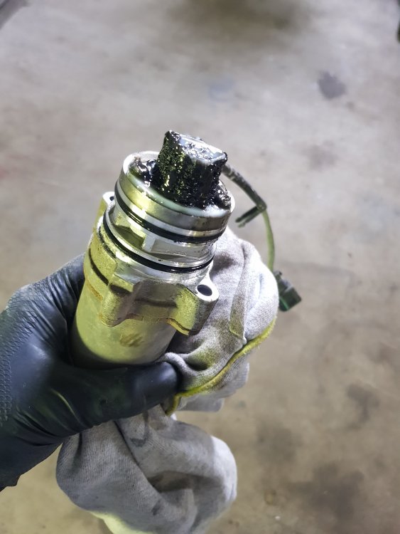

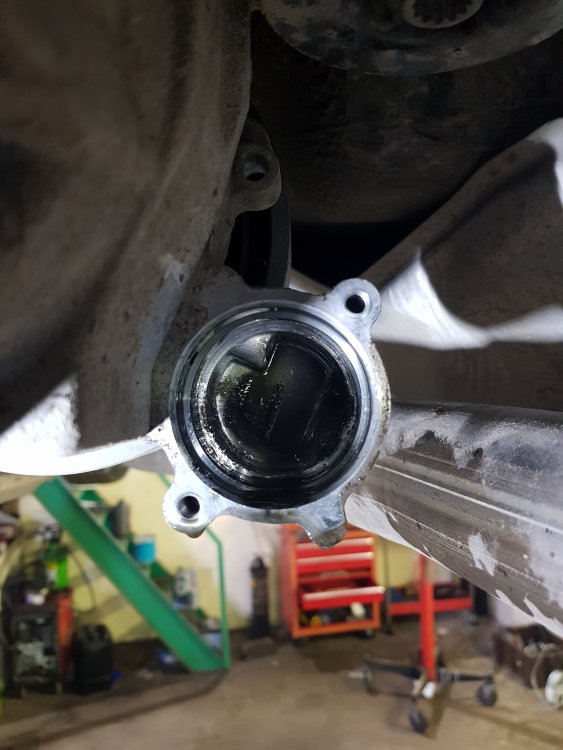

There's alot of uncertainty out there about the intervals of when it should be changed etc. My advice to anyone is get this oil changed every 15k. From now on mine will be done anually. With the Gen5 haldex there is no filter and the gauze on the pump is very small. It gets completely gunked up and my guess is it will starve the pump of oil. I've included pics below of my pump when I removed it today.

Below is the evidence this oil needs to be changed more frequently than the manufacturer recommends. With the oil changed I already notice a difference, my driveway requires reversing up an incline. Before the oil change I had to rev excessively to get the car to move up it as if I were riding the clutch. With the gauze cleaned and new oil it's zooming up the drive with hardly any extra revs and much more responsive!
Incredible. Looks as if a 15,000 mile oil change would still be far too long judging by the state of yours in those pictures.

I wholeheartedly agree with the diy oil change, however when I did my 2015 scout, with the same H5 system, the oil and gauze filter were quite clean in comparison. With only a small amount of swarf on the filter, and the oil still reasonably clear. That was at 30k, and with a good deal of usage (trailer towing and minor off road work). I would suggest that you may have some kind of internal problem with the haldex, with it producing that amount of gunk after only 15k. May be worth a dealer check if still under warranty?

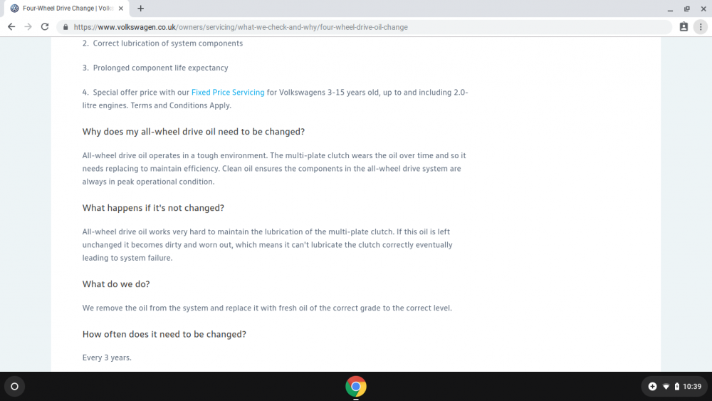

VW at least have something on a website.
Drivers or buyers of Approved Used Cars or just cars that have a FULL MAIN DEALER SERVICE HISTORY need to be aware that it does not mean they are Serviced to manufacturers guidelines as a Warranty requires, so maybe no Haldex , Brake Fluid change or DSG Service as Skoda are not good at having Guidelines clear to see / read or Schedules.  Service Plans do not even include things to Manufacturers Guidelines like Haldex / DSG or even Brake Fluid being done.

Xman I'm going to change mine annually after seeing this. My theory is that there's clutch plates in there so clutch dust mixed with oil has made this sludge!
I also expect it not to be as bad next service as I'm thinking this may be like a run in service.

Yes the schmoo that you have found is organic matter from the clutch plates, all the time the vehicle is running in 2WD mode there is slippage between the plates except when travelling in an absolute straight line and with identically worn tyres front and rear.
