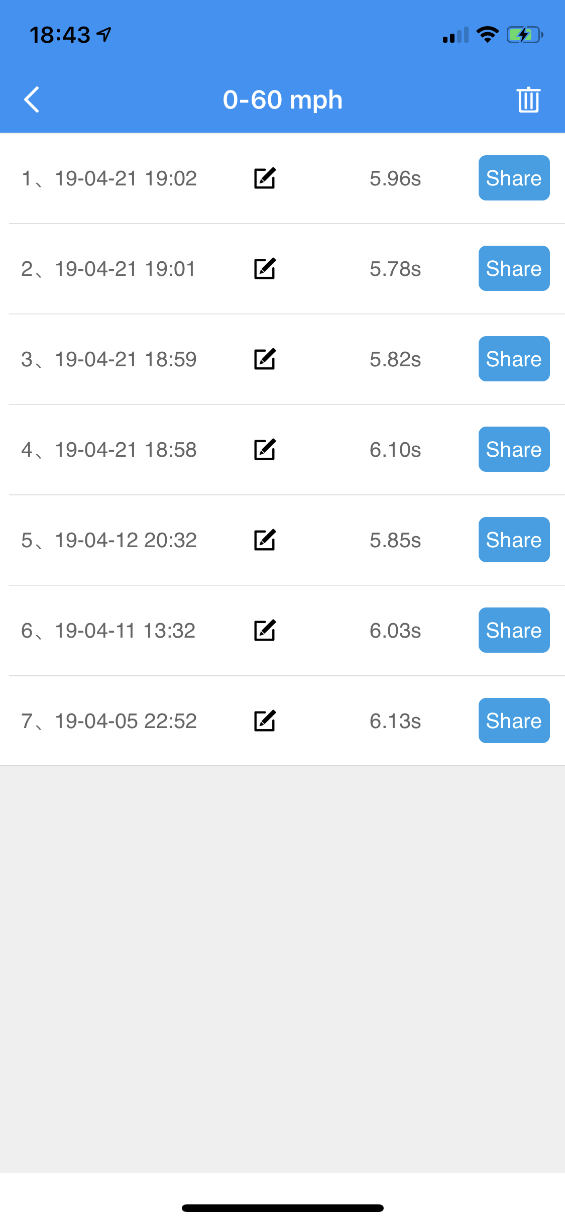

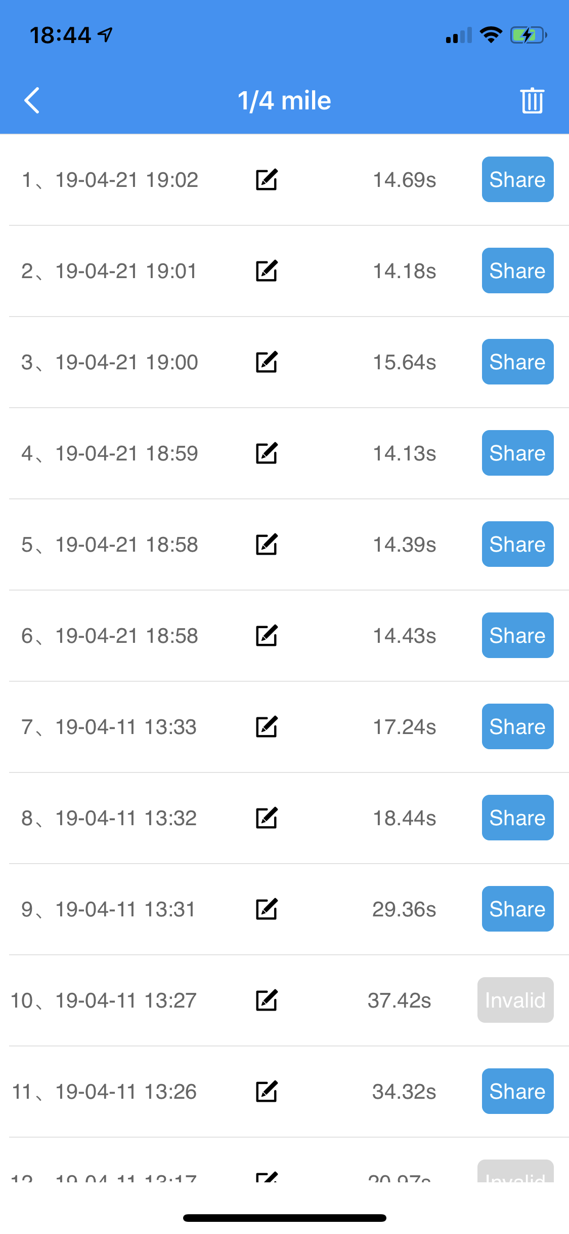

So, once all of that was done, sorted and i was rest assured, I decided to run some tests with my little friend dragy.
I did about 3 runs on the same stretch of flat surfaced road and well here’s my results:
fastest VALID 0-60 run was 5.78 seconds
fastest 1/4 mile run was 14.3 seconds.
I think it’s safe to say that she’s currently performing very optimally!

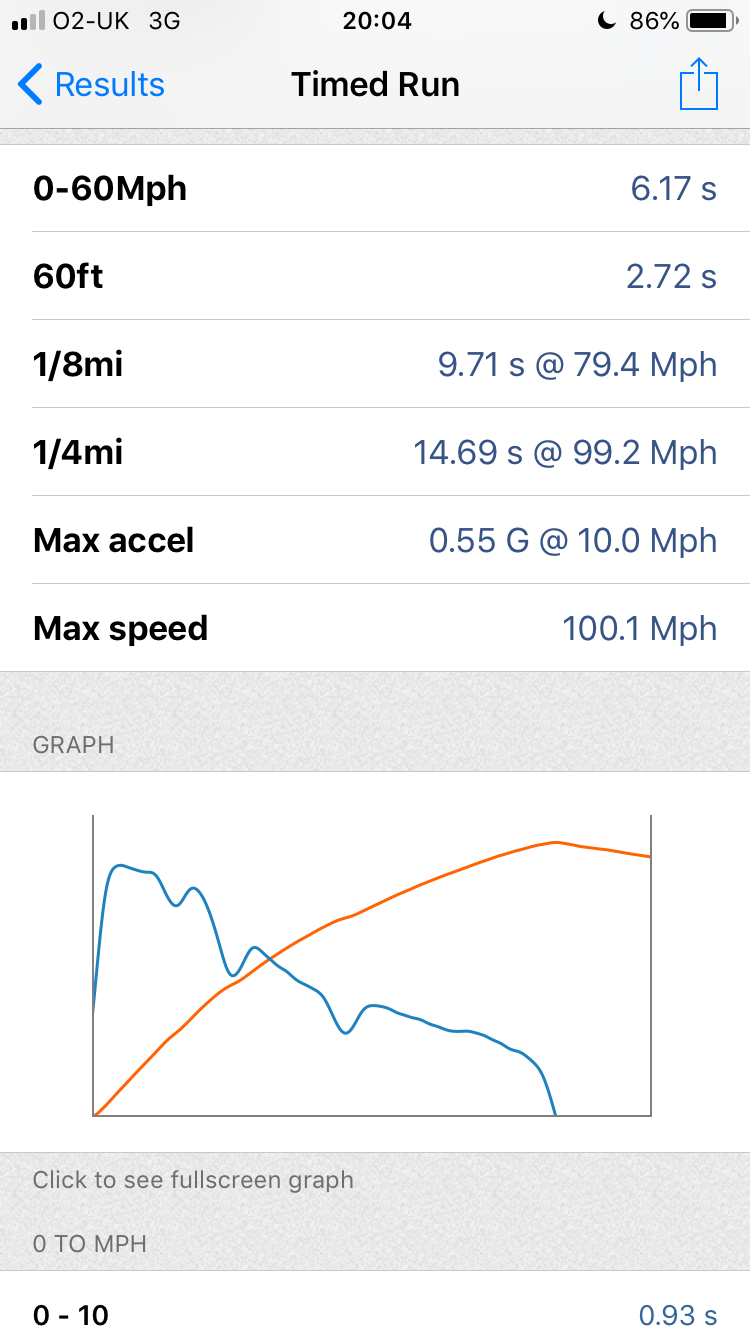

I assumed the app would tell you as the trap speed gives the best indication of power to weight ratio, and elapsed time gives the best indication of traction/launch. At that ET im expecting a 99-101 which would be something like 215hp.
This is an average run I did the other day in 23c on a crap surface.

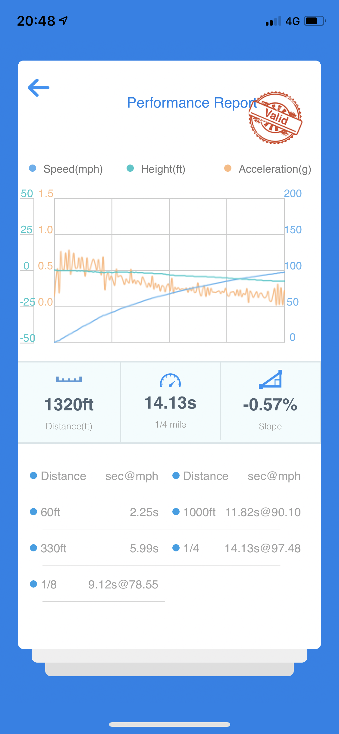

You are absolutely right
Quickest was 1/4 mile in 14.13 seconds at 97.48mph i believe
see image below
What is the BHP given these scores?

97mph is going to be in the 205-210hp range, but to be doing 14.3 on a road is phenomenal, either you have an incredible surface or those tyres are still ultra sticky.
Thanks mouse, makes me happy with a delightful compliment as such. It was a long 5 mile stretch of road where i was able to perform those launches, somewhere in the Harwich area. I had covered about 80 miles on the Mway, so tyres were sooooper grippy, no loss of traction maybe ever so slightly from 0-20 1st gear with TC off
