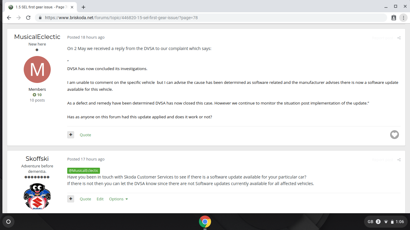

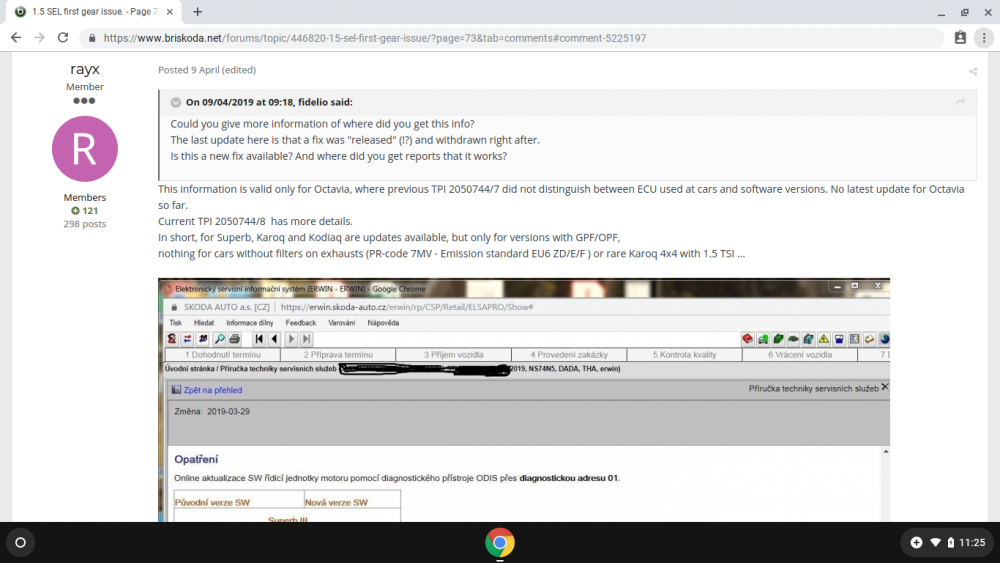

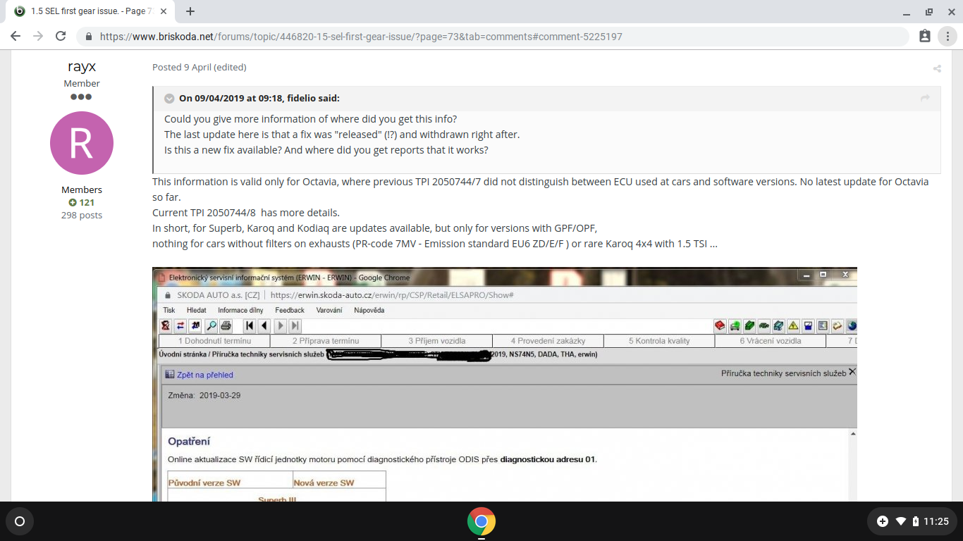

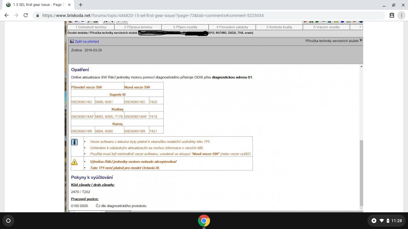

@SoupDragon   The Updated Software / Engine / DSG management is not only for 1.5TSI EVO Manuals.
It is for various vehicles, Manual & DSG and Pre GPF and post GPF.
There are issues that have been finally recognised and attempts at resolving those made by the VW Group.
Obviously all models / versions are not affected, it would be good if VW Group / Skoda were clearer in which are.  To the Dealership Front Desk people and the Owner / Drivers.
