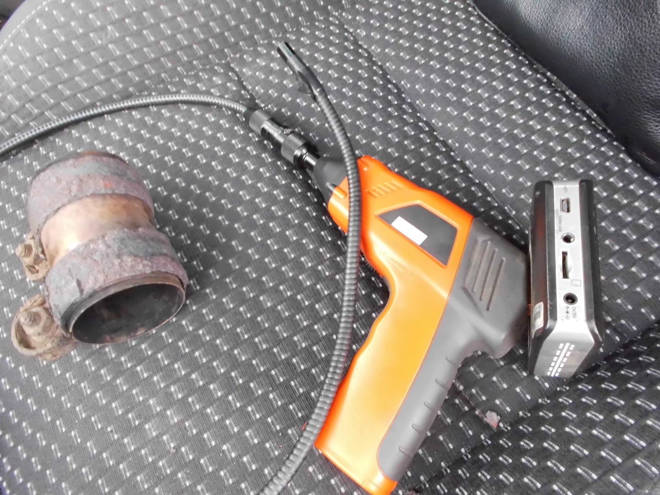

In the event, the front flexi looked okay as did the heat shields, but what had failed were BOTH clamps on the exhaust joining sleeve under the centre of the car!  Now one failing at that age is okay, I had that on my old Passat 4Motion when it was that age and I just replaced all 4 clamps - they just rot with salt and water. As I had initially bought the wrong size of joining sleeves for that 2000 Passat years ago, they were still available to use and the clamps were the correct size - nice when something only takes 30 minutes to fix!

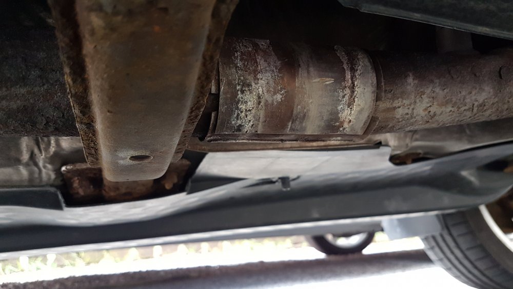

That was what I was thinking when I thought that I'd really be better to change both of these clamps - but both were rusted through completely and the sleeve was free to move and so the exhaust had drooped down and was touching the small crossmember.
It was just a case of biggish screwdriver in to lever/open the broken clip over the pipe/sleeve, at least on that car there was enough space/room to slide the sleeve along and off the pipe at the join, on my old 2000 VW Passat V6 that was not possible so the new clamps all 4 of them needed to be opened up and forced over the pipes then bent back into shape before tightening them - a bit of a faff when 3 of the old clamps were not rotted through so also needed to get opened up and levered off!
I'd guess that the first clamp broke but the other one held the sleeve tight enough to go unnoticed, then the second one broke and the sleeve opened up and let the pipe drop down a bit - lucky that small crossmember is there to limit its downward movement!

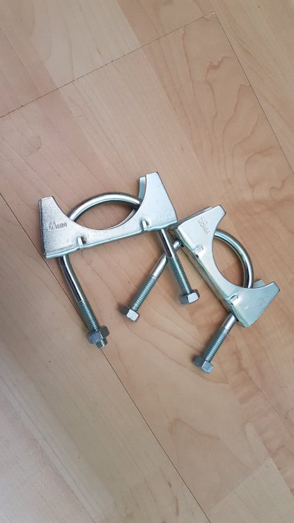

I was back under the Fabia again today (as you do) repairing the sleeve. When I had the cat out to repair the flexi pipe to the DFP I had to use jubilee clips. That was temporary until I could repair properly. 58mm exhaust clamps now on. Litle grease on the threads. Dont know why I bother as this car is going in 6 months. Old habits and all that!
