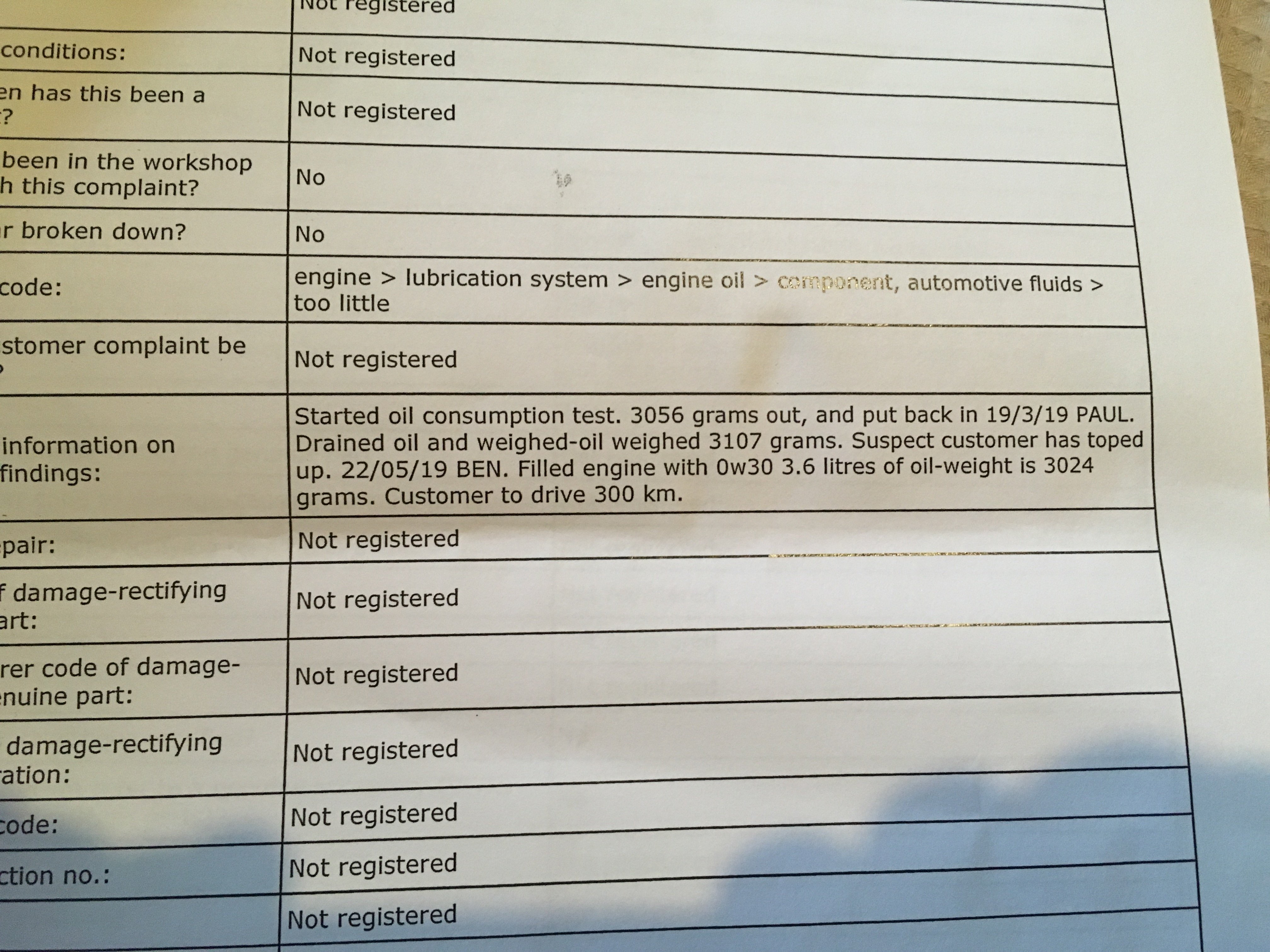

Dont know if this helps but on my first oil consumption test they said they suspect i toppsed it up with oil? Which is not the case at all. I wonder if the oil is hiding somewhere within the engine?
I can 100% say i did not top it up and just before i took it back to skoda for the second part of the test the oil level was at least half way or just below half way on the dipstick!
Edited by GT0161

9 minutes ago, GT0161 said:
Dont know if this helps but on my first oil consumption test they said they suspect i topped it up with oil? Which is not the case at all. I wonder if the oil is hiding somewhere within the engine?
I can 100% say i did not top it up and just before i took it back to skoda for the secind part of the test the oil level was at least half way or just below half way on the dipstick!
I think they just screwed up the test because oil doesn't weigh the same water. I monitor my usage by volume with a measuring jug which is much simpler, I don't know why they complicate the matter by using weight.
