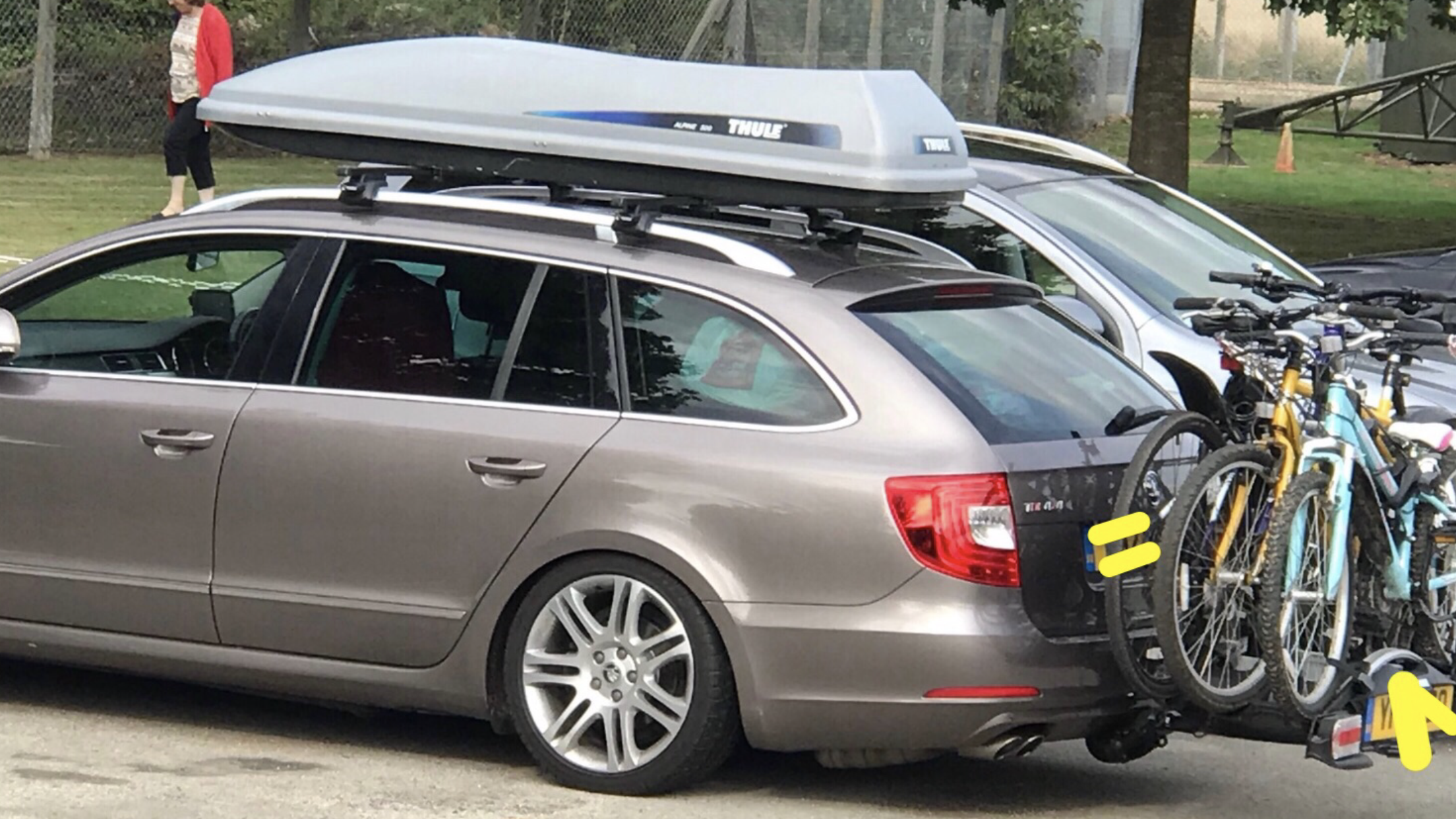

3181EE54-D6B8-4C09-91F0-4D2D1170AFD8.thumb.png.40beafb50b488b7c4766843fc8147da7.pngSomething must be wrong with it then or you need to get the council to adjust the bumps cos mine was fully loaded with camping kit and bike rack and didn’t bottom out over bumps by taking it easy and you won’t get a more overloaded one than this with the Mickey Mouse towbar which is way lower than the removable one now fitted.

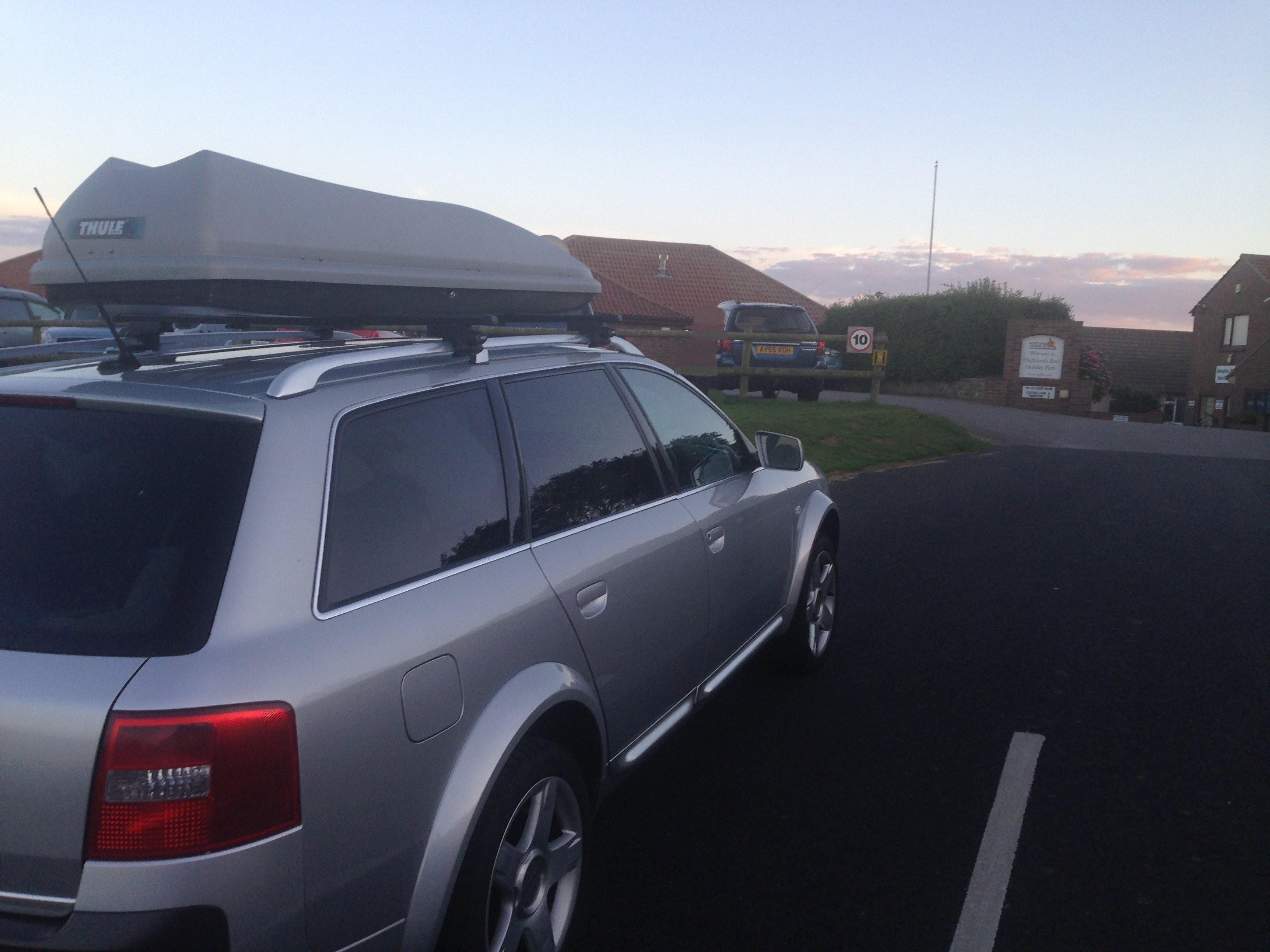

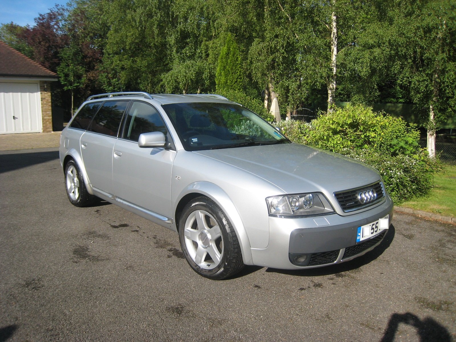

Or get an A6 Allroad, you can adjust front and back to preset ride heights, and even when the car is overloaded, it looks ok as it levels itself out. Mine was one of the last 55 plate 2.7 Bi Turbos, but ridiculous on fuel and getting old so it had to go.
This photo shows similar load and looks dead level.
Edited by FlyingSpanner
