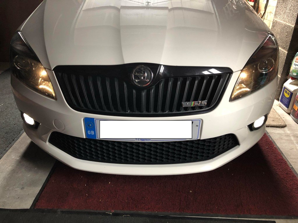

So DRL's as they come......
DRL's as factory

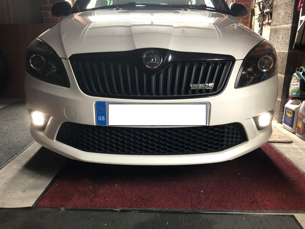

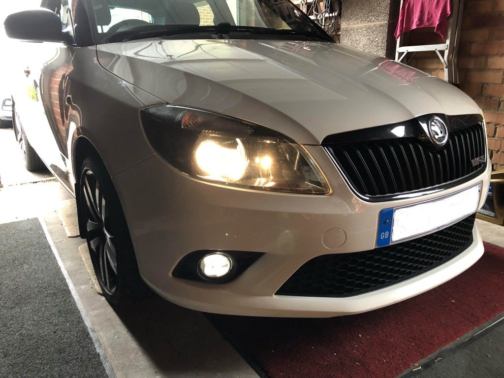

Side lights switched ON - DRL's Dimmed

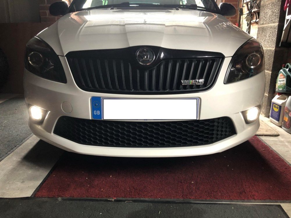

DRL's Dimmed - Side lights ON

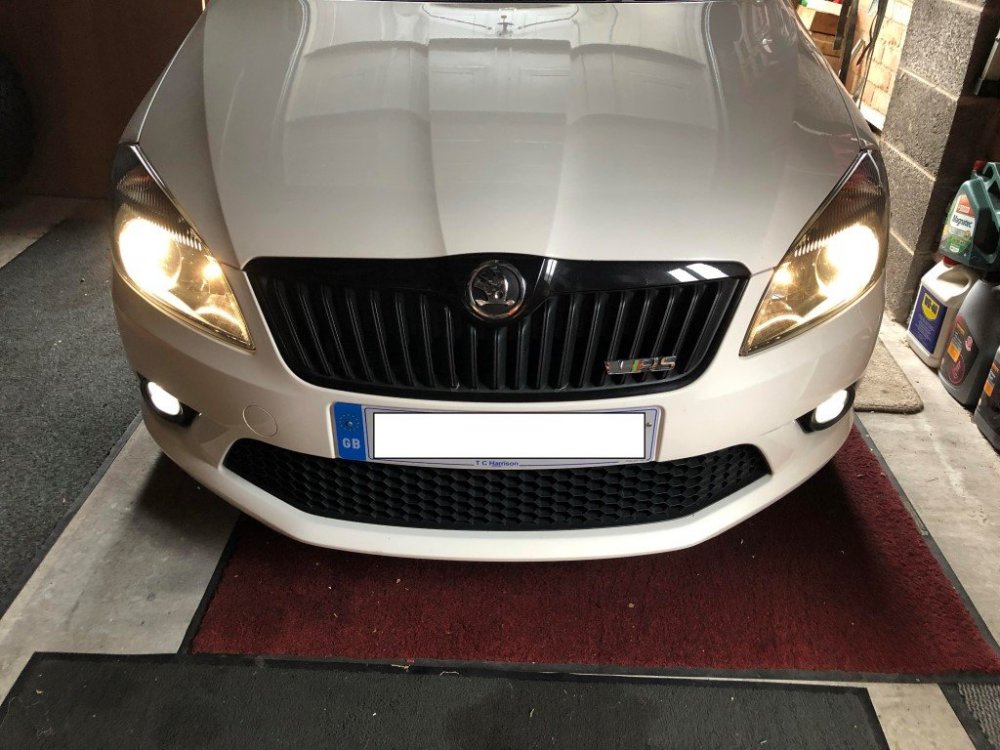

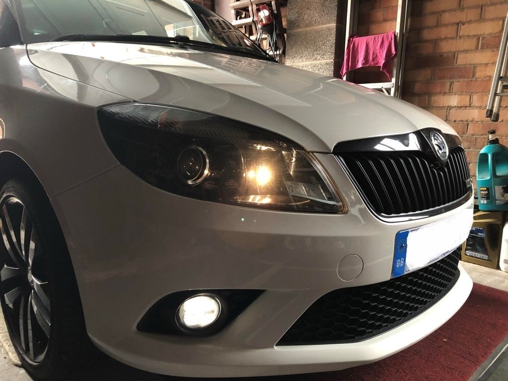

Headlights switched on - Side lights  ON - DRL's Dimmed
Headlights ON - Sidelights ON - DRL's dimmed
