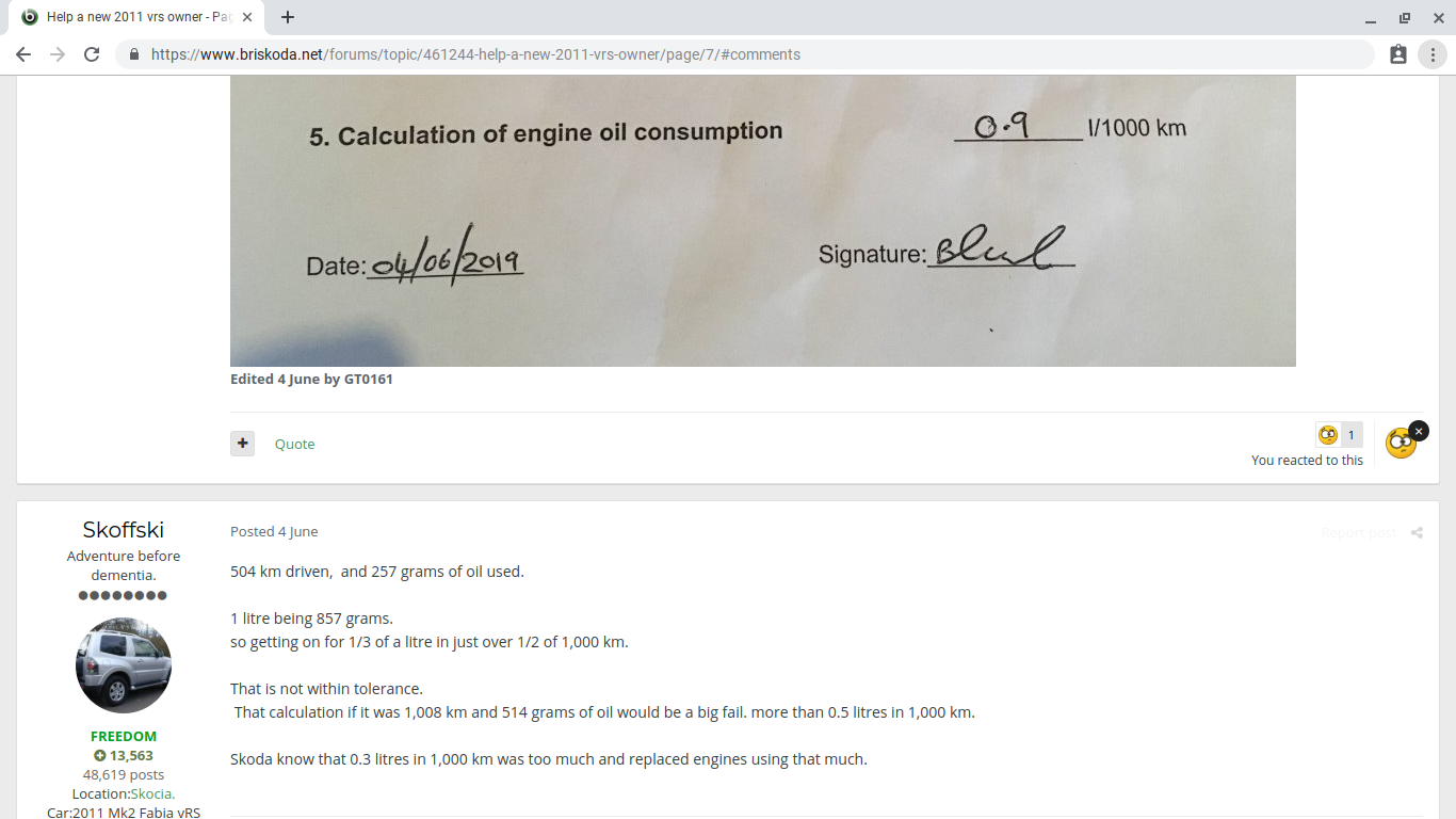

The thing is they have replaced plenty 1.4 TSI Twincharger engines that used less than 0.5 litres in 621 miles,
like as i mentioned 0.3 litres.
So what Skoda / VW say and what happens when faced with an Independent Motor Engineering experts report is a different matter.
The number of Main Dealerships that can not even get Official Oil Consumption tests carried out correctly is unbelievable.

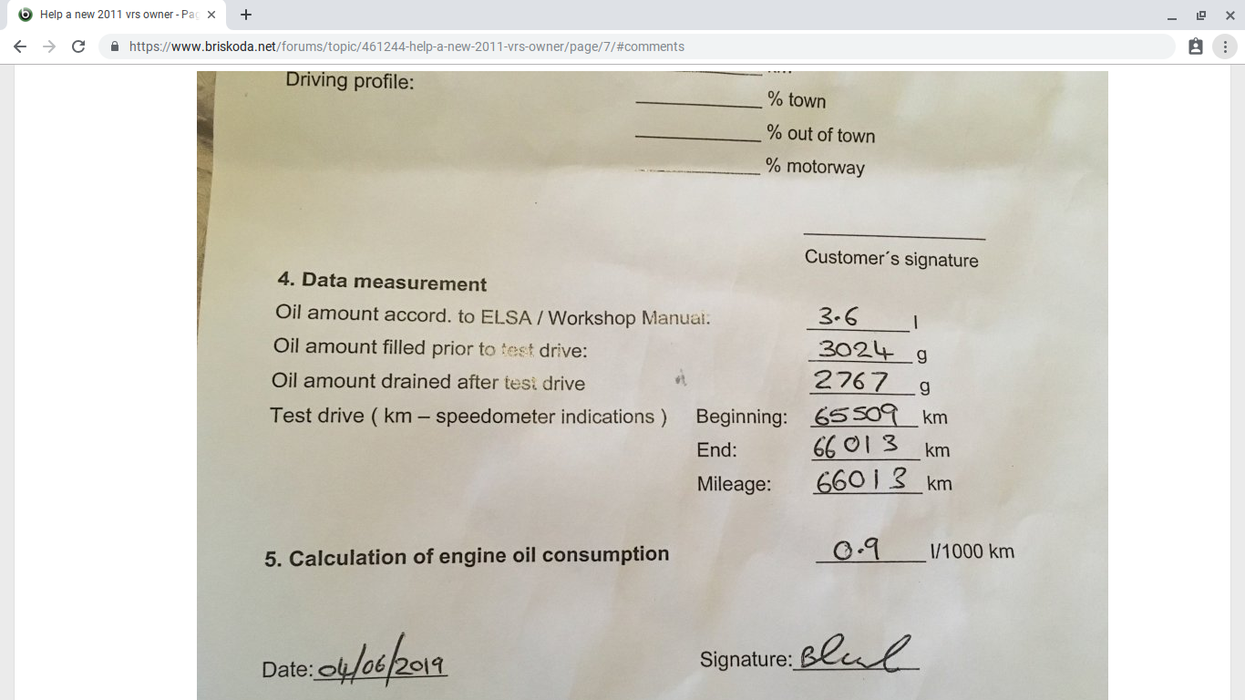

Not rocket science carrying out as per the TPI.   It should not be beyond a technician to know a litre of engine oil does not weigh 1,000 grams.
I show this invoice some muppet was responsible for, and the car got a new engine eventually,
Skoda UK get told regularly about how hopeless some Oil Consumption tests are and how done wrongly.
There was a member just last week that posted an absolute cracker that was just all wrong on the weights of oil and how much was used during the test.
