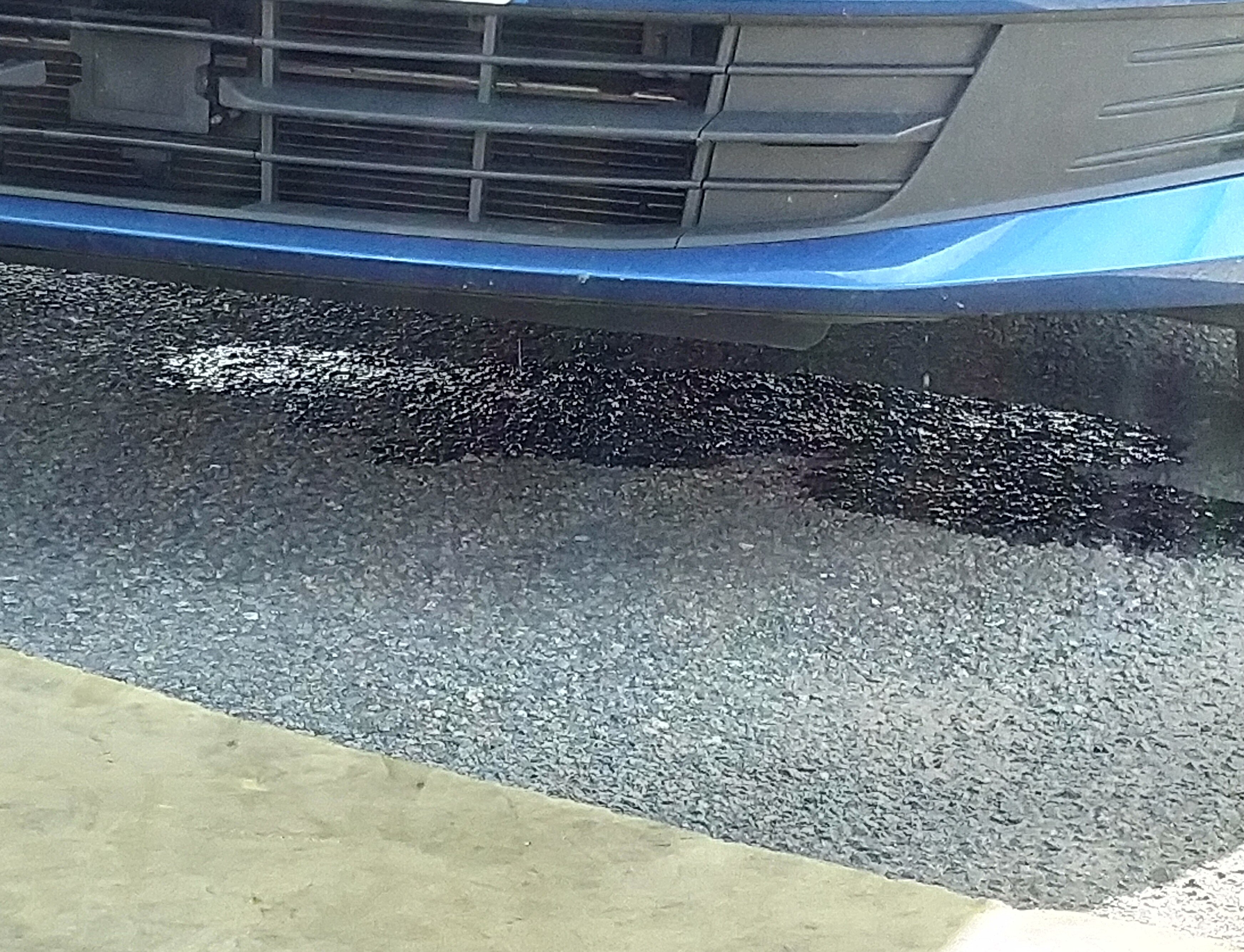

My 3 year old just out of warranty Fabia had to be towed this morning due to petrol pouring out of the holes in the undertray! Lucky I stopped before the car got hot or it could've been nasty.
Garage said the injector seal had gone because the injector bolt had snapped and so it was moving around. Anyone else had anything like this? Not what I expect from a fairly young car.

Ex demo, picked up at about 400 miles and done about 44k of perfectly happy miles since then.
There was enough petrol running out to cause me serious concern when the AA man decided to start the engine for a look! 😀
This is where I pulled up and switched the engine straight off.

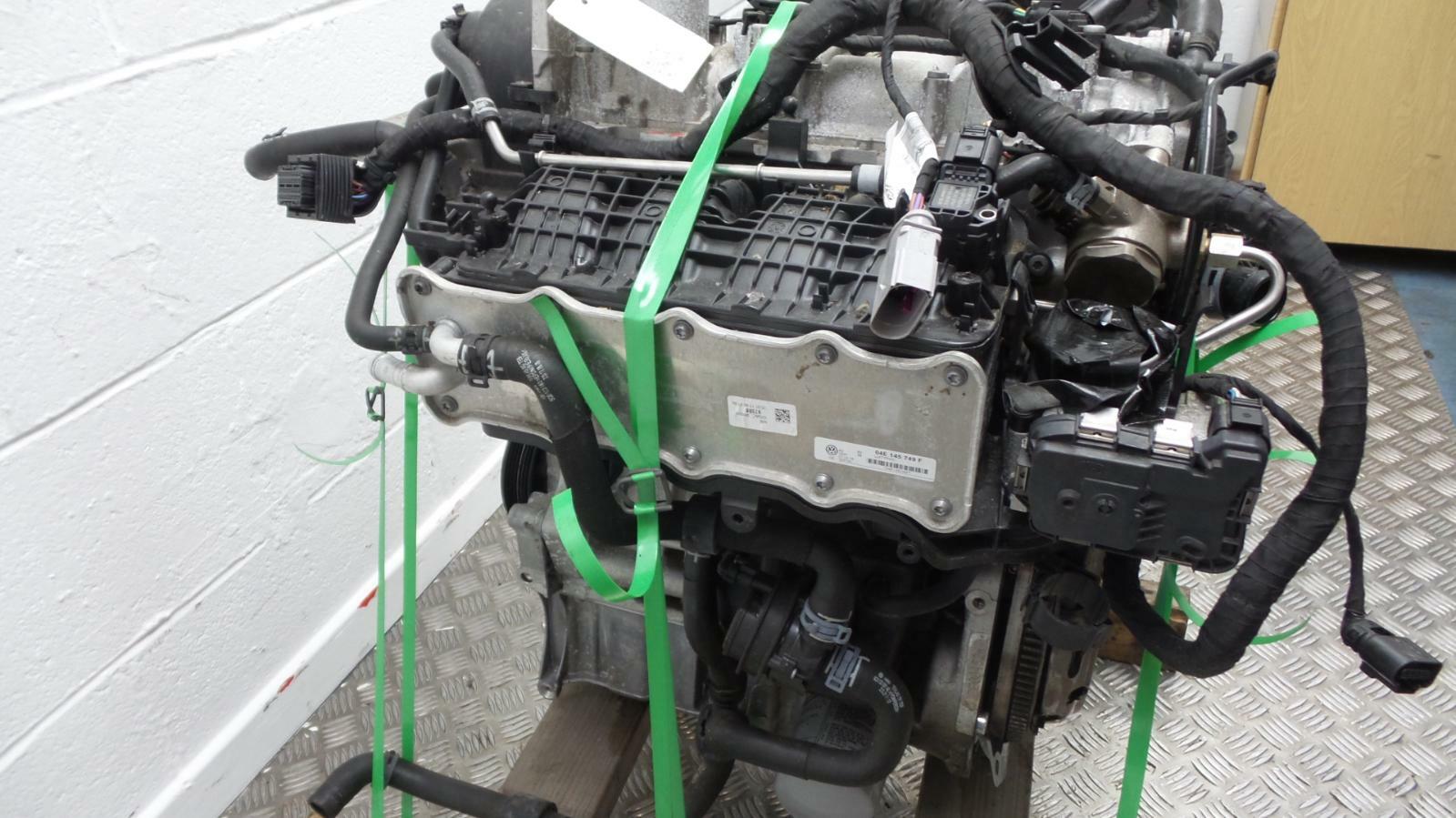

These engines run a 10.5:1 compression ratio. Direct injection with a high pressure fuel rail.
Looks like the injectors sit right under the intake holes in the head,
Right underneath and well protected by the intake "manifold",
So basically well protected from servicing abuse, the plot thickens!
