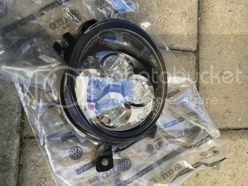

VRS/Monte:
LED Light Cluster (Acts as the Side Lights also) No idea how that come out, but it means replacing the entire unit, not just a bulb. I'm sure someone with a VRS/Monte will be along to help :)

Monte has same Foglight + DRL unit as the regular, same bumper same lights. Only vrs has the round led DRLs (or fog lights).

Re Mk2 vRS Fabia.
The DRL / Sidelight units comes off to replace without removing the bumper.
