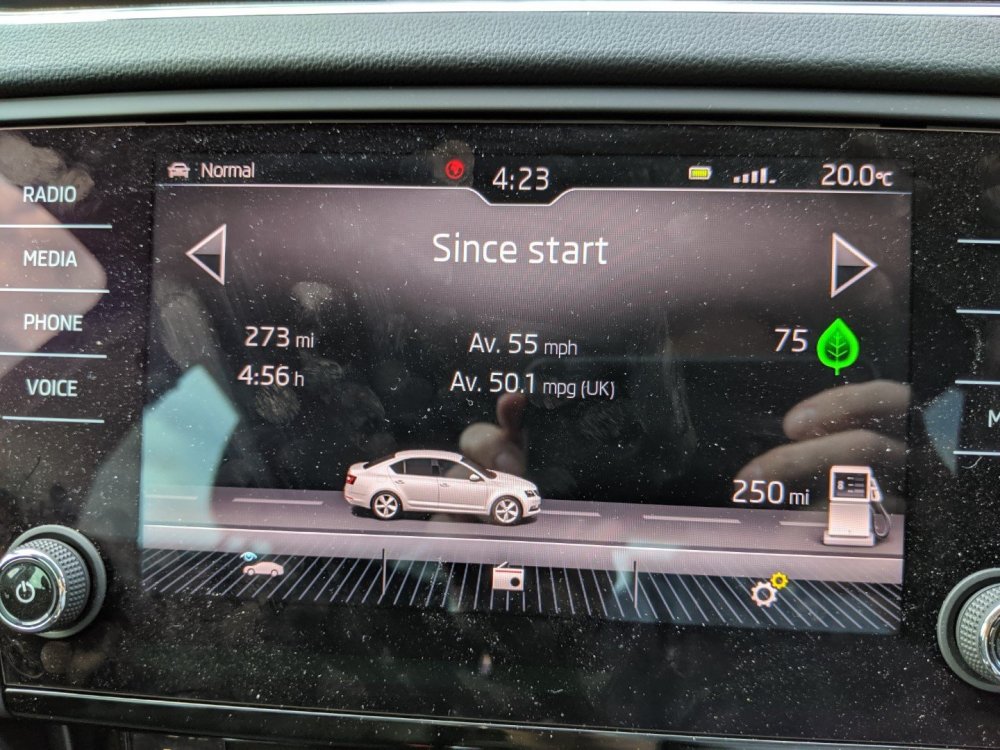

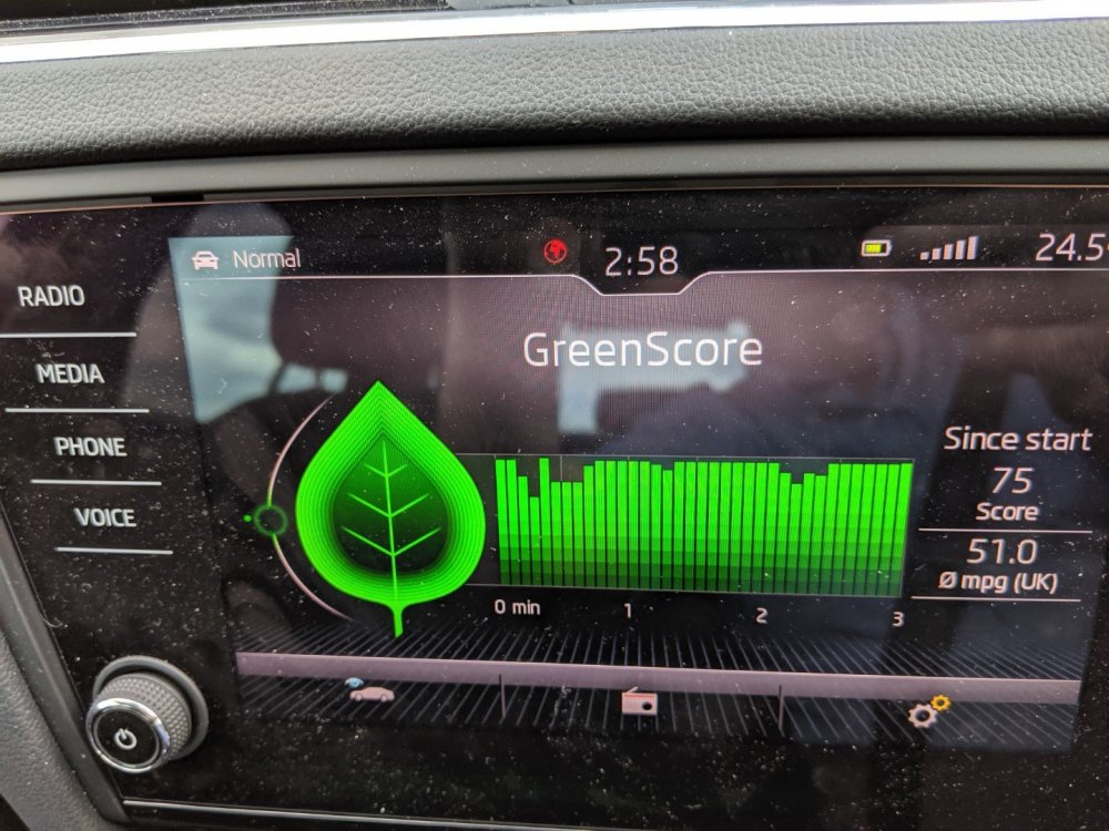

So, started a journey (~250 miles) and the MPG was woeful for approx half an hour, and then it suddenly shot up
much to my relief.
Happy bunny in the end, arrived at destination with an average 51.5 MPG (computer readout), this was travelling
at between 70 and 80MPH and with the air-con running as it was scorchio outside.
So, I'm guessing the GPF doesn't like successive short journeys, or my car is knackered! 🙂

So, to help you understand as I've probably explained everything badly...
For a couple of consecutive days my 10 minute journey to work has achieved an average -from start- of 20MPG, yes this is woeful as it's always
around 34MPG minimum.
On my 250 mile journey a couple of days ago, for roughly half an hour from start it was still at around 20MPG and then it reverted to 'normal'.
This then averaged out at ~51MPG at the end of the journey.
My long term average is something like 37MPG.
So, my main questions/query/assumption is that the GPF is doing what a DPF does and use a lot of fuel when it is active. And I didn't
realise petrol engines do this (or at least mine does), I though it was only diesels that needed that excessive fuelling/heat to burn
off the soot. This is something I've only recently noticed with my car.
