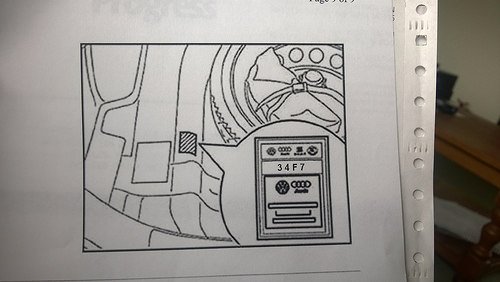

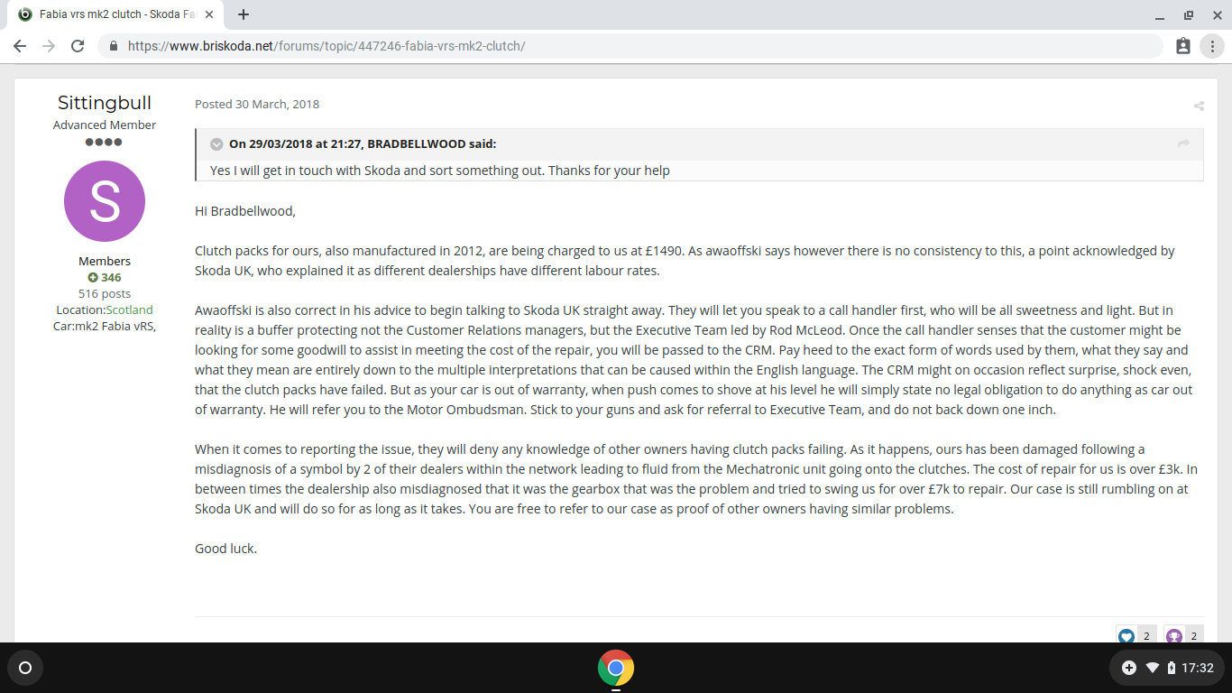

  • ? When was your car built. 2010-2012 or 2013-2014/15 ?   If the first has it had Service Campaign '34F7'.  Oil changed from Synthetic to Mineral & a software update.   Sticker
If the first has it had Service Campaign '34F7'.  Oil changed from Synthetic to Mineral & a software update.   Sticker in the boot with '34F7'.
or if from 2012/13 '34H5'.  Software Update.

Do you know if the service campaign was ever done on the DSG.  '34F7' changing the synthetic oil to mineral and a software update.
There should be a sticker in the boot showing it was done. That would be since May 2014.
