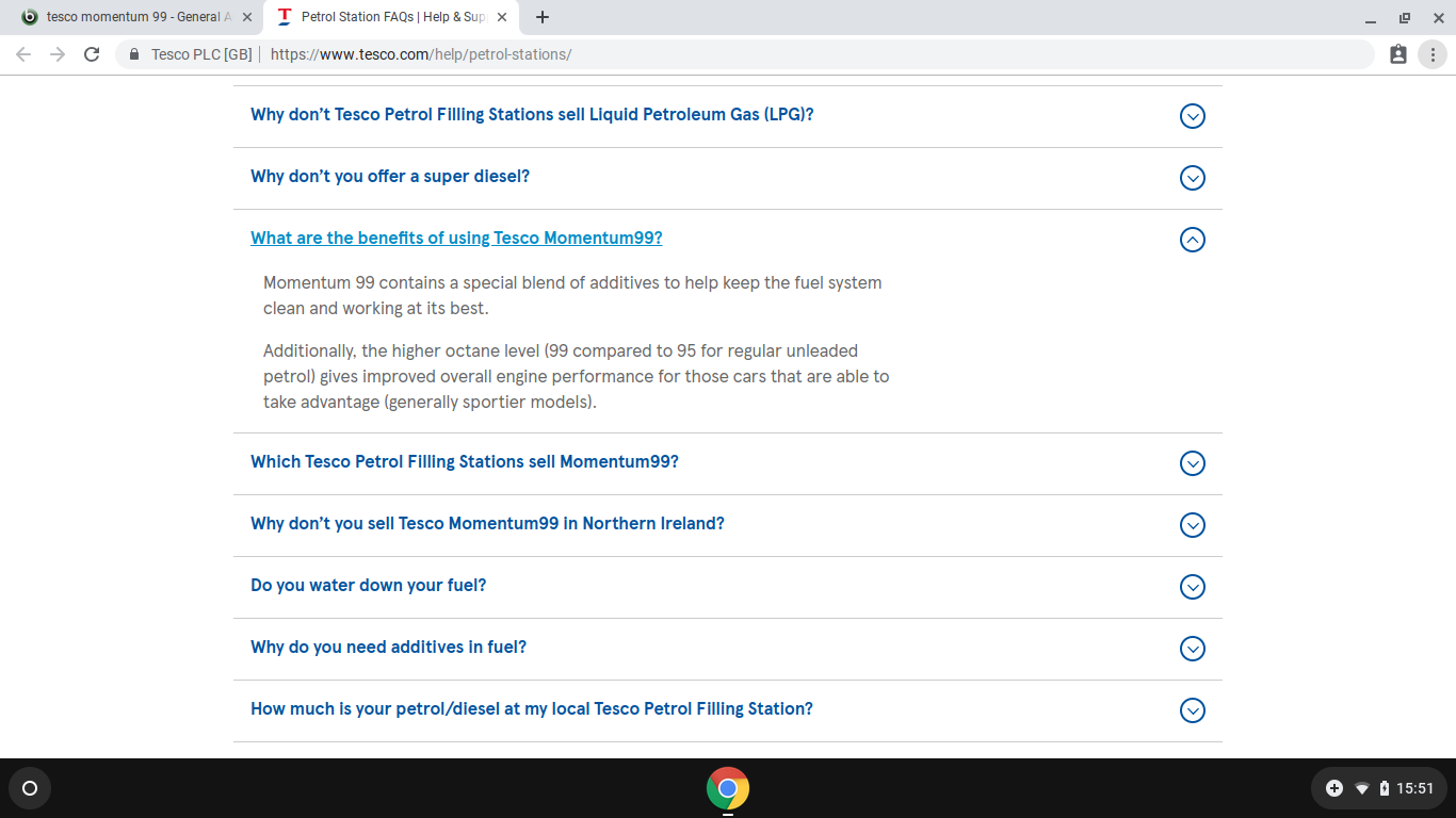

You are paying 5 pence a litre more in Tesco Filling stations than if you bought Tesco Unleaded, ie Standard Fuel,
Tesco Momentum 99 is 99 Ron Minimum the same as Shell V-Power Nitro + is 99 ron minimum in the UK.
Standard Tesco Unleaded is 95 ron.
Other brands of Super Unleaded in the UK is 97 ron minimum other than from Costco which is 99 ron minimum.

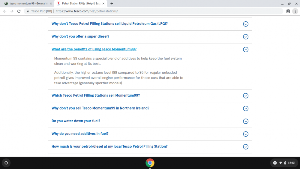

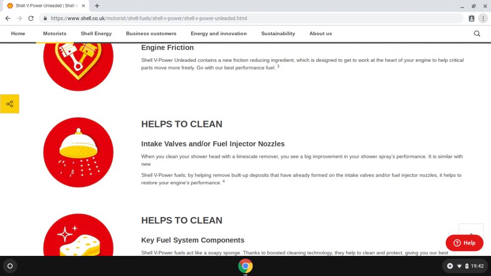

The wording on the fuel flap gives the clue as to whether the engine ecu fitted can adapt to use higher octane. Look it up on Briskoda and its also stated in the owners manual. Some cars won't benefit at all.
Can't be bothered searching for the threads/photos as this is a tiresome subject regularly revisited.
Any improvement in performance/power/economy is relatively minor, many will swear by it and make outrageous claims but they are merely taking a placebo and suffering confirmation bias. Adapting driving style to help their preconceptions.
One definite benefit is that many super unleaded fuels have a higher and or more exotic detergent additive content.

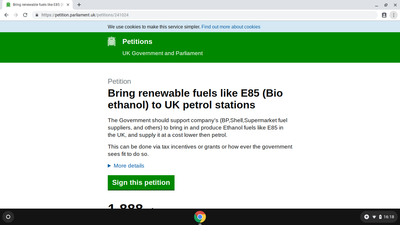

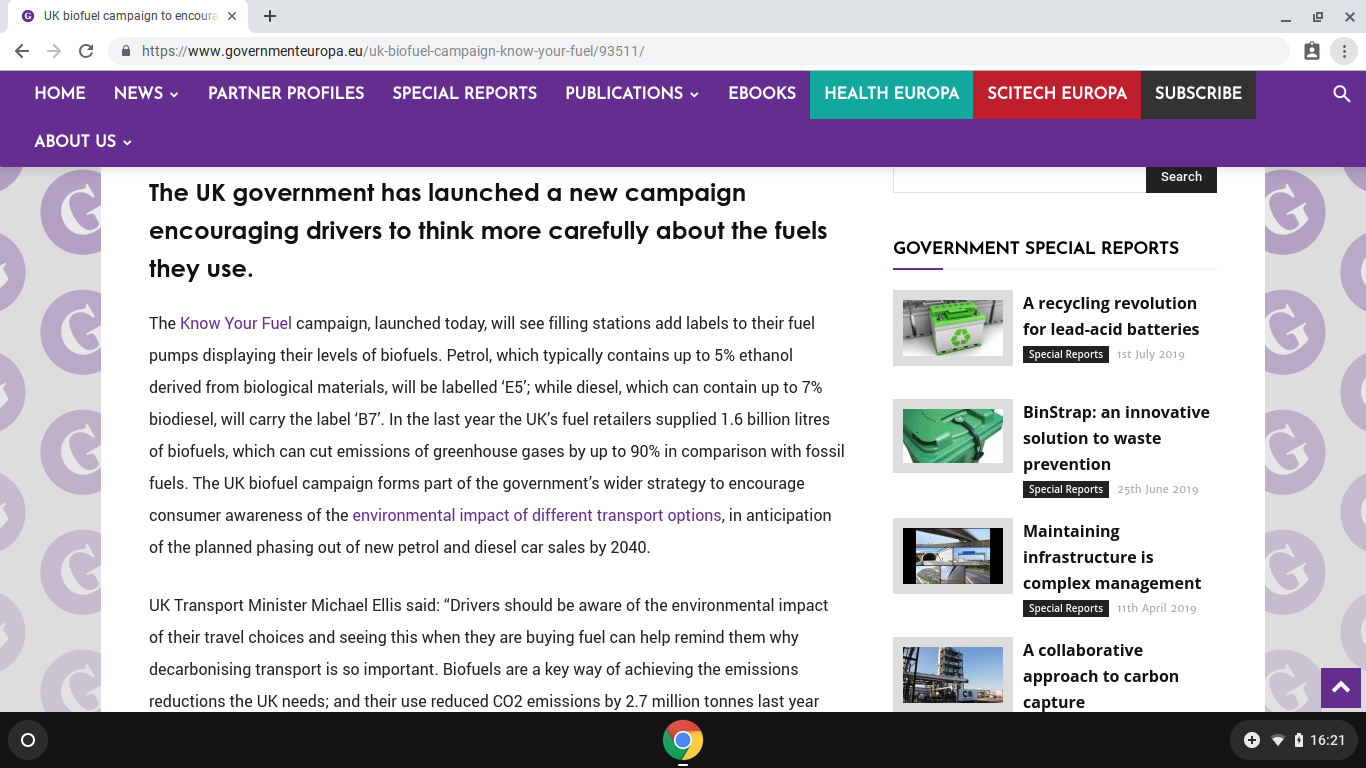

All UK petrol regular/super etc is now at least E5 which simply means it contains between 0% and 5% max ethanol. No way of actually knowing the content.
There as the BIO, and only this week there was calls for the 10% to be a 'Minimum' and again this week on radio and telly in the UK they were saying
'Almost all new petrol cars are OK with 10%'.
The Bio producers are trying to force the UK government to support them, in the UK and World Wide.
Then there those that say it should be E85.

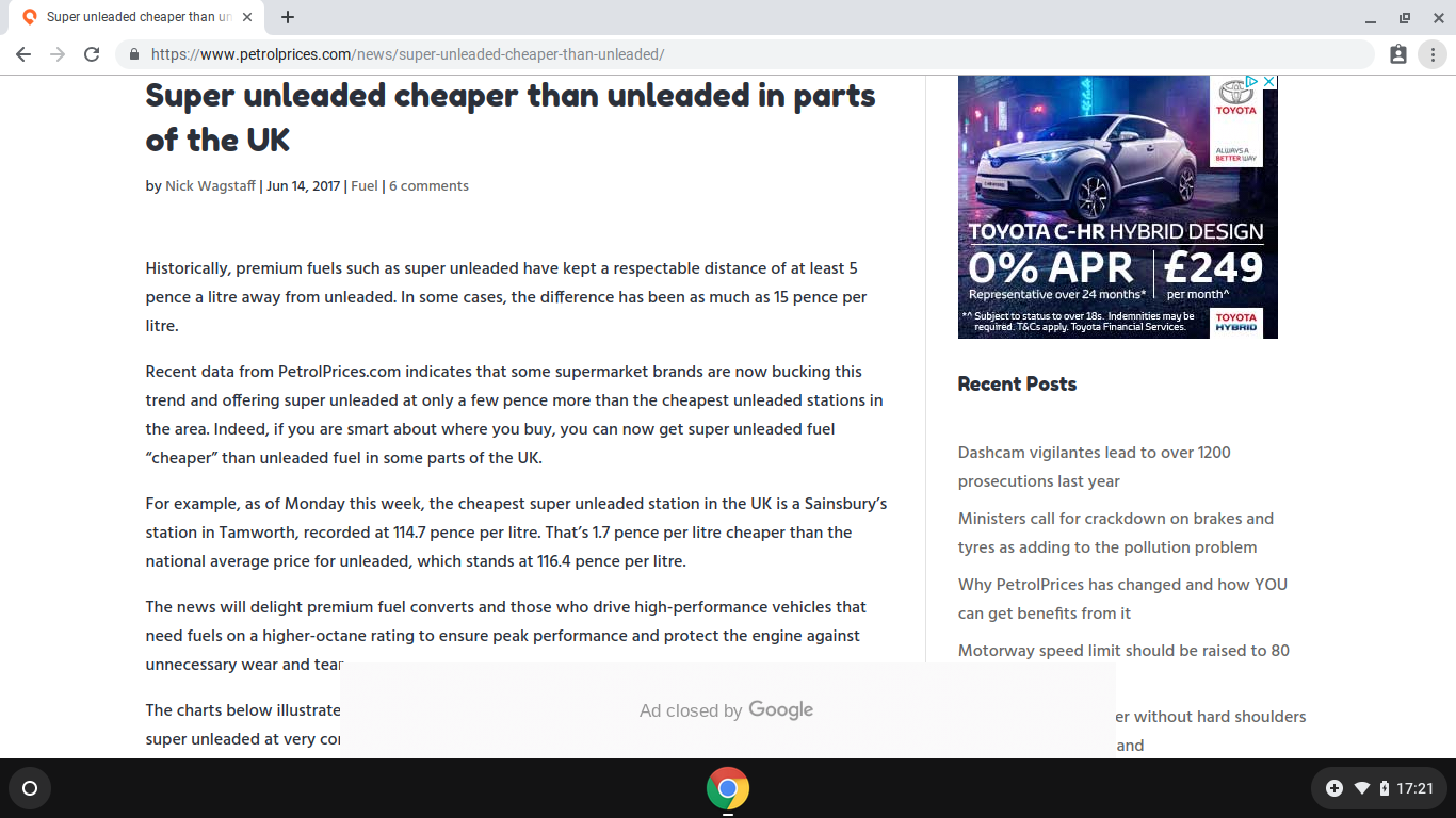

Ok here is a fun fact.
The price differential between the UK unleaded and super unleaded seems to be about 10p, perhaps more, please correct me if I am wrong.
The price differential in Australia between the equivalent 95 and 98 Octane fuels is about 10 cents.
Allowing for current exchange rates and ignoring the base price that makes the price differential between the two octanes roughly twice as great in the Uk as in Australia.
Now either you are using a much better grade of detergent than is added in Australia (yes and we get all the same marketing BS about how Shell/BP/Mobil premium grade will cleanse your engine like new) or perhaps you are being ripped off. I think the latter
There is no more fuel tax involved here it just pure profit for the UK petrol companies so of course they say the 'premium' fuel is fantastic, for them it is!

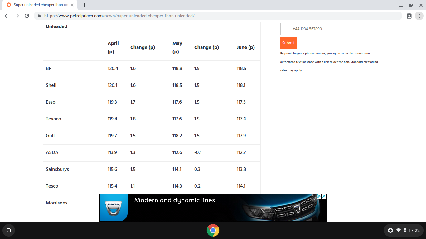

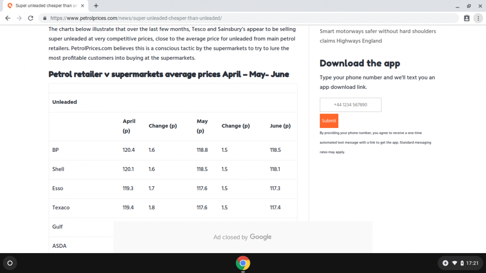

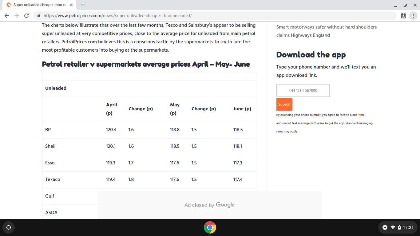

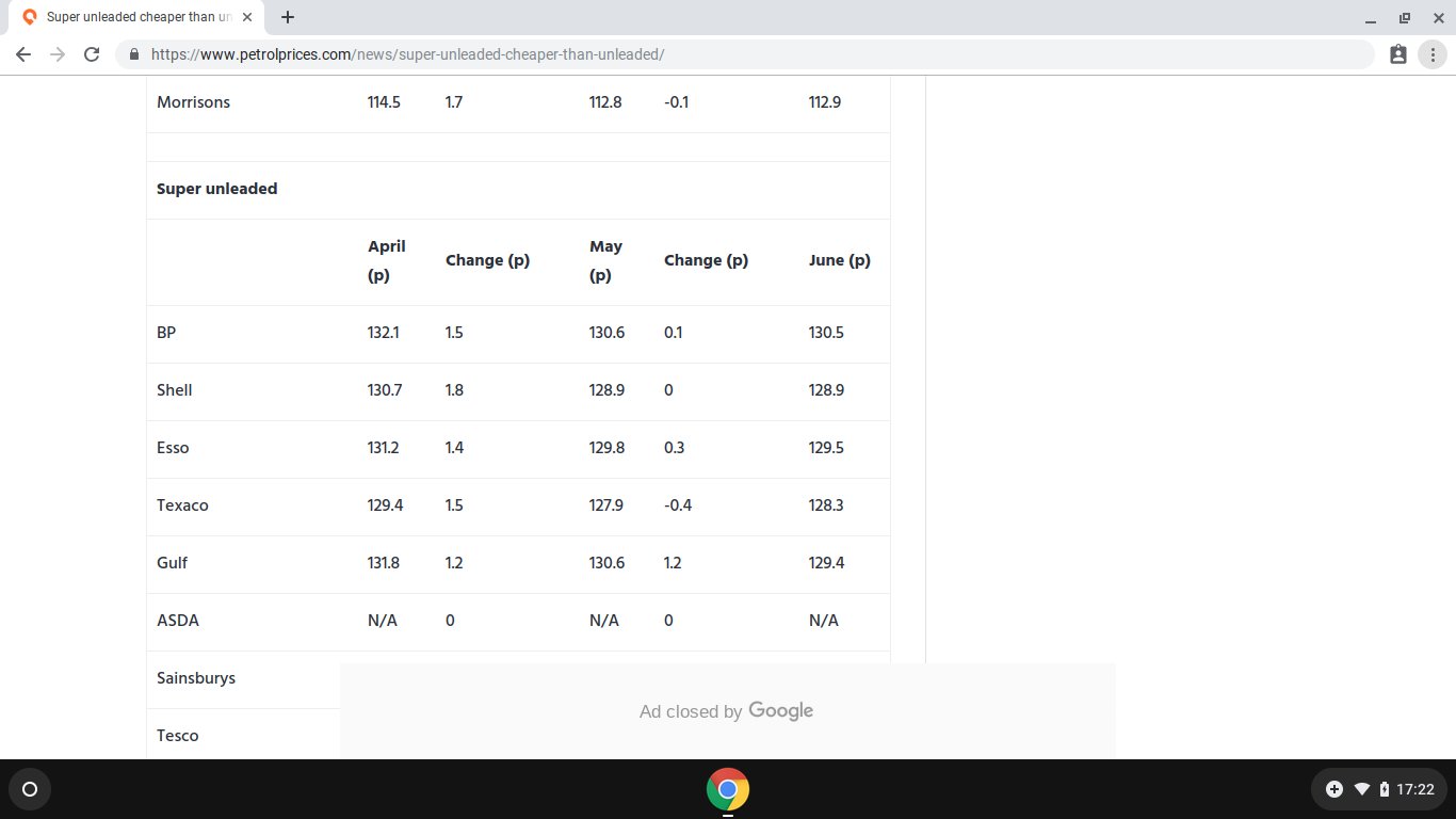

@Gerrycan  'You are wrong'.
Sainbury 97 ron is 5 pence a litre more than Sainsbury, 95, maybe Asda & Morrison and Tesco 95 ron Unleaded.
Tesco Momentum 99 is 5 pence a litre more than Tesco 95 ron Unleaded.
Now BP, Shell, Texaco, Gulf etc 95 Ron might cost the same or more than Tesco Momentum 99 or Sainsbury's 97 Super.
Shell V-P0wer Nitro Plus can be 10 pence a Litre more than Sainsbury's Super or Tescos, Costcos.
So you can have a tank of 97 or 99 ron in a Fabia for £2.25 more than a tank of Supermarket 95 and sometimes less than a tank of the Multi Nationals Unleaded 95 which is just Petrol the same as Supermarket branded.
V-Power Nitro+ maybe another £2.50 a tank more than 97/99 from Supermarkets,
As can be ESSO, Gulf, BP 97 ron Super Unleaded.
So £2.25 extra which is less than 2 litres costs of 95 ron from a supermarket filling station and maybe you get some extra miles maybe not.
Or maybe save £2.25 and use it to buy the 2 litres next time.

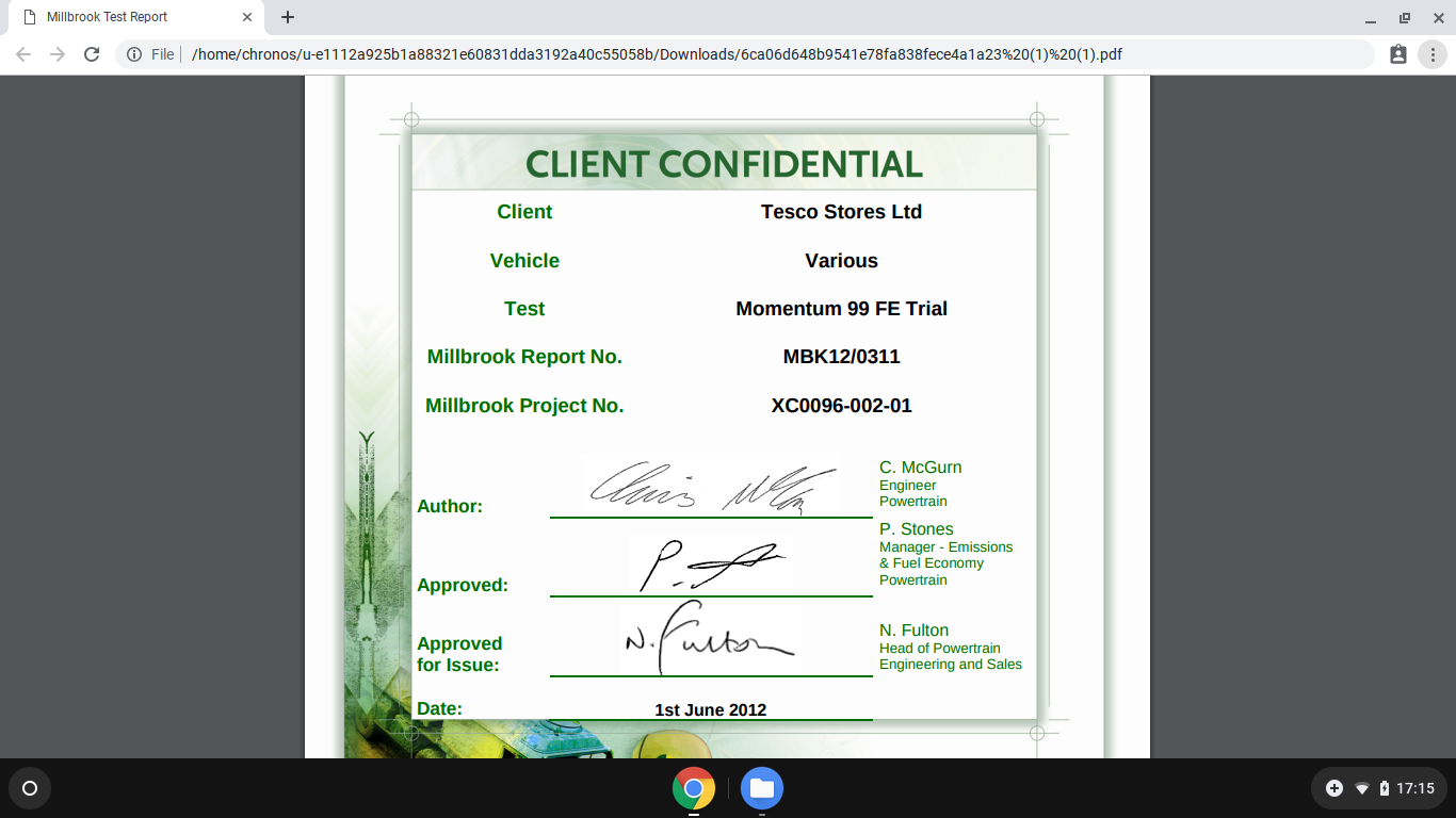

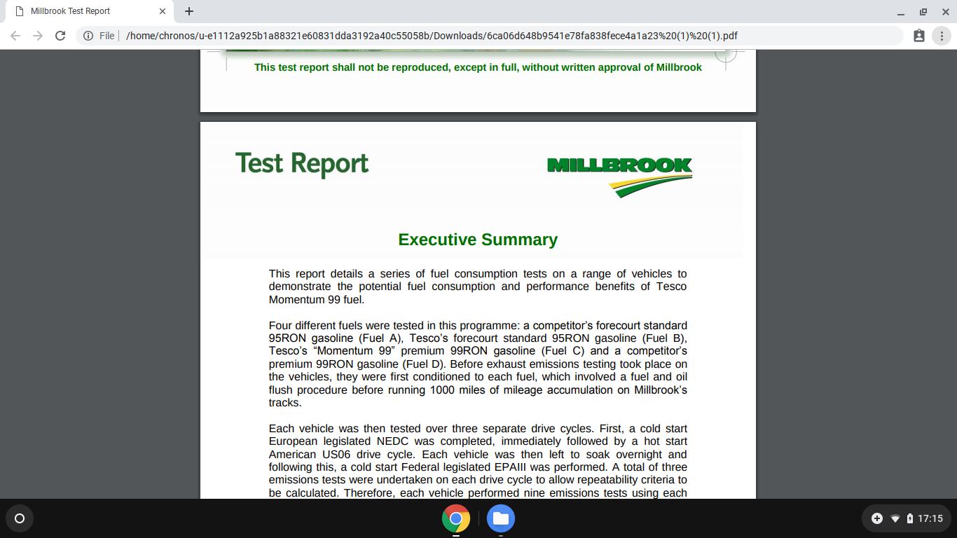

14 hours ago, Roottootemoot said:
Here is the test results that Tesco had from Millbrook back in 2012.
They were on Fuel Consumption and Emissions not power.   Different strokes for different folks, or what they drive.
388380a097b04fe693a8c27db8bb4974 (1).pdf 995.53 kB · 3 downloads 6ca06d648b9541e78fa838fece4a1a23 (1).pdf 2.86 MB · 3 downloads
George, yes we have those reports plus several others. Very valid Indeed for those vehicles that were tested way back then, but not so relevant on cars tuned for today's fuels & emission standards running PPF's etc (mostly the engines we tested). Engines have changed substantially, as has the fuel itself in some respects in order to meet the new emission standards. Note some of the cars tested in those reports were 2005, 2008 cars.
Momentum is a great fuel though and many cars can benefit from using it as it cleans the motor very well under normal driving, but I wouldn't use it myself as long term use is expensive for absolutely no gain in my Citroen for example, and possibly some detriment in some vehicles due to ECU's not being able to cope with timing alterations, as far as we could determine.
At this point I should say all fuels we used were done so "blind".  We had no idea what fuel was being used for each test other than it's octane rating. We were not testing individual branded fuels. Not our objective. In fact for power test purposes our fuels were specially manufactured with normal high grade cleaners in them. No actual branded fuels were used in the power output tests. This is done for lots of technical reasons. Remember, we design & develop engines and this form of testing is useful at various stages when working on developing new engines and making comparisons with other makes of engine.
Our testing showed 95 and 97 Ron to be the best all round fuel for best power and fuel economy. Most euro 6+ cars didn't benefit in any way from higher octane fuels, with many actually having worse performance, albeit by just a little that many owners probably wouldn't notice in normal driving. In fact many owners would I'm sure tell you their cars actually go better! However, don't forget, the engine designers develop everyday car engines to run on mainstream 95 ron. This is the most commonly available fuel everywhere in all parts of the world where modern small cars are sold.
In addition it's worth remembering that fuels like momemtum, in my experience and in the main, only restore your engine back to full performance. Rarely did we ever find an increase in performance of any kind over and above the normal expected performance range of an engine if running standard fuel. What happens is engines gradually get dirty inside (this includes injectors, fuel system etc) and good fuels just remove this muck, restoring normal operation. Always remember, there is no more stored energy in 99 octane fuel than in 95 octane.
