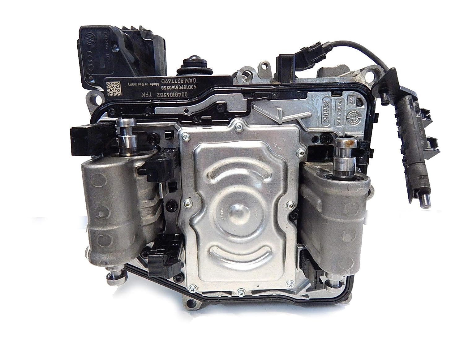

Mechatronic.
Image result for dq200 mechatronic
Edited by logiclee
Behind that metal shielding is an electrical circuit.
If it's hydraulic problems then it's almost always heat related. Heat or contamination in the fluid.
Commonly it is leaking of fluid with a 2013-2015 DQ200 DSG.
