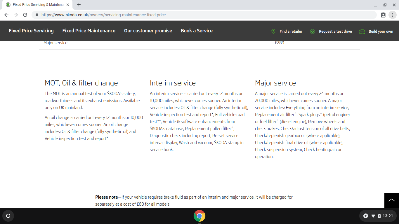

1 hour ago, Roottootemoot said:
Odd it went to their Trade Sales, but then maybe not
At least a Skoda Warranty should be fine if you take one out
http://insurewithskoda.co.uk/extended-warranty
Check the T&C's and exclusions and cost of work covered.
Certainly not unusual to pass on older cars to the trade. But if you are set on an extended warranty, perhaps an idea to contact Skoda first and inform them of that late DSG oil service:
