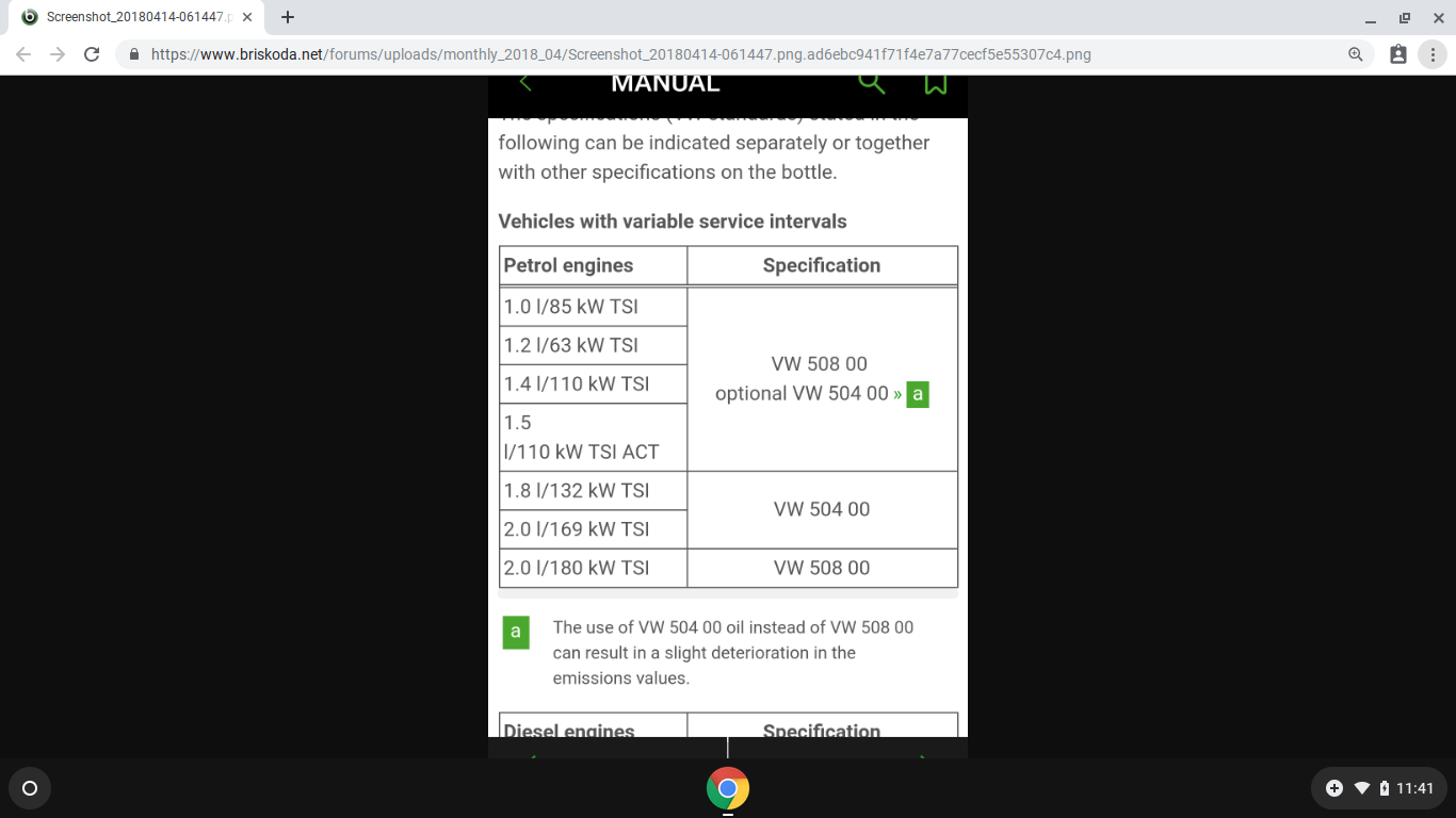

Out of curiosity, what oil did they use? The 2.0 TSI uses the same oil as all their other engines (petrol and diesel), so I'm curious to understand why they didn't have any oil at all on their premises? If it is indeed a different oil, does it say on your paperwork what grade it is?
Quote
Okay; on the invoice it says - N/STOCK Quantum Ultr
On the maintenance list it says - Replenished with standard VW 508 00 - which is what they didn't have in stock and they reckon it's hard to get hold of if I understood them correctly.
I think what they actually used was Quantum Ultra SN 0W-20.
The top up oil they gave me (which was in stock) is Castrol Edge Professional LL IV FE 0W-20 which is the same spec as the Quantum. They said that if I didn't want the Castrol I could use another make that's the same spec.
I told them I'd read that although the car comes out of the factory with 508.00 spec oil, some dealers refill with 507.00 at the first service. They told me they don't do that and stick with the 508.00 spec. That suits me as they've used and supplied me with the spec that VW recommend for my engine, so if anything goes t--s up it's not down to me. Hope all that makes sense.

Thanks, it is good to know that some dealers stick to the same 508 grade of oil that the car leaves the factory with, whilst others prefer to use the more generic 507.

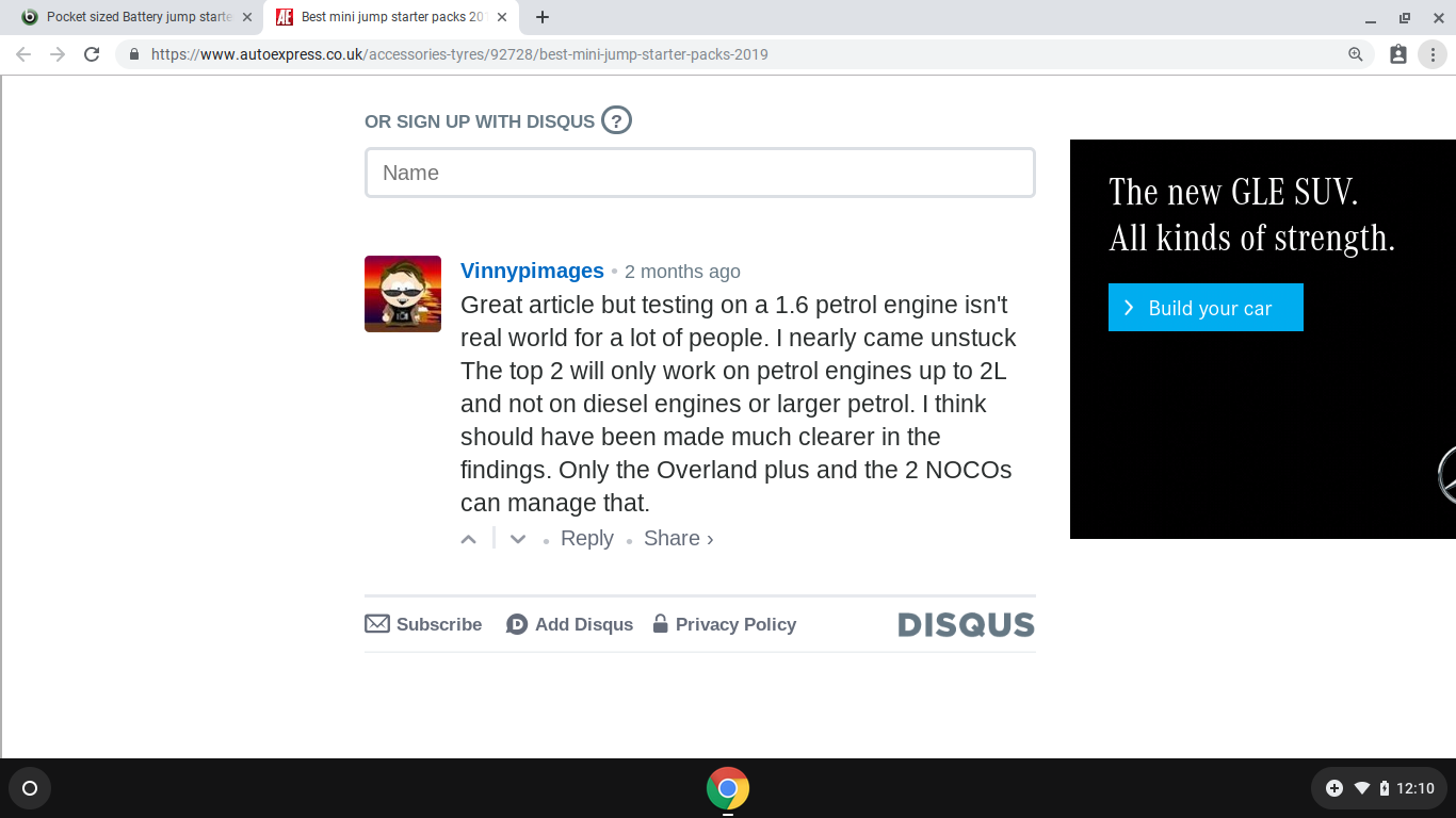

http://autoexpress.co.uk/accessories-tyres/92728/best-mini-jump-starter-packs-2019
See the reader 'Comment' about the article & 1.6 petrol,
& 2.0l or more or Diesels.
Jump Starters for emergency situations are hopeless if it will not start your vehicle or someone that you try helping to start theirs.

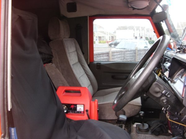

I needed this Power Pack Starter for my V8 LPG land Rover, and also to start lots of big capacity vehicles with flat batteries in cold weather.
I had one like that but it needed charging from the mains quite often which I always forgot to do and eventually it died. They only have a small motorcycle battery inside them and they're a bit bulky to carry around in the car all the time. I only ever used it once to start a car and that was for somebody else 🤨
