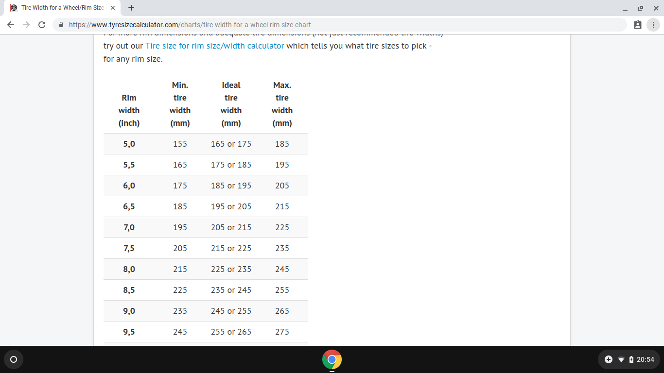

Hi, my 2018 Scout is fitted with 235/50/19. I have purchased a set of steel rimmed 215/65/17 winter tyres, l5QF601027A 6.5Jx17 ET38. I’m after some proper off road tyres for these not just winter tyres. What the maximum size I can fit on these. Thanks.

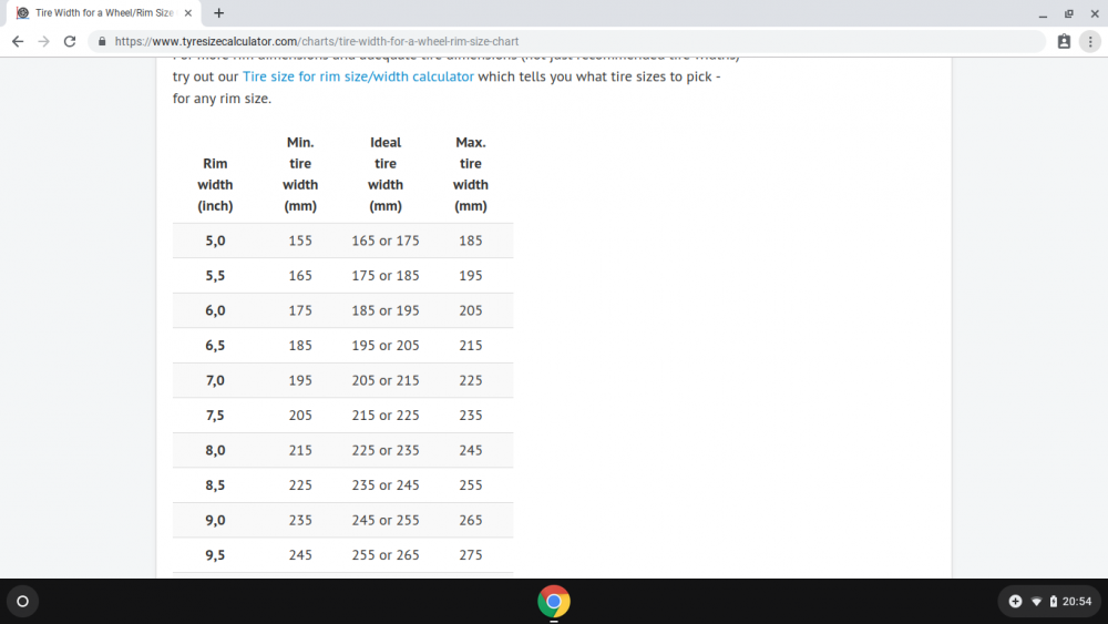

I would say on the 6.5J x 17 rims 205/70 R17   or 215/65 R17 with a Mud Tyre or a All Terrain to stay near the same rolling radius / Total Diameter.
***I would have gone for wider rims.*** To get suitable tyres for a Kodiaq going offroad.
http://kouki.co.uk/tyres/visual-tyre-size-calculator
Are you wanting taller tyres, do you mean to fit Mud Tyres or All Terrains?
What Wheel / Tyre Size is Type Approved for your Kodiaq if being used on the road?

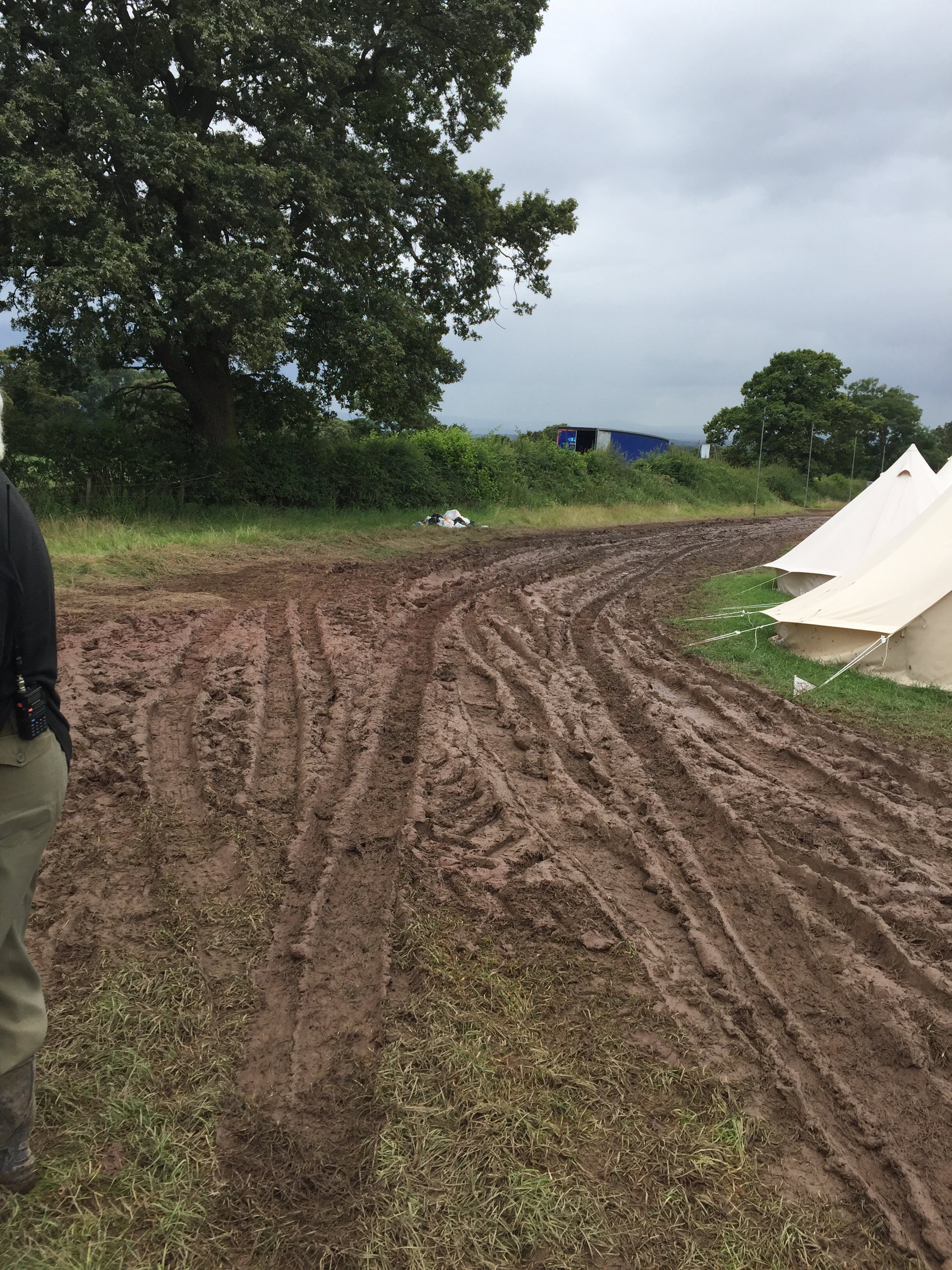

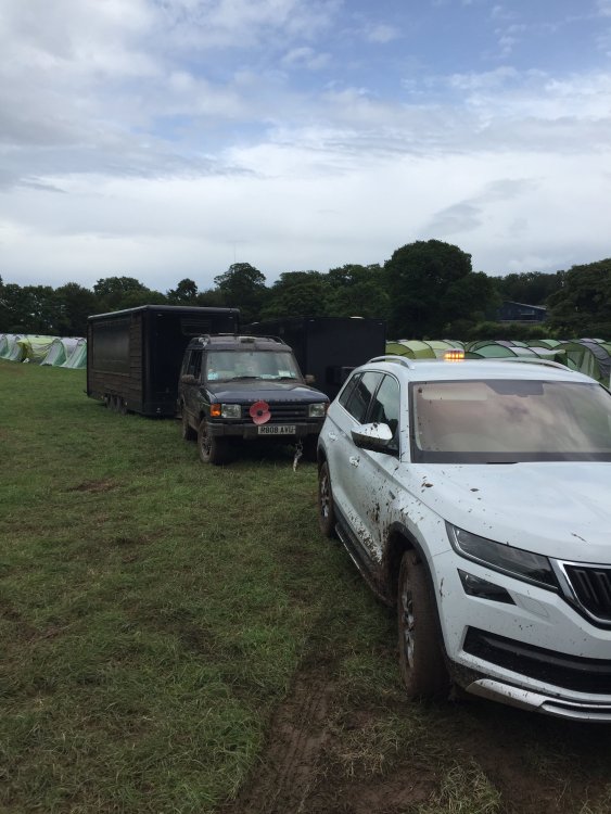

Thanks for the reply. I got them to fit proper mud tyres. With them being 17 not 19, I thought that I might be able to get a mud tyre, as they are not available in 19”. I am a member of a 4X4 response group and need a set of mud tyres. I was helping out at CarFest North last week towing stranded campers off etc and I was amazed at how well it coped with standard road tyres on it!!  I know you will most will shout wtf but it is a 4x4?  Lol2A63C4B7-8798-460D-961E-6AF72EF8E650.thumb.jpeg.b8ee0f8bafbaf984c220d47085b94a1c.jpeg52C78511-F2CA-48D5-8B24-EDE85D37BF12.thumb.jpeg.2bcd3a2a6d24db4f9b4f74d402fc8038.jpeg

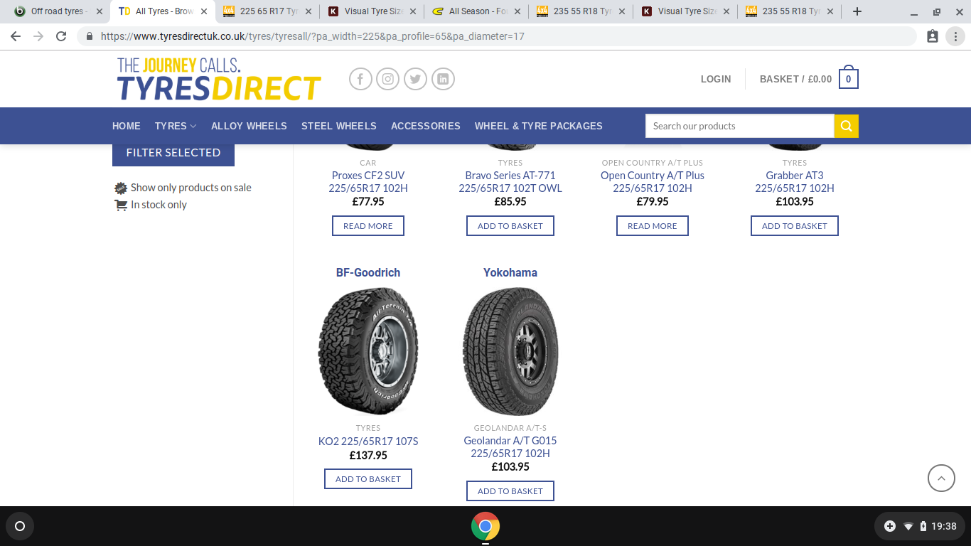

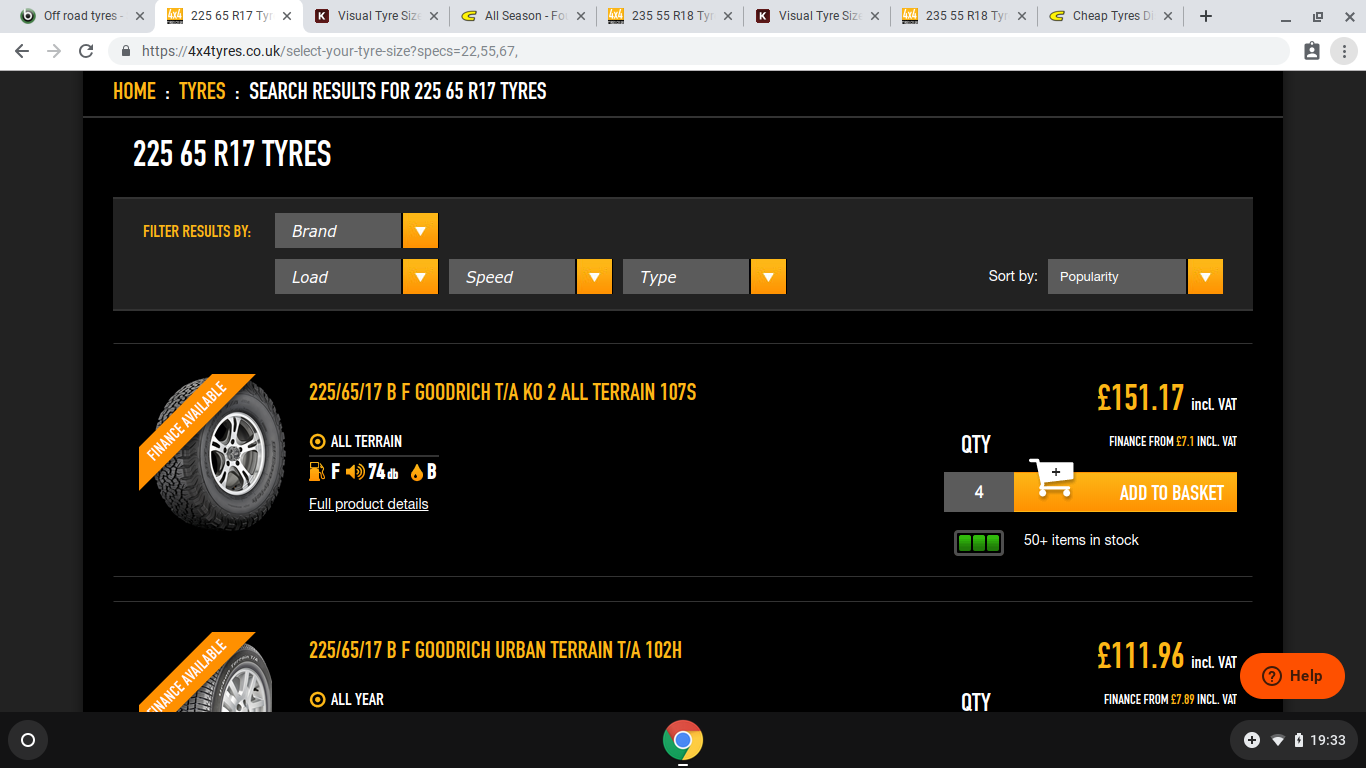

225/60 R 18 has a choice in tyres that would suit if you get 18" rims.  EDIT. Doh, not much showing suitable.
 Or wider 17" rims for 225/65R 17
http://tyresdirectuk.co.uk
http://4x4tyres.co.uk
http://camskill.co.uk

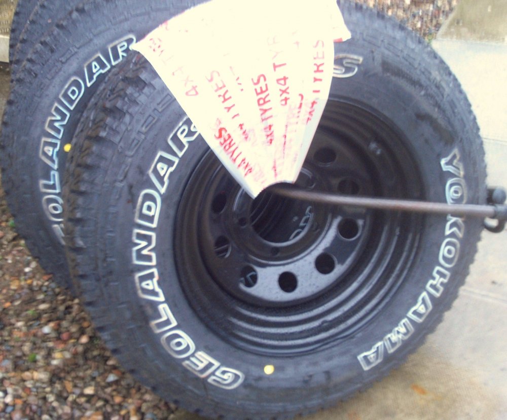

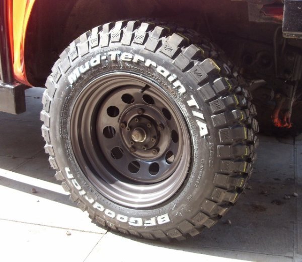

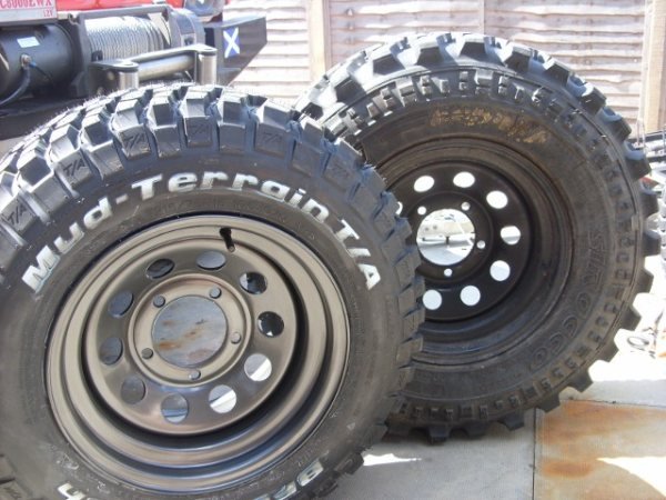

The Geolanders were OK without being Mud Tyres, well behaved on the road.
