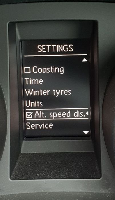

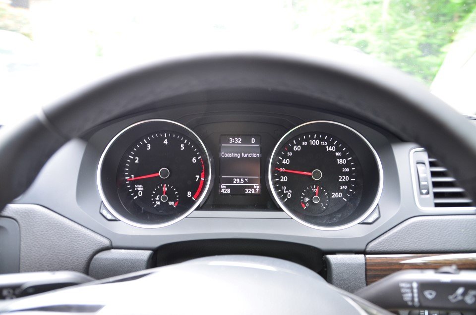

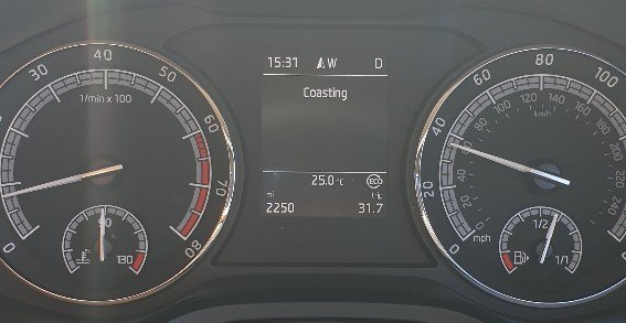

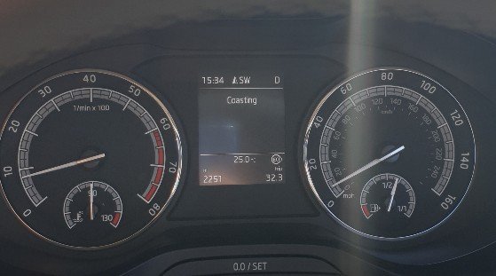

Time moves on, the use of words or terms move on and with some 2 pedal auto / automated manuals the fuel consumption using the tech can be better than the figures they get on rolling roads.
Coasting-Function-ON-on-display-YSK_0728.jpg.8f101451c1a76bc7659ac1451cc9c483.jpg.2c462952620f98529e7dd6fdd6da3be3.jpg

Simply it disangages the gears and coasts when drive is not required as happened when drivers took a manual gearbox car out of gear.   Just it happens seemlessly.  Touch the accelerator or brake and it is back in gear.  All legal and safe.
Point of it is fuel saving.
