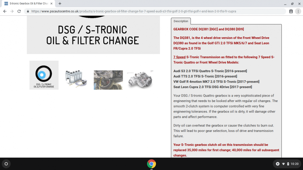

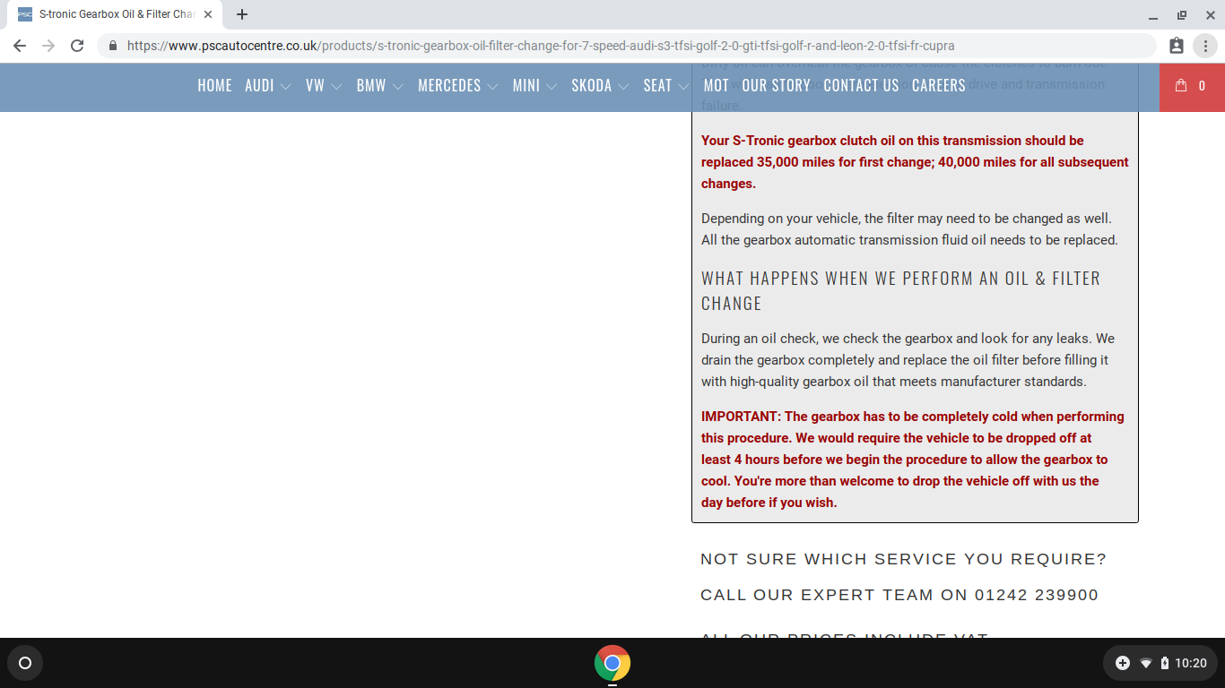

  Audi have always said 38,000 miles in the USA and then in the UK, and written it in websites.
Some Muppets at AUDI, Skoda, VW, SEAT even say 40,000 miles for DQ200's that have no Service Schedule. But then they only do this job full time, why would they know their arse from elbow.
Get it in writing about the 80,000 miles please.
http://skoda.co.uk/about-us/contact-us

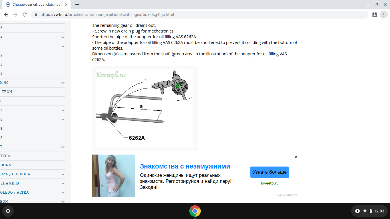

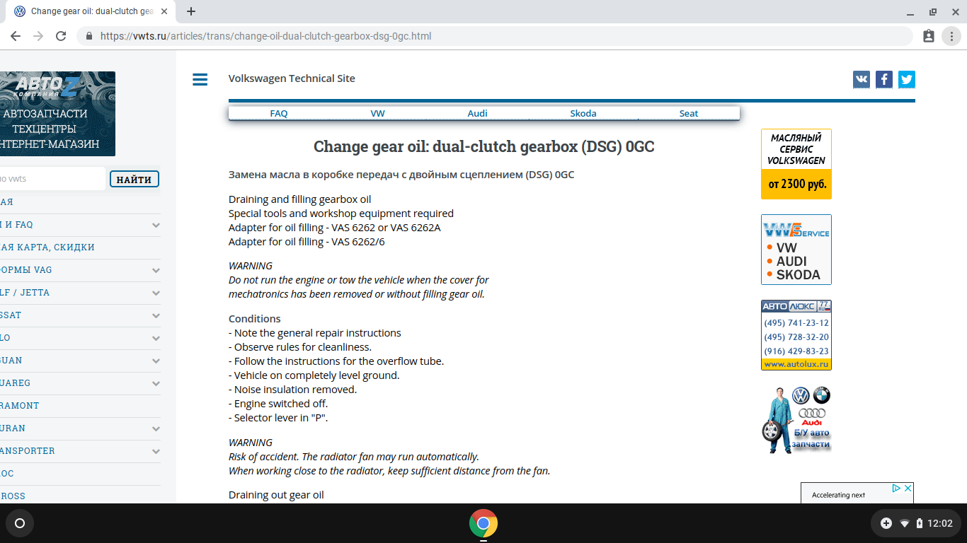

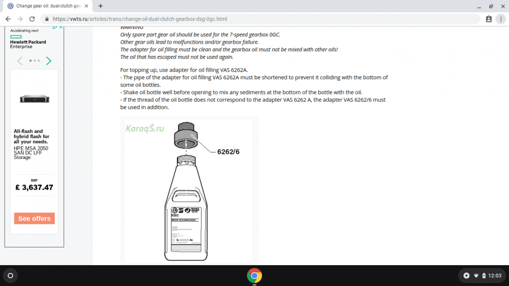

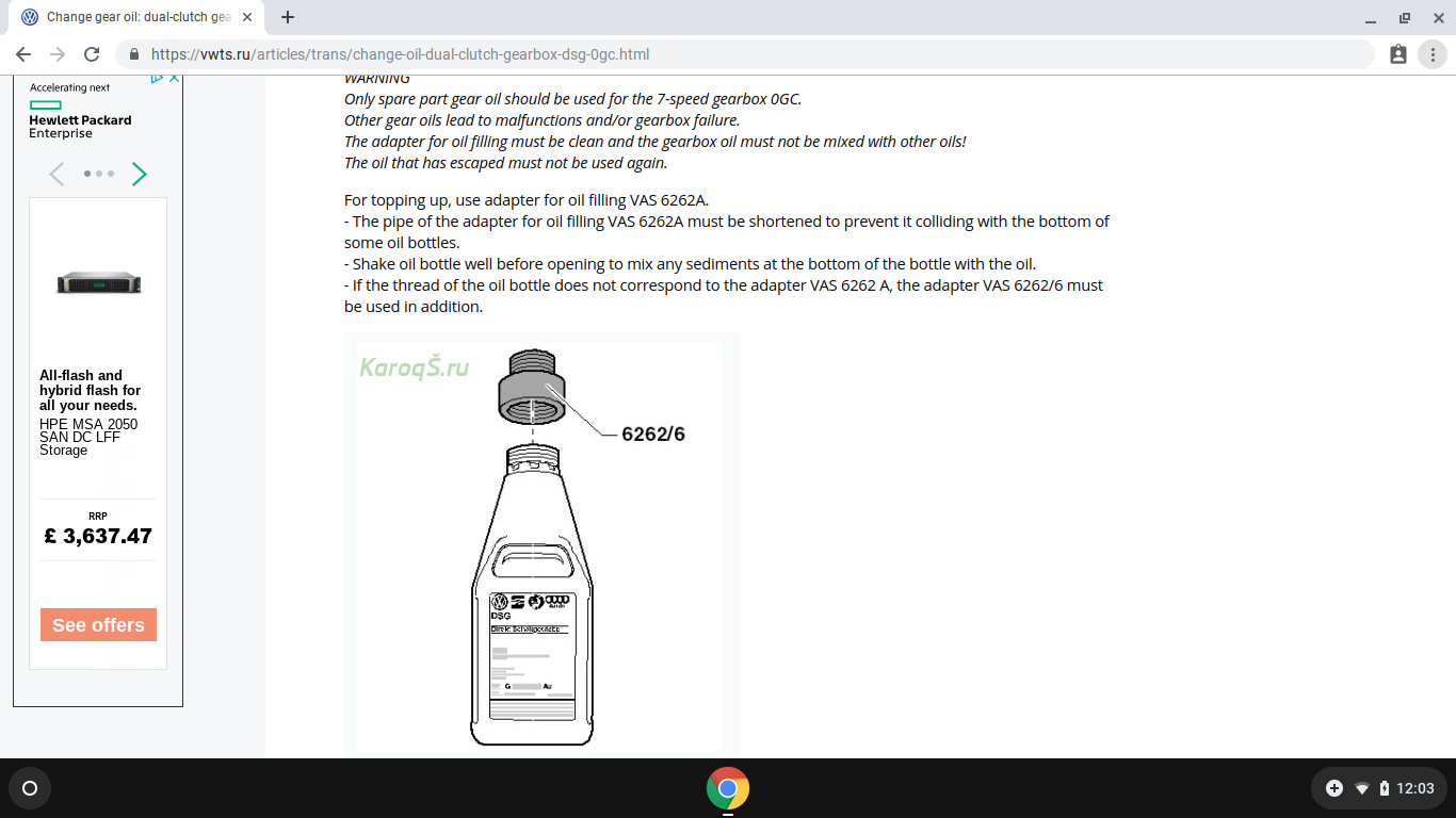

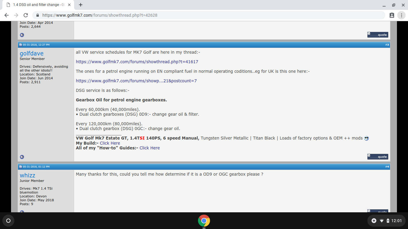

The service schedule that I downloaded from erWin 6 months ago states:
– Change oil, replace filter: 6-speed dual-clutch gearbox (DSG) 0D9 Every 60 000 km
– Oil change: dual-clutch gearbox (DSG) 0GC Every 120,000 km
As I understand it 0D9 is the old DQ250 and 0GC is the DQ381 used on the 4x4.  It doesn't mention the 0DE/DQ380, but I would be surprised if that differed from the DQ381.
Very interesting on the 0GC and not something i have seen before.   (I know how to do a DQ200 which was given no Service Schedule.)
Edited by Roottootemoot
