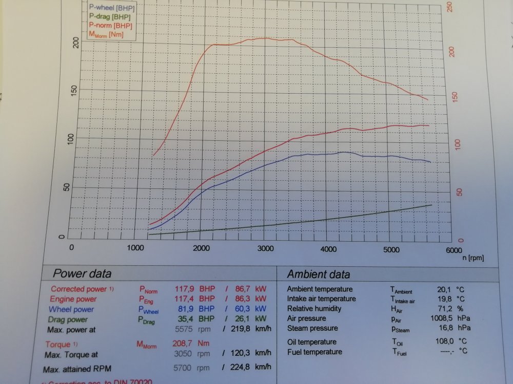

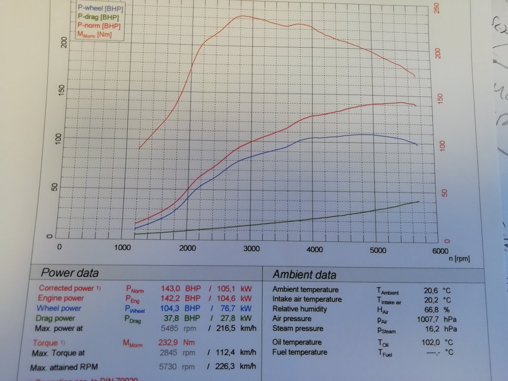

Please see before and after graphs.
Before 117.9bhp and 208.7nm
After 143.0bhp and 232.9nm
Graphs interesting. No doubt power curve is dramatically improved. However, torque appears to suffer between about 1400 and 2100rpm. This is exactly the range that I use day-to-day (in my 1.2 TSi 110), so reckon I'd have to drop a gear. I don't suppose there are any comparative curves (i.e. on same dyno) for unmodified 1.0 versus 1.2?
the difference low down looks negligible, its more when you open it up it has more power, up the rev range I guess.

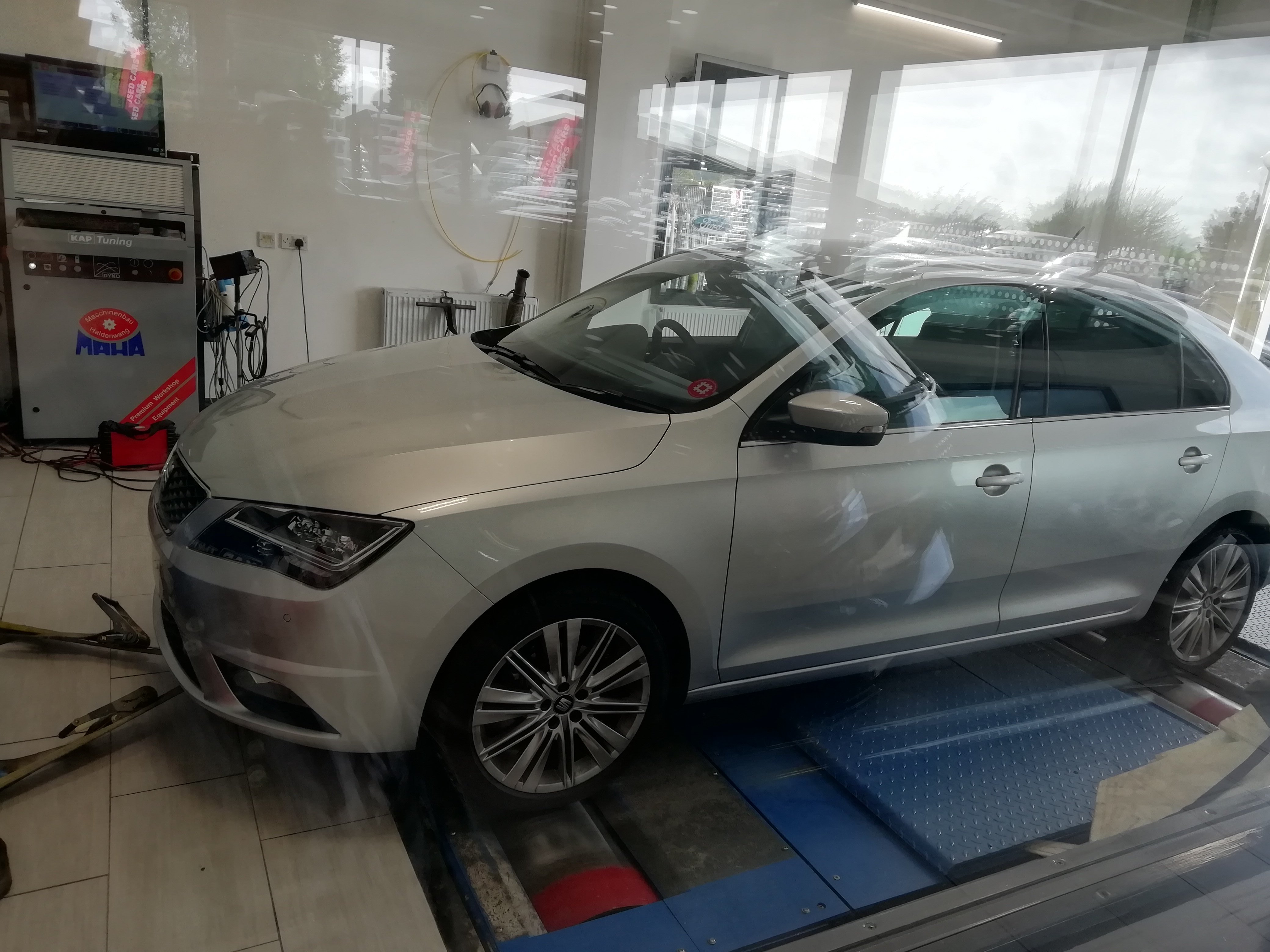

I've got a 2018 Seat Toledo 1.0tsi 110bhp with a manual gearbox and I have just had it remapped by Angus @ Kap Tuning in Folkestone. Angus has mapped 2 of my previous cars to great success so I trust him implicitly with my cars.
The car has done just 7,500 miles so it's still quite low mileage, it's only ever ran on V Power so I hoped the standard power would be healthy, or at least the 110bhp from factory.
On to the rollers and after some health checks Angus made a base run. It made 117.9 bhp which I was very pleased with as its completely standard. It goes to show that better fuel does yield better power.
Angus studied the dyno graphs and pointed out that there was a boost drop off at 3,500rpm which was holding everything back. He spent and an hour or so re-writing the ecu and making his adjustments.
After all was done he made 2 power runs. The first run yielded 140bhp, a good improvement. The second and final run made 143bhp, a significant improvement over standard.
The result is a much happier car, pulling well through the rev range. It's never going to be 'fast' but now at least I have released its potential.
I will post the graphs up if people are interested to see them.
