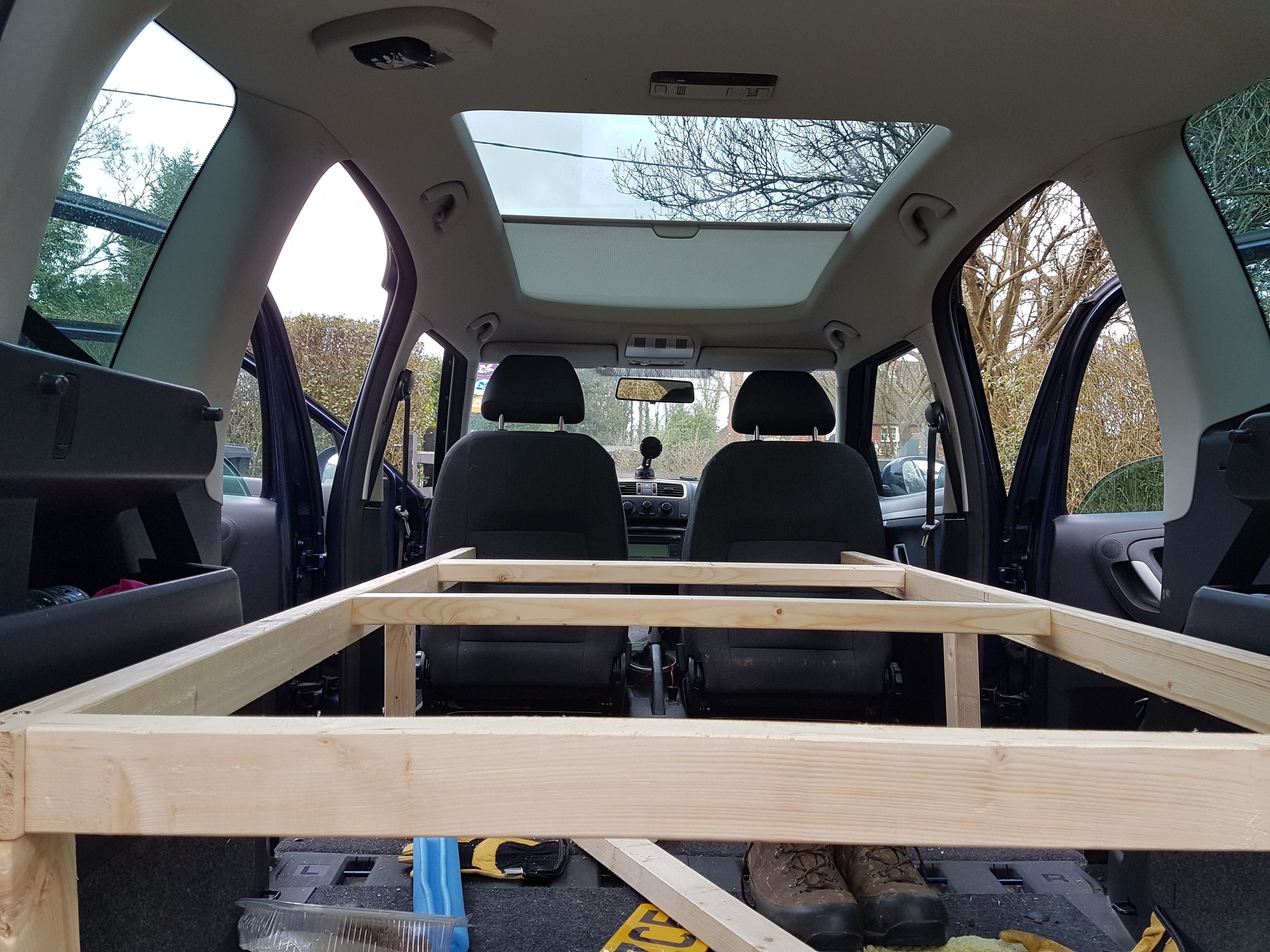

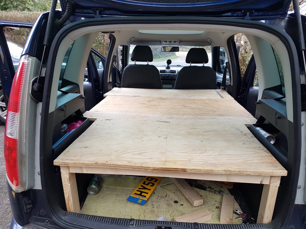

I used whatever wood that was available and made a basic frame. The rear part hinges to access storage and the front part folds down once the front seats are moved as far forward as they will go. It makes for a reasonably comfortable space. I made insulated blackout curtains from a foil bubble insulation material and these fit with velcro. I have been away since March and although do have a tent i have spent some time in the roomster.

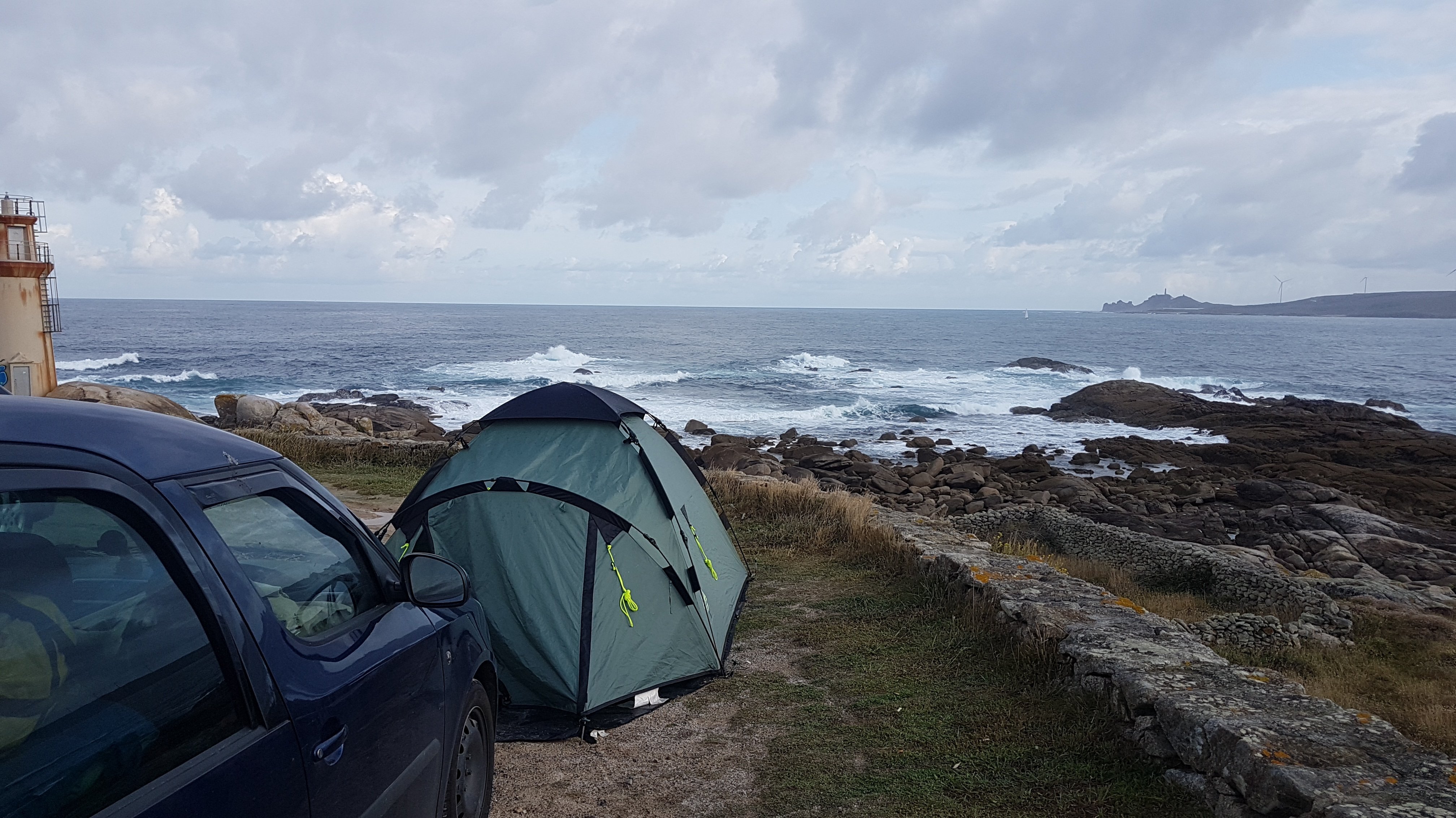

The plan was to have no plan, decide on the day where to go and so far has been through France, Italy, Greece, back through Italy, France, Spain, Portugal, Northern Spain and on to France again. Currently in the Alps...
I use a tomtom app on my phone for navigation and usually set it on winding routes. These have been interesting roads and I have done many offroad miles.

Am really interested and inspired, can you please post some more pictures in particular one with the front section folded back and the rear seats upright and also folded forward.
