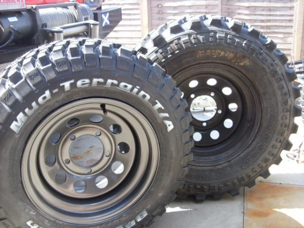

A set of BF Goodrich All -Terrain T/A KO2 if you can get in your size,
or similar AT's.

I have used KO & KO2 in Snow and Forest Tracks in Scotland and they were OK but they are not Snow tyres.
Also had older AT's and Mud tyres from BF Goodrich, only puncture was with the Muds in an Asda car park.
I have put Michelin CrossClimate SUV's on for this winter on my Shogun not BF Goodrich & will be doing some forest and windfarm tracks,
i will see how they do as they are wide at 265, but the standard size is 285, but if needs must i would put chains on the CrossClimates on hillsides / tracks.

16 hours ago, Roottootemoot said:
Even Gravel Rally Tyres can get punctures, so you are as well to get a pair of spare wheels and tyres and carry a trolley jack.
Maybe best get a nice easy to fit & remove set of snow chains or grippers as well.

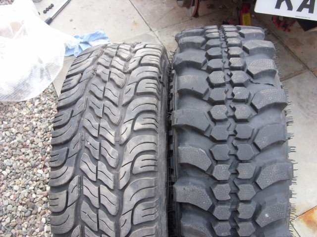

I have used some very good M+S tyres over the years that were not 3 peak rated,
used some 3 peak rated tyres that were neither good in Mud or Snow,
I am a rubber fetishist.
The Avon Snow tyres i had on last winter on my Alhambra were very good and i put up a thread and another member had a terrible experience with them.
They would likely suit your use. I had them on until it was time to put the car back and i have not yet and really should have them back on.
**Been up and down a good few miles of Wind Farm access roads and forestery tracks.**
I just have the chains or grippers with me in case needs must and tracks are maybe steep, iced and off camber.
http://briskoda.net/forums/topic/459700-wv7-snow
These were cheaper M+S tyres i had for a few years and they were great, but then tyres change, and prices now seem not that much increased from in the past.  I dont buy because of price but because of what works and if they do not work they come off.
