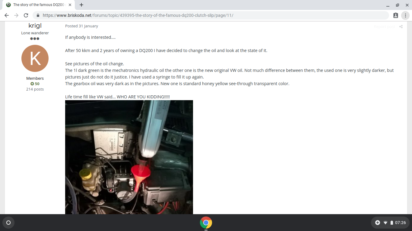

From Page 11 of Famous Clutch Slip thread in Mk3 section.

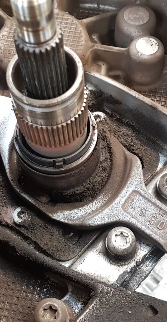

The DQ200 is serviceable however I wouldn't be torqueing it open unless there was a problem, A recent problem to come to light with the DQ200 as it ages is a build up of clutch debri's causing selection issues which requires the box to be opened to clean.
