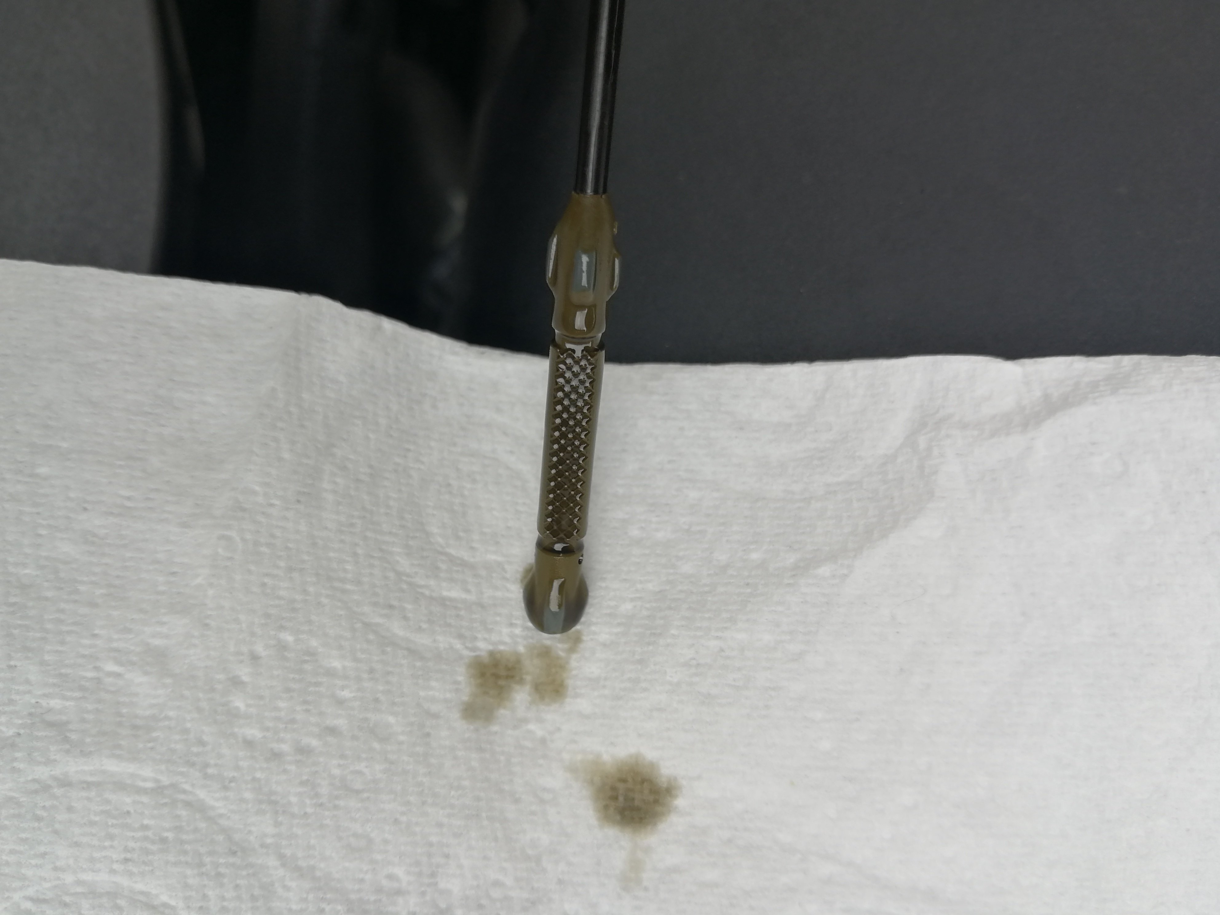

After Oil change servicing my car Chokes,shakes and make some strange noise when starting for the first time.
I had my interim oil change servicing after 11k of Major servicing. So,when i started the car following morning it was shaky,struggle to start and was choking. Throughout the whole day there was no problem other than unusual engine noise,but if it is left for 24hours it behaves the same. It never happened to my car before. Today  i checked the engine oil and it looks very plain and clear brown to me which is normally used for petrol car.
Servicing was done in Skoda dealer though.
Could somebody advise me please. Its really freaking me out.IMG_20190915_122341.thumb.jpg.d26c9c7fa4ad8d622b17bd0d6ac407ef.jpg

But do you think this oil looks like diesel cars oil.

They all look like diesel oils. diesel oil does not look different.
The Oil main dealers use is the same if a TSI or a TDI, VW 504 / 507.   The 507 is the spec the diesel / TDI needs.
Sometimes within a few miles a TDI's oil can look black, as before the oil change, yours happens to still be clean.

But I have never seen such brown colour of diesel car's engine oil. I had last service on April'19 and that engine oil was also blak-ish. couldn't find what oil they used from the invoice.

2years ago i bought Total Quartz Ineo 5w30 for my 63plate octavia..oil looked very dark to me.
Is Diesel car's oil not different than Petrol car? mileage of my car is 102000 btw.

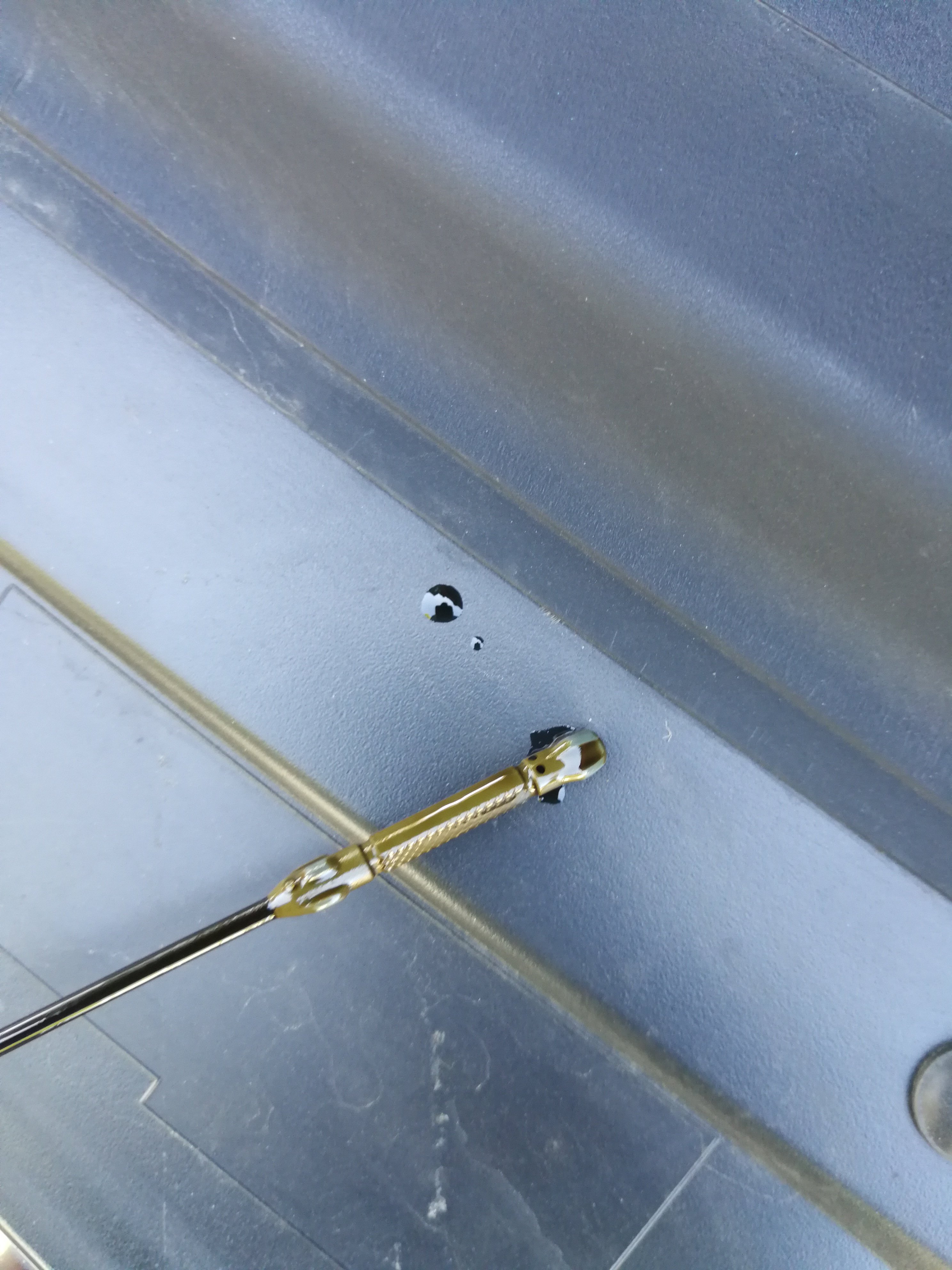

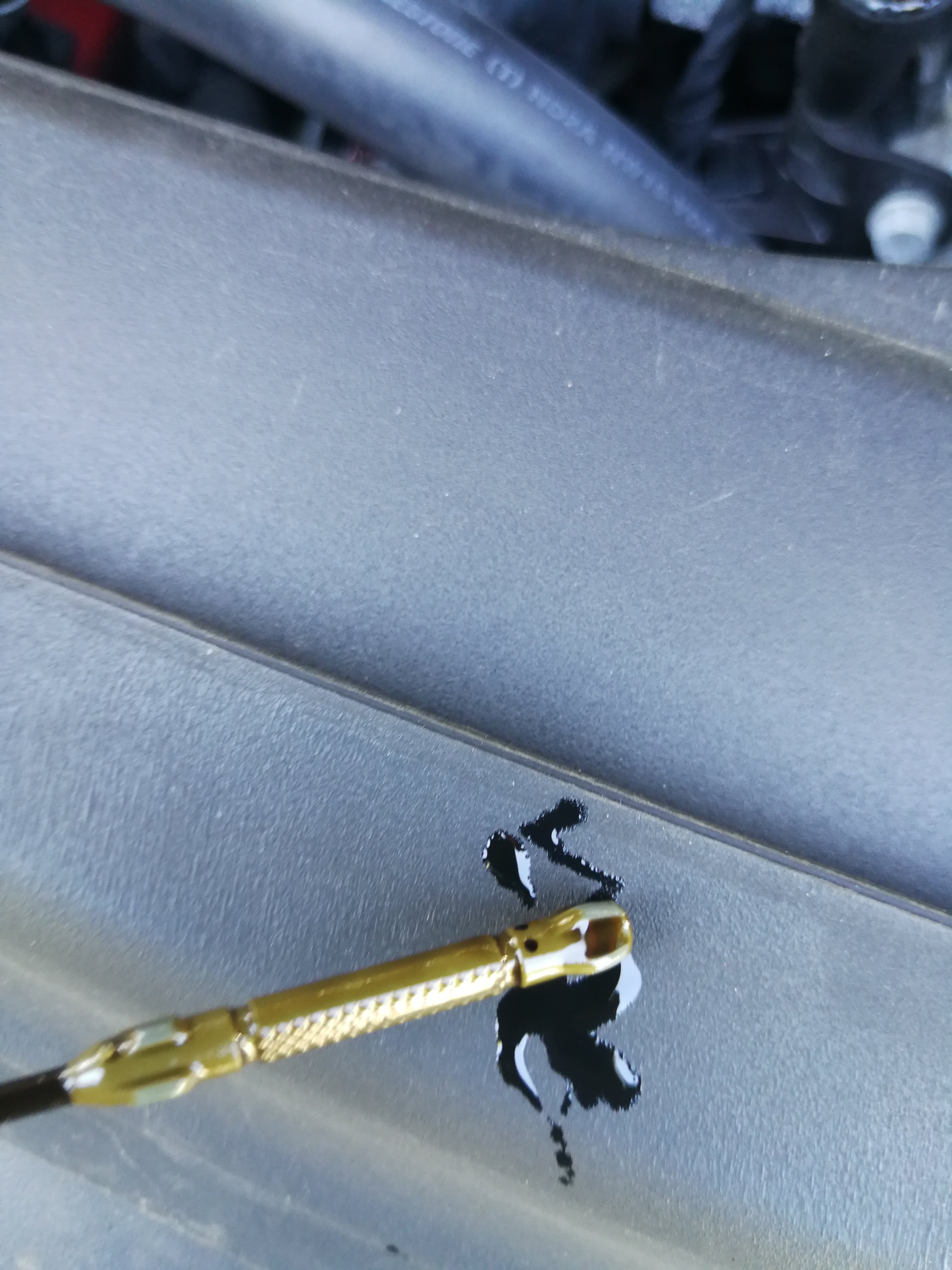

No one else has mentioned this, so I assume I'm wrong, but are those photos not showing oil far too high up the dipstick?
I am not too sure. But car was driven 15minutes now and parked in a level place. I'll take the proper measurement and will upload the picture. btw, this morning again car was choking and engine was making knocking sound. I was afraid car was gonna stop, but it didn't..it was jumpy and shaky at the beginning around 200meters. then it came back to normal operation..VERY UNUSUAL.
Edited: it looks like oil is bit too much. I mean more than the mark.
Edited by automass
Its hard to tell from the photos but if the oil level is high then take it back to have some removed. Btw, the "cleaner" is screenwash, so hopefully not used to flush the engine!

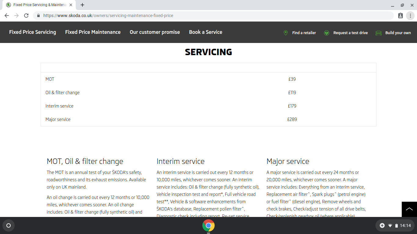

I think they’ve done an interim service costing £169 fixed price, that would be £117 shown as labour, £23.37 shown as oil, then 20% vat.
They just put whatever numbers it takes to make the total correct. The cleaner will be injector cleaner.
I suspect that “cleaner”, chucked into the fuel tank of a car with over 100k miles, may have dislodged some carbon which is causing the faults, especially if the tank was low on fuel, as it should go into a full tank.
Difficult to start, engine shaking, knocking noise all are symptoms of diesel injector problems.
Cheap fuel cleaner then or as you say just fictional figures.
Oil service is £119.
