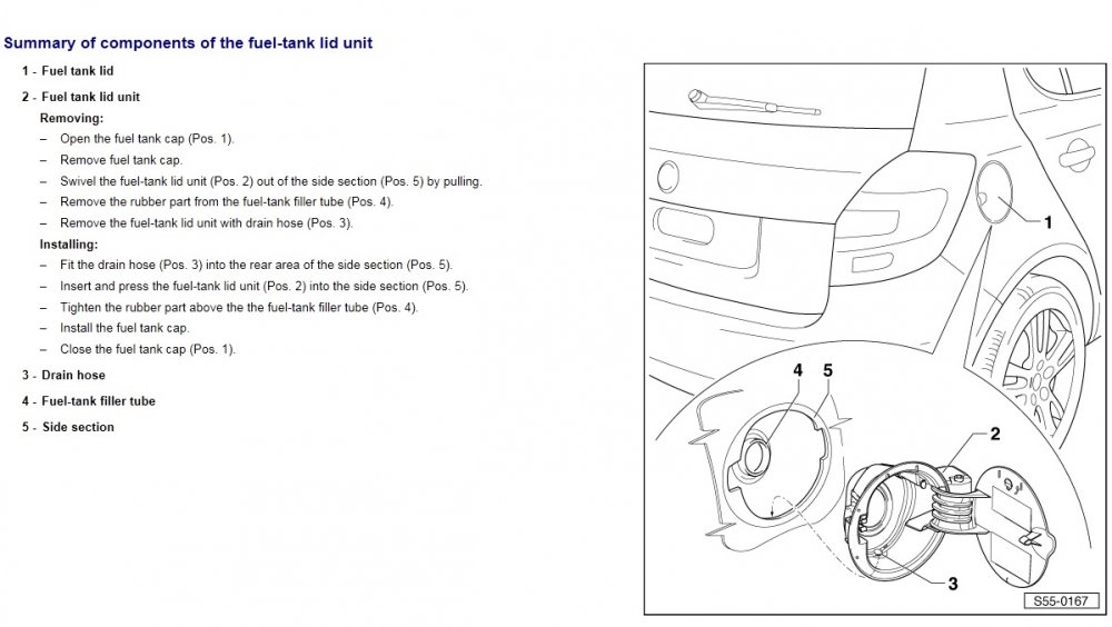

From this diagram for a 2013 model it looks as though there's a bung in the upper side of the filler "tube" and which may be hiding a fixing screw or similar.
Hi,  I have seen this diagram,it looks like the bung shown is under the filler insert, their are no holes in the filler housing rubber on the old one or the new one, I can not find any information about fitting and removing the one I have.
You remove the cap and then rotate the unit inside the body and then withdraw.
Hi,  that sounds good will give it a try and let you know.

I am currently trying to do this but it won't budge. I thought there may be a screw in 3, but it's just a hollow hole it seems. I'm trying to repair a broken flap. But may have to replace the flap as it's snapped to the hinge.

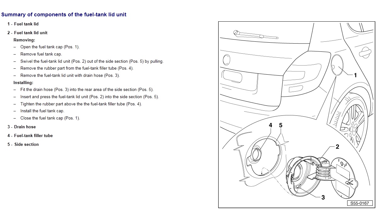

here it is with the text................it "sort" of makes sense..............
it says "swivel"................I think it means "wiggle" (german language translation) as the 2 key ways shown in image would not allow it to swivel, so I think its "wiggle and pull"
Edited by UrbanPanzer
That's better. Than you
That looks like removal of the whole flap unit... I know when my MOT guy was doing a little work for me, he lopped off the cap in seconds and it was just the opening flap. So quick though, I didn't see how it was done but if need be, I could try asking him.
I have managed to glue the flap on in situ using gorilla glue. It seems very secure but if it comes off, which I doubt it will, then I'll go back to plan A and buy a new flap and replace it 👍
Thank you for everyone's help. The pic with the text will definitely help
