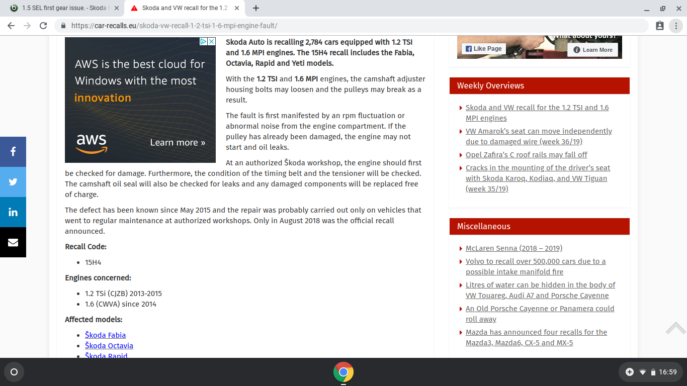

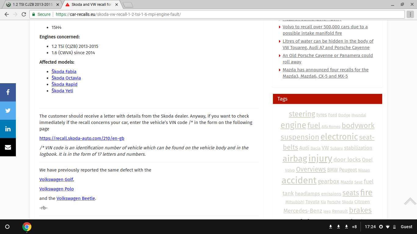

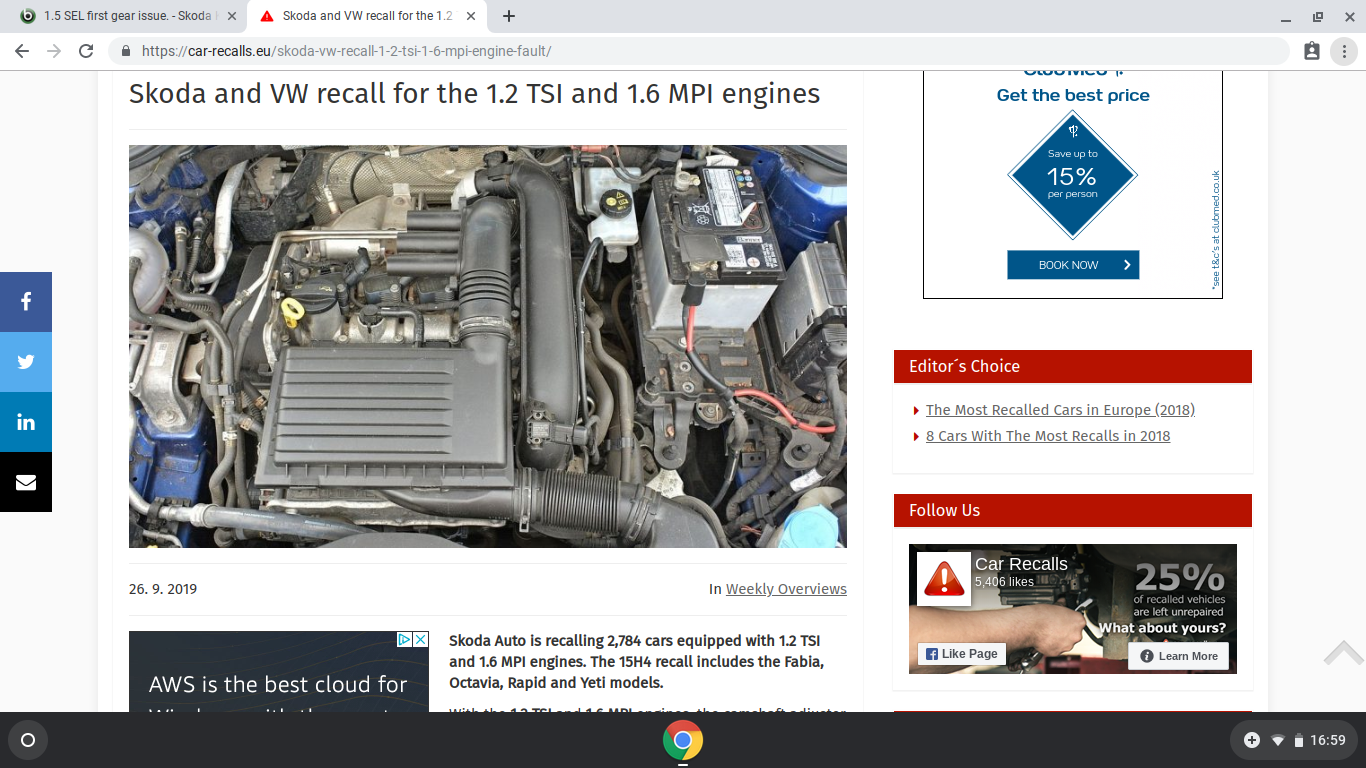

Spotted this today.
Some 1.2 TSI / 1.6 MPI.
Fabia,
Octavia,
Rapid,
Yeti
 known since May 2015  'recall code' 15H4'.
So that will be yet another Skoda Secret Service Campaign.  on a need to know basis and 'you dont need to know!'.
'ONLY IN AUGUST 2018 WAS THE OFFICIAL RECALL ANNOUNCED'.  silently!
