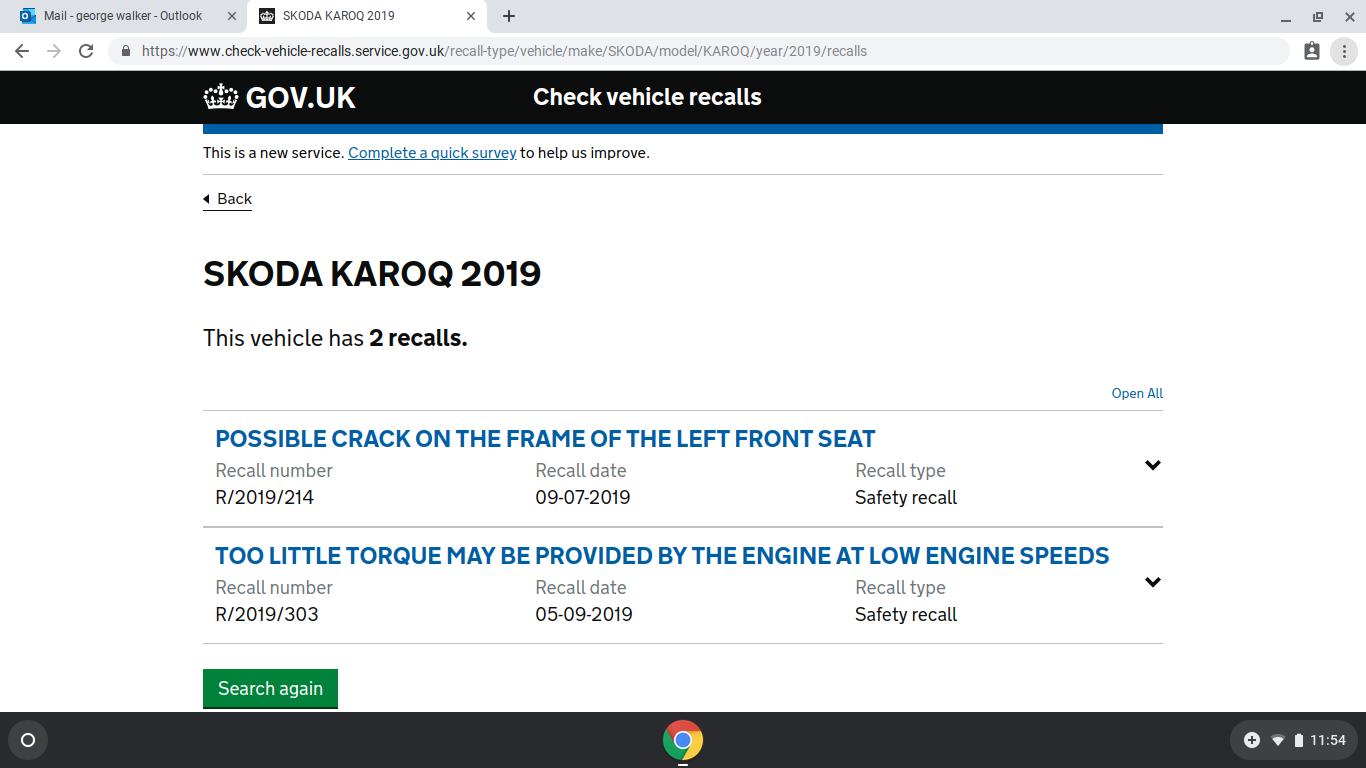

I found a recall site but it just said there was a recall, but no detail like in Peon’s post.

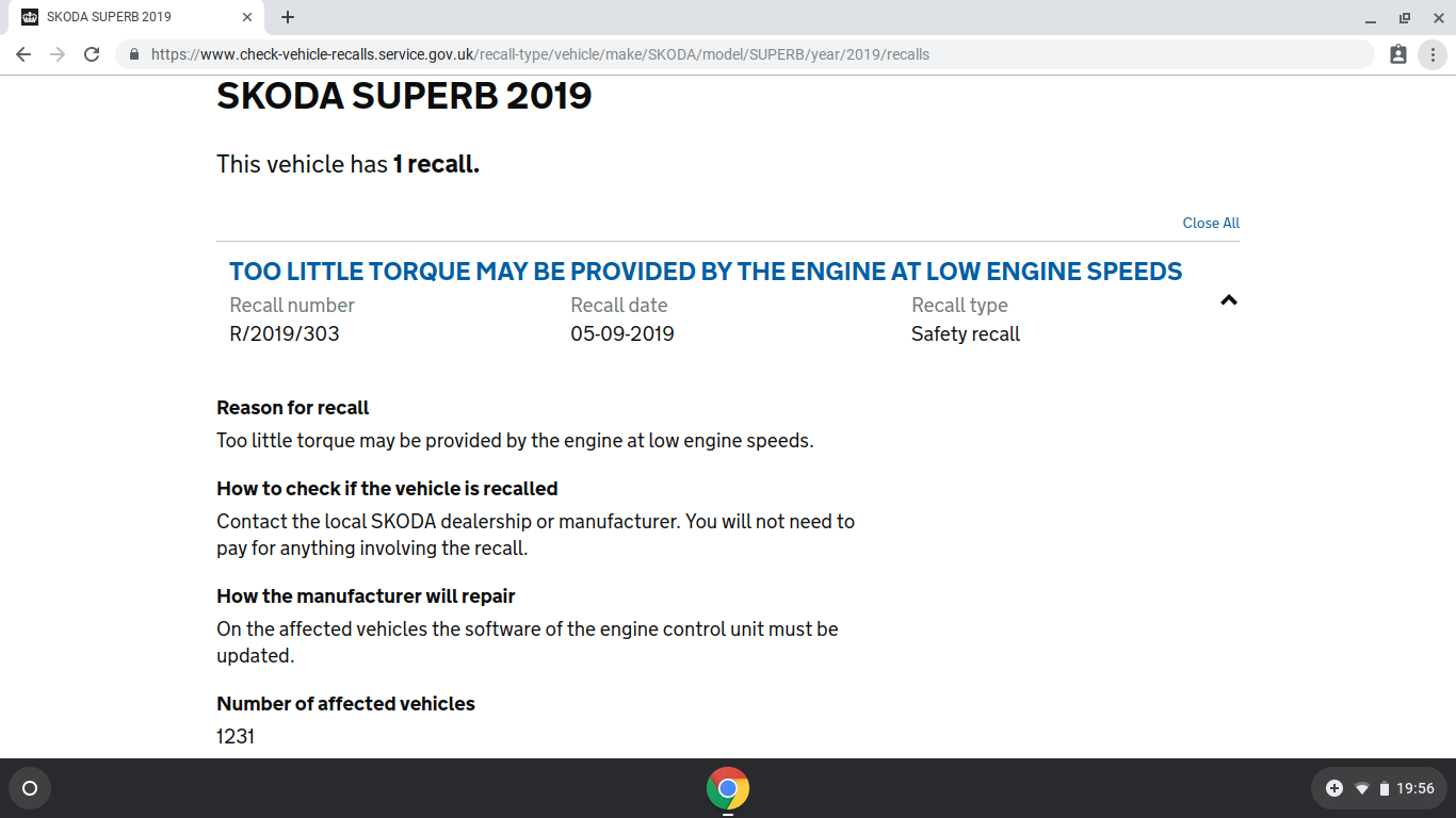

When I visited https://www.gov.uk/check-vehicle-recall and entered my reg, it told me there was a recall with no details given. I tried again without the reg but supplying the model and MY, and I got more info...
UK / DVSA Safety Critical Recalls are Recalls, and find out what they are.
They are Safety Critical and Registered Keepers should get a letter.

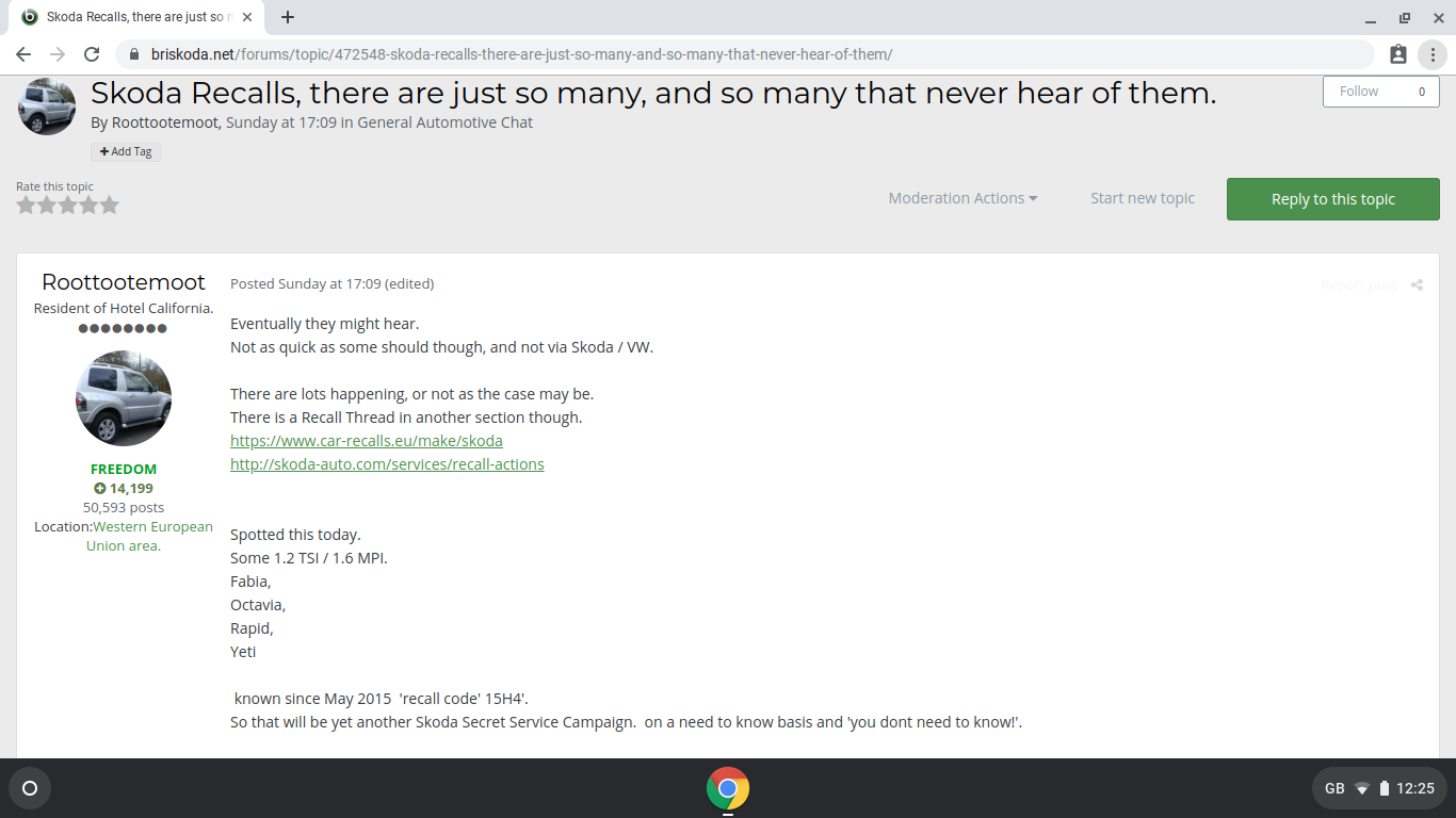

Recall Actions / Service campaigns and VW / Skoda Secret Service campaigns are different.
Lots of Recall Actions, lots of Service Campaigns, and many being missed.

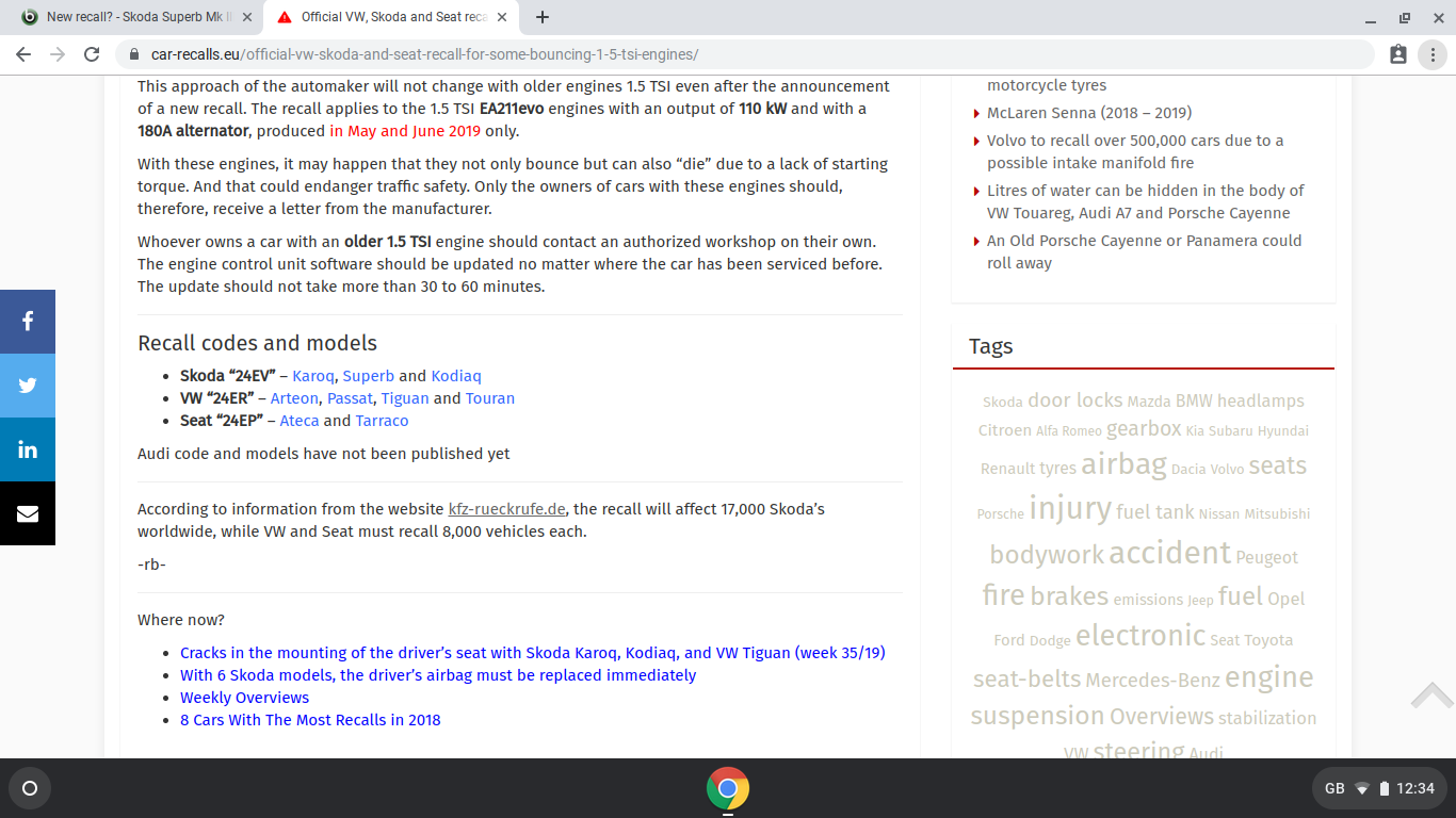

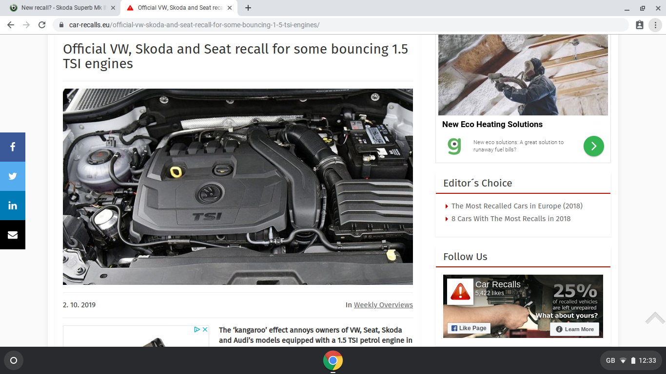

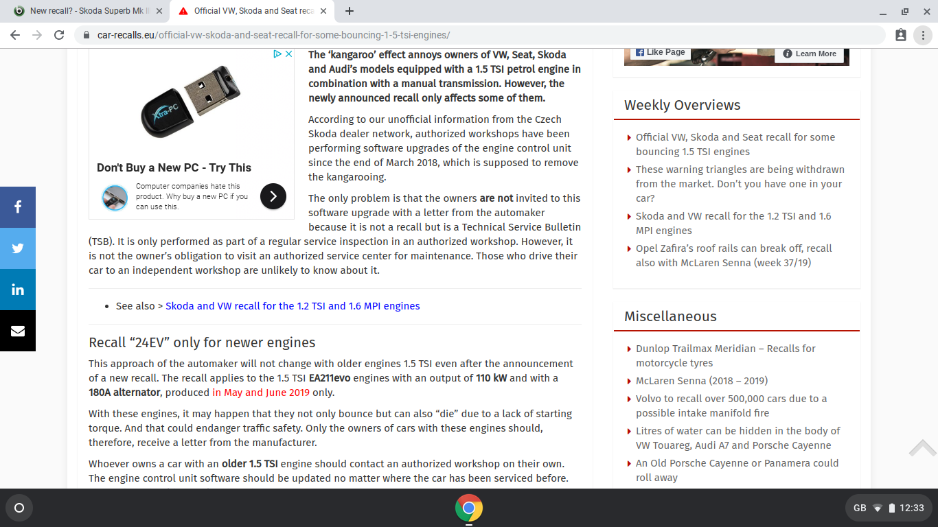

http://car-recalls.eu/make/skoda
https://car-recalls.eu/vin-check-recalls/skoda
http://skoda-auto.com/services/recall-actions
Edited by Roottootemoot
So.  Is it Recall or a Recall Action?  Depends if you get a letter.

@AndyN1975
Was that a letter from Skoda / VW Uk on a Recall Action and the one showing on the DVLA website?

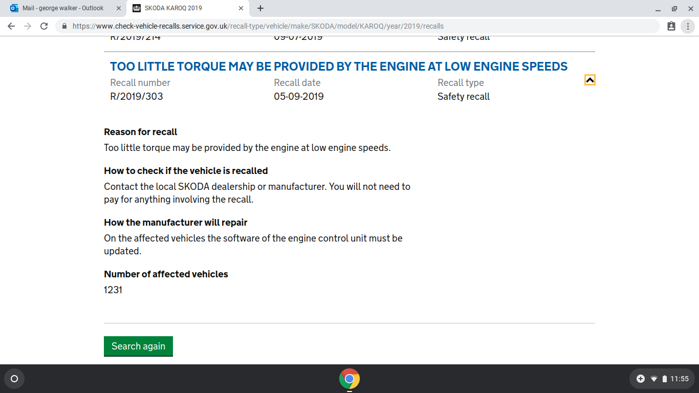

Strange that they show on Superb, Karoq, Kodiaq and Octavia and whichever they all show as 1231 possible affected vehicles only.
2018 & 2019.
Yes, It was from Skoda UK. Described itself in the letter as a safety recall and that they got my details from DVLA. Text about too little torque fits with recall on DVLA site.
