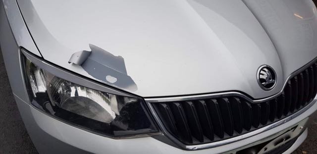

A month ago what I thought was a stone chip turned into 6-inch flap of paint peeling away from the car bonnet. As the car was now out of its 3-year manufacturers warranty. I duly booked the car in with a local paint specialist to look at. They advised the top layer of paint/lacquer was not adhering to the base coat and the entire bonnet would need be stripped and re-sprayed (cost £300 inc Vat). I took photographs of before/after and contacted the garage that sold me the vehicle. They suggested I contact Skoda UK. Skoda UK has said that they are unwilling to help as a third party carried out the repair. Yes in hindsight I should have taken the car back to the Skoda dealership 35 miles way to examine.

As a side issue - at the paint specialist was a Skoda Octavia in the same colour (not so Brilliant Silver) with the same peeling paint issue. Is this a known Skoda issue?

Has the paint been tested to see if as left the factory and that is not a replacement bonnet painted?

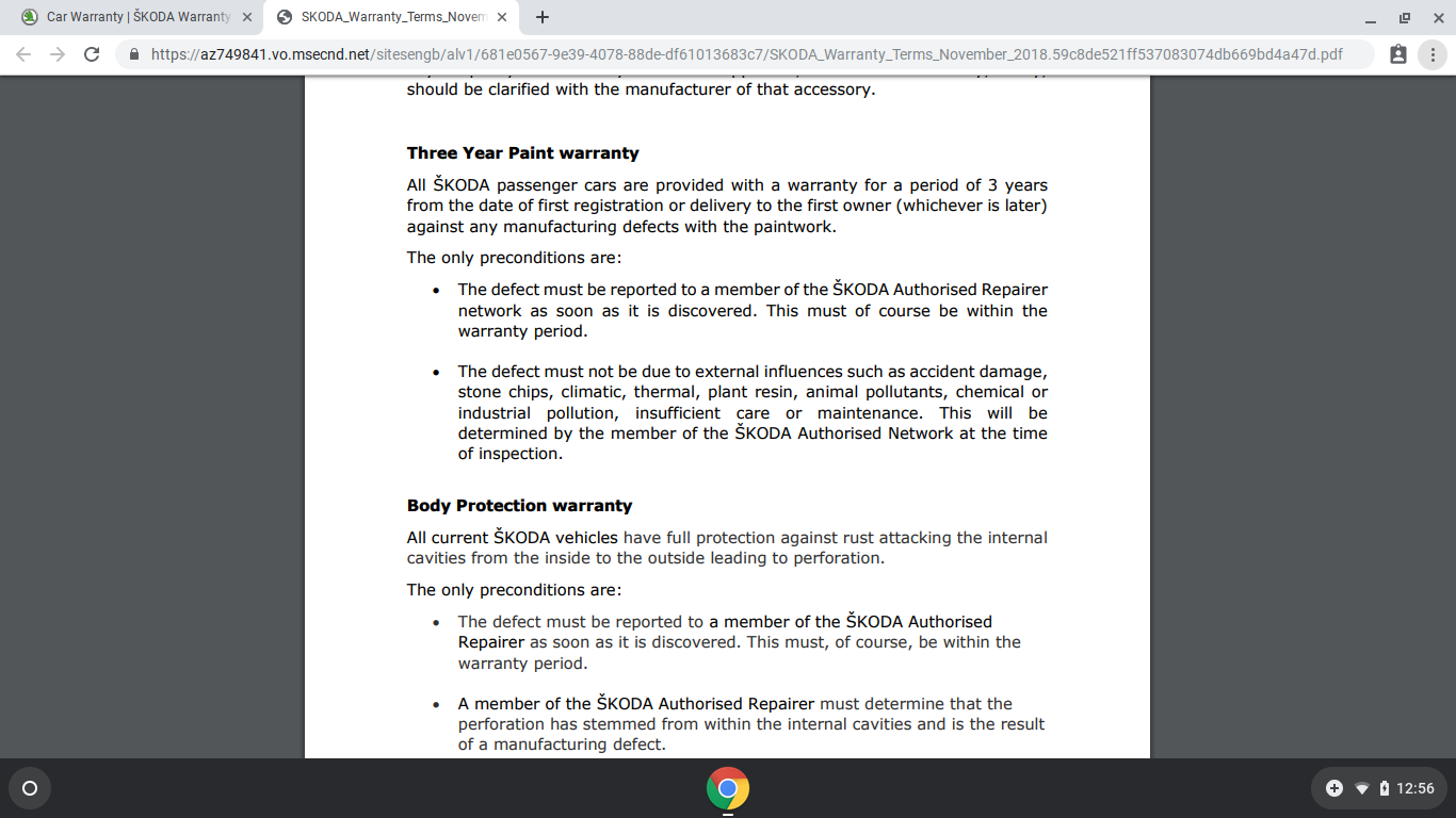

Your Paint Warranty tells you to contact an Approved Repairer, that actually means a Skoda Main Dealer.
You do not contact Skoda UK Customer Services,
their employee gets the pictures, gets the warranty manager, they contact Skoda UK / Warranty Provider, and they arrange an Inspection by quilified people,
that might be a Body Shop, it might be the firm they contract.
When i was an Apprentice Sprayer i had to deal with the first of Silver peeling paint Fords.
