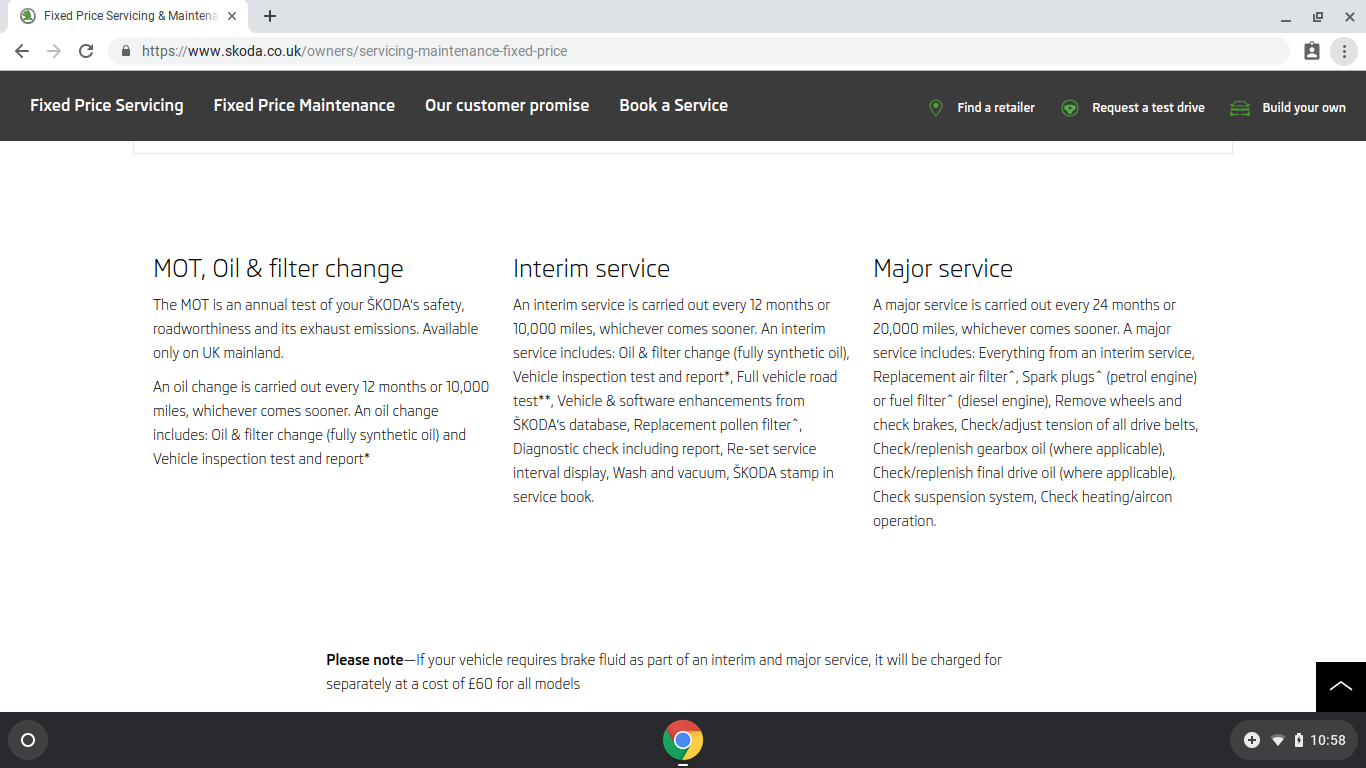

http://volkswagen.co.uk/owners/servicing/regimes
Offer on cars 3-10 years old on Fixed Service Intervals, at participating dealers, and these can cost less for the same or more done at non participating / p!ss taking dealerships.

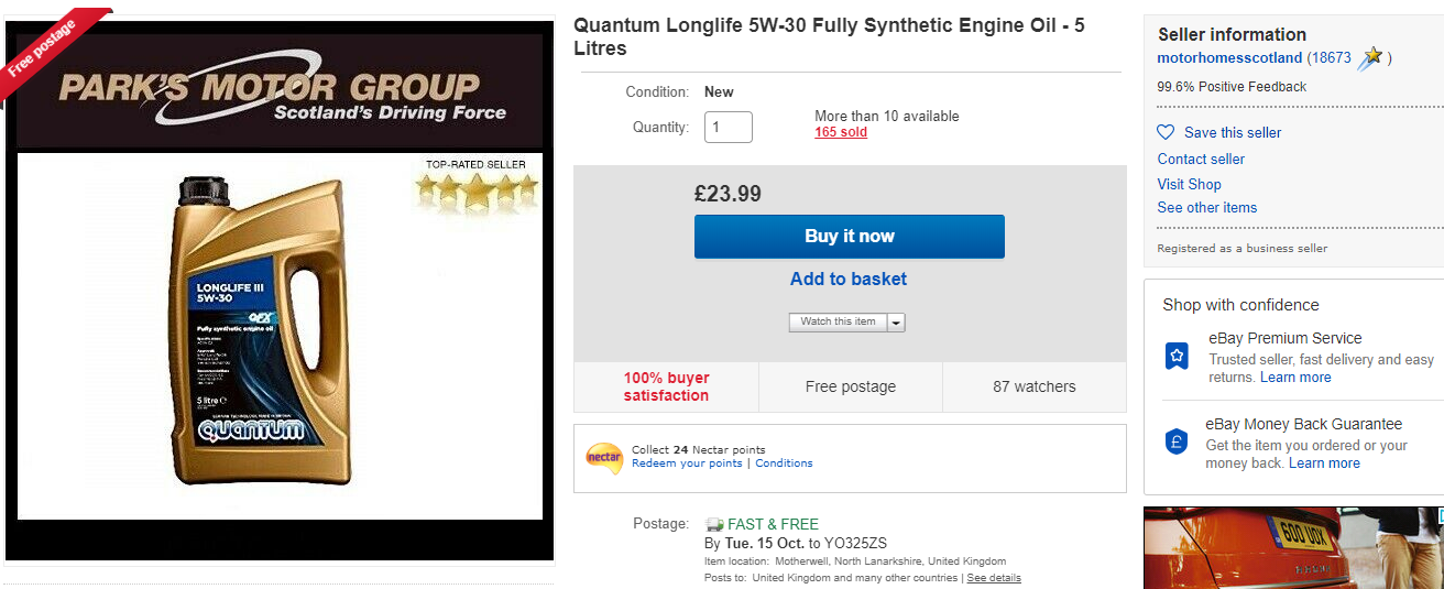

You'll find either Castrol Edge or Quantum III (Fuchs) in main dealers.
5 litres of Quantum delivered direct to your door from a Skoda main dealer for less than £24...
