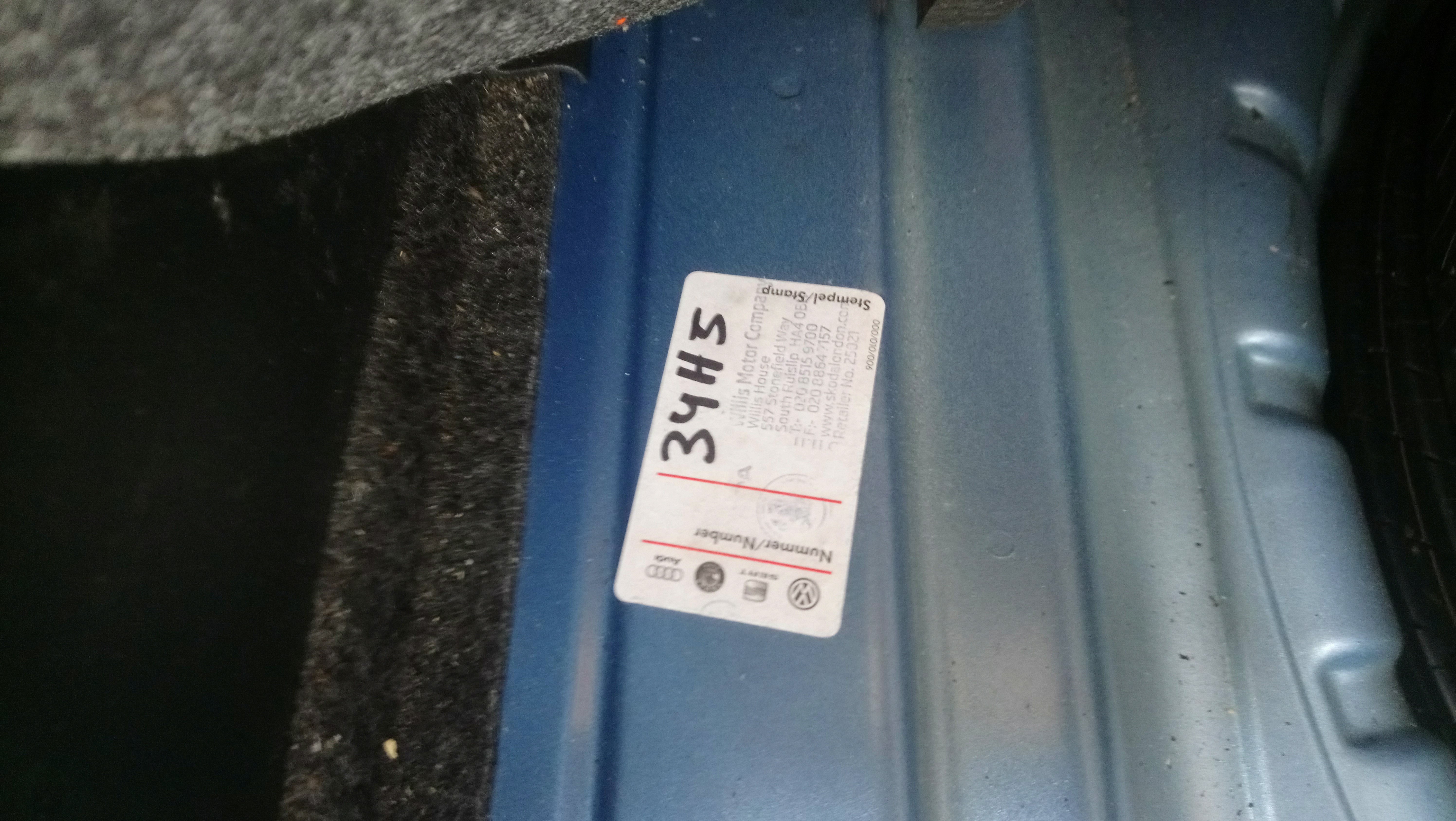

I currently have a 1.6 tdi 7 speed DSG Octavia. Can't say that I have taken a lot of notice of the rpm before shifting,but it sounds about right. Sometimes when going uphill it stays in a lower gear longer than I would prefer, so I manually upshift. The clutches on the 7 speed are dry so there is no oil changes for the clutches or the box itself. Check for a sticker on the boot floor for the software upgrade:
My Mk2 Octavia DSG box covered 85,000 miles before I traded it in and my current Mk3 is coming up to 150,000 miles.
9 minutes ago, moley said:
Welcome.
Thanks for the photo. I'll inquire with the current owner to see if he can confirm its presence. He's about 90 miles away so not exactly convenient for me to do.
