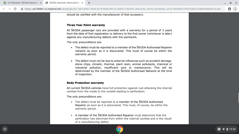

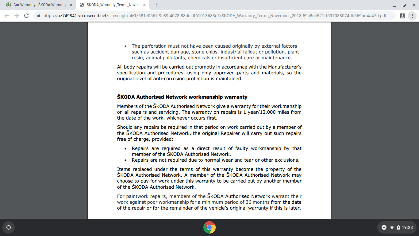

Ask Skoda UK in writing if there are Body Inspections on record during the Service History and any identified rust / corrosion during the past years and was any actions taken and warranty work carried out.
Do you know the warranty period for a 2010 model. Was it 10 years ?
