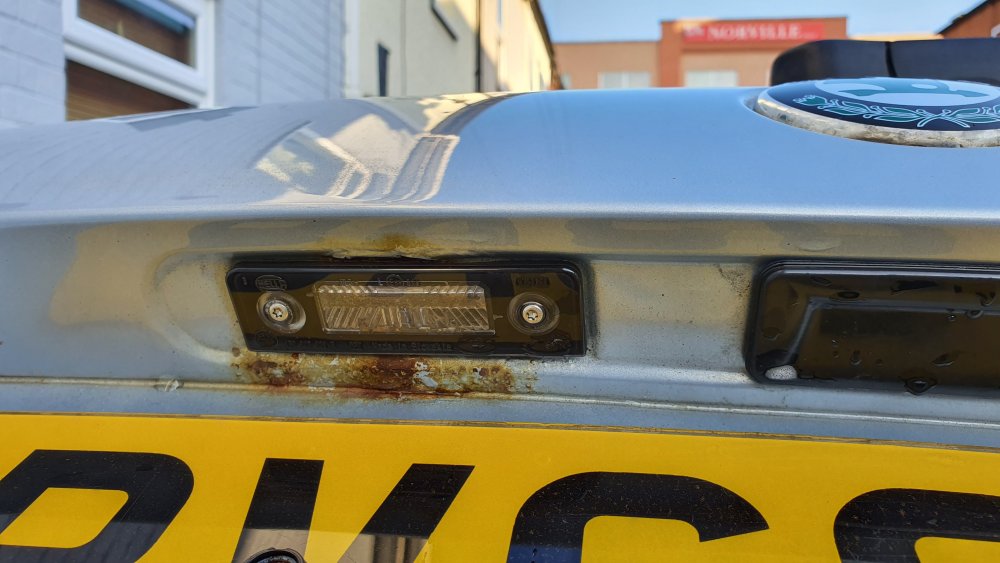

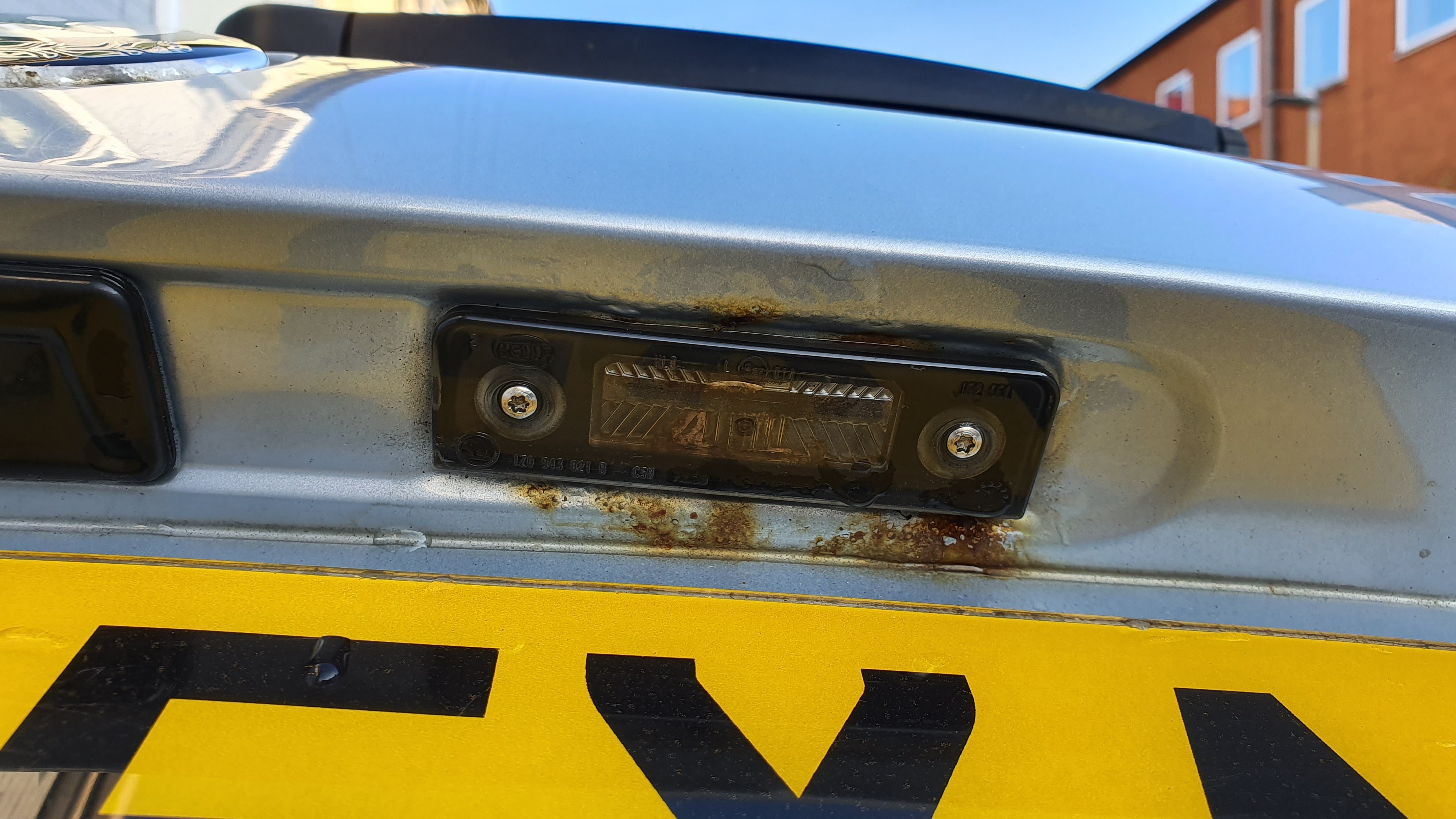

The rust is very visible around both number plate lights and electronic release but not perforations as such. Holes so they will probably wiggle out of it. Thought about removing the tailgate panel to have a look inside to see if it's there as well..
Unusual if not inside where the condensation  / H20 has been,
which is why you strip the interior trim, and treat the back of pannels with inhibitor as well and etch prime.
It is so common that it is a weekly sort of job for busy places.   There is no new issues with VW Group cars, they often go from generation of car to the next generation.
When buying cars that is why taking people familiar with that model to check with you is advised.

There won't be a Skoda approved bodyshop in this land that isn't aware of the galvanic corrosion induced by the poor design of the rear number plate lights.
Prevalent on both the MkII Octavia and MkII Superb estate.

Some photos attached. Sent a long message to Skoda customer services today. Let's see what they have to say

Yes same place as mine but I would say your corrosion is more advanced.
